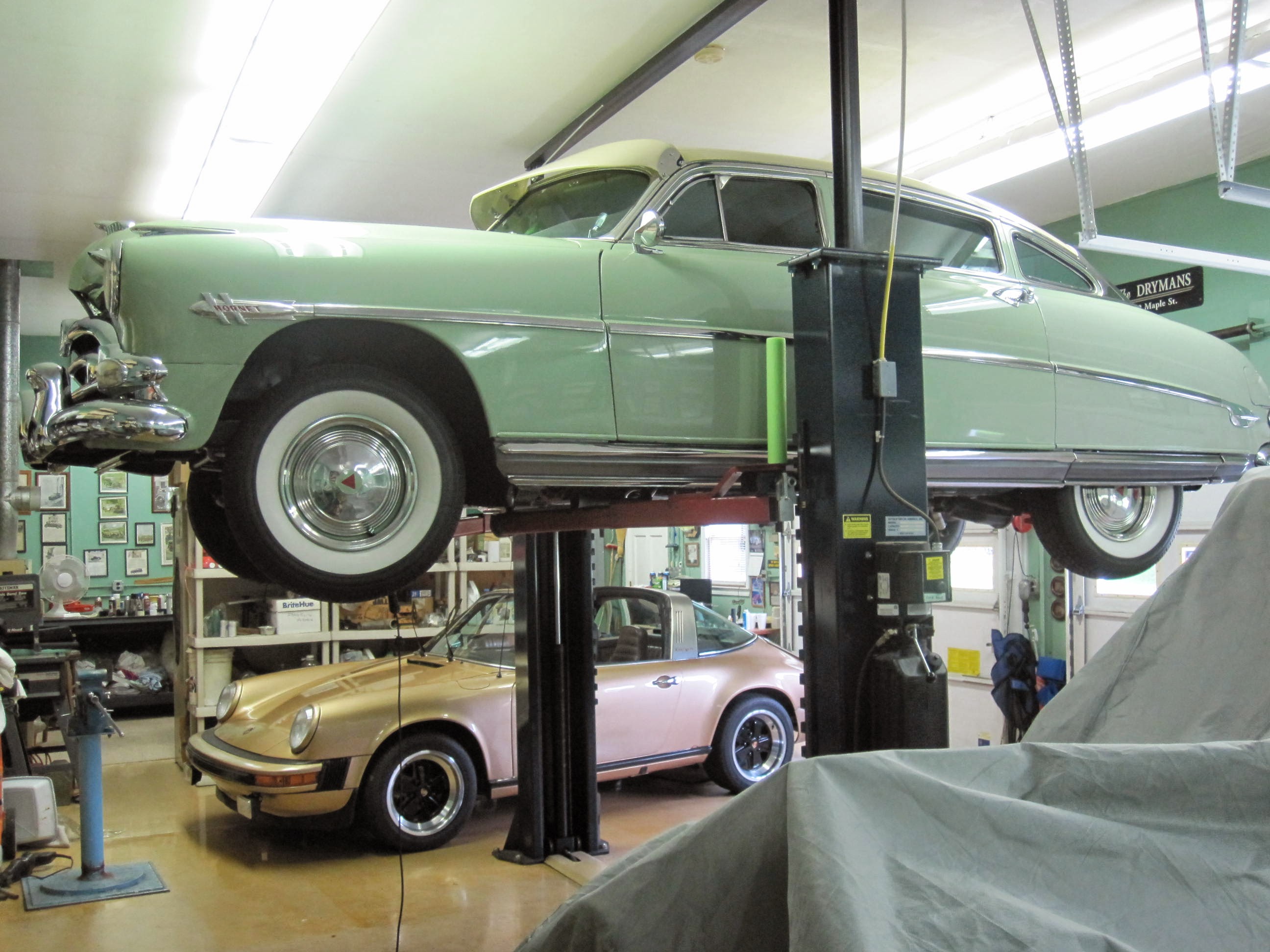

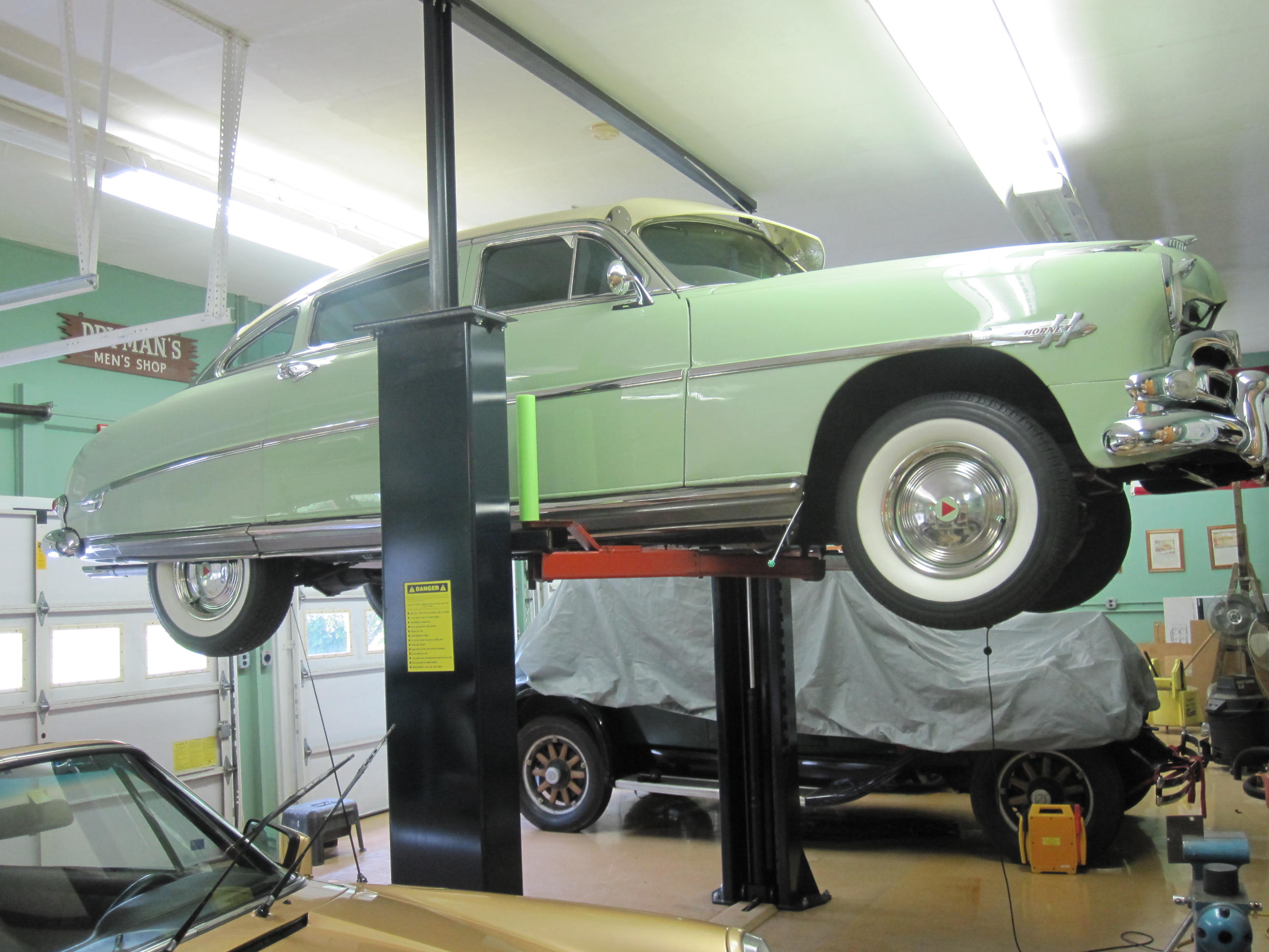

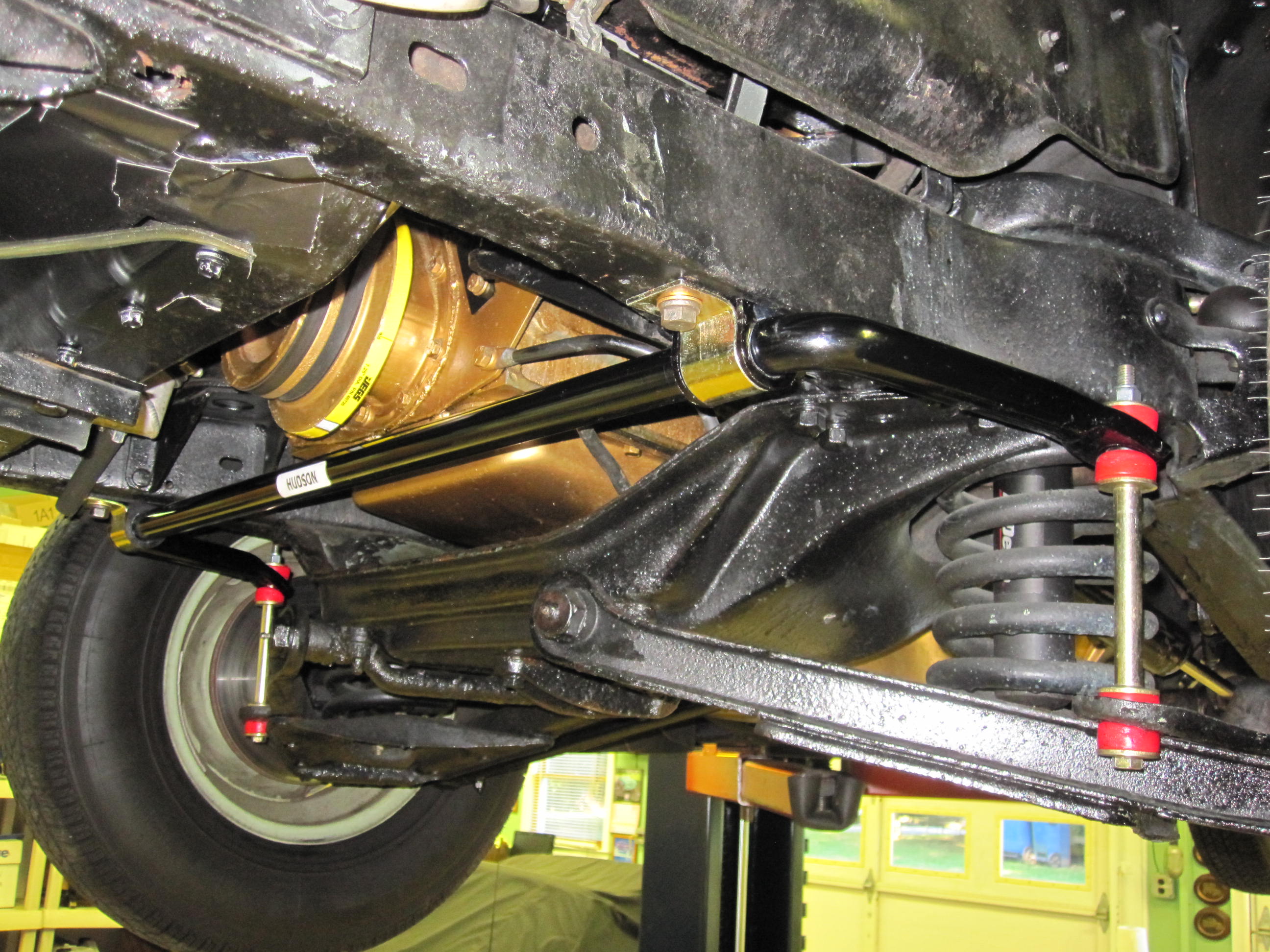

Not sure you can see exact lift points. The rear pads lift at the intersections of the rails and cross piece in front of the rear tires.
The front pads lift at the intersections also; of the side rails and cross piece almost directly under the firewall. There is a triangle piece riveted at this intersection. This should be rather clear but if not advise and I will raise the car up (it is parked at lift location) and photo each position.
my lift is 6000#; and sometimes I wonder about the reach--don't go into the space on the lift slide arms that indicate you have gone too far.0 -
I concur with Richard, I use those same lift points for my 54John0
