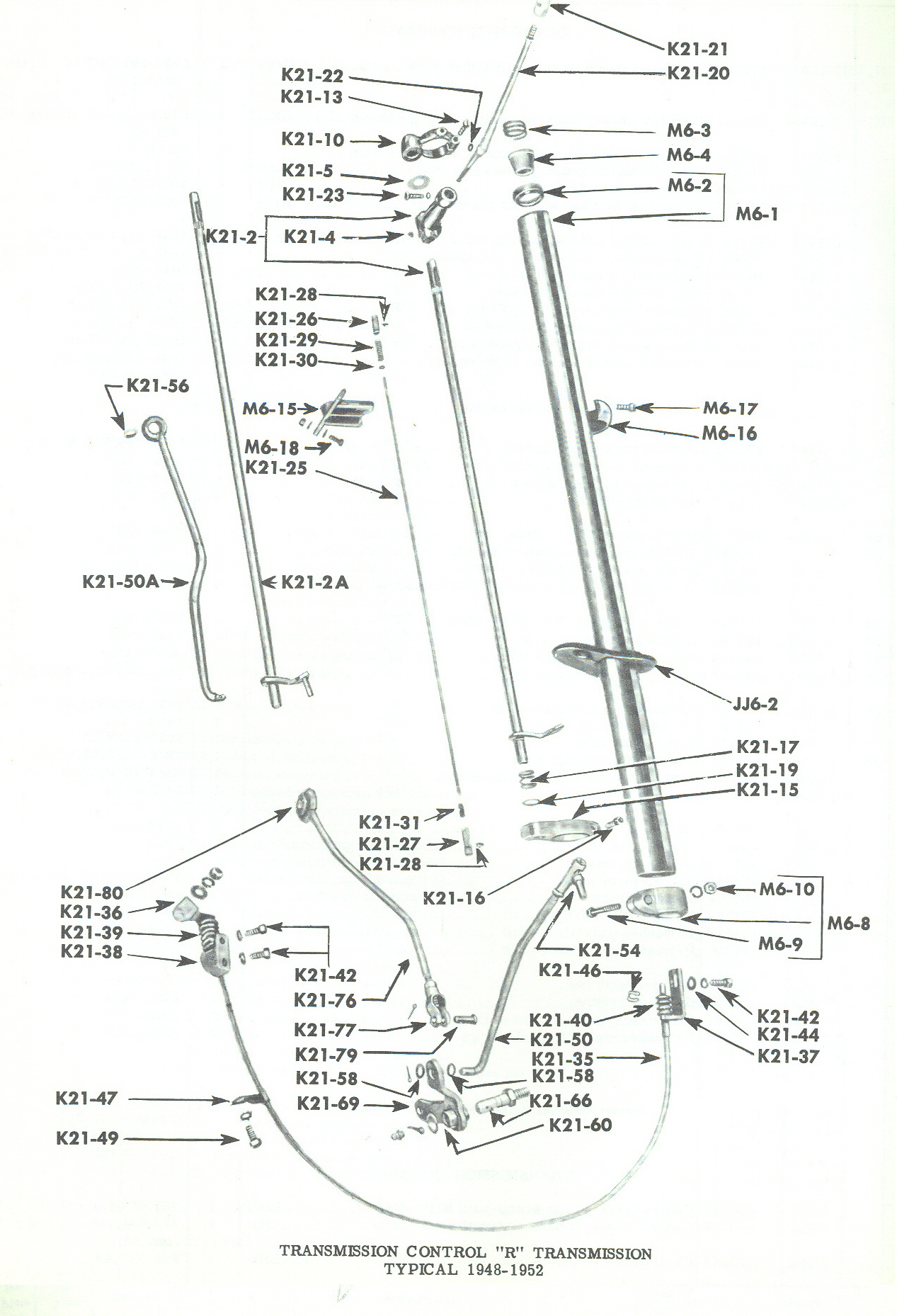

Ok, got clutch to engage nicely just about two inches off the floor. However, now I only have first and reverse, linkage will not go over to second or third. I may have messed up shift linkage alignment when I took dashboard out to paint it. Does anyone know the procedure for readjusting the shift linkage? Thanks0
It feels like it has the movement to cover the whole H pattern, but when the car is running you realize it's not moving out of the reverse/first quadrants. The car has sat a long time while all wiring was being done and upper column shifting mechanism has been unassembled......could've been reassembled incorrectly. Shop manual does not provide clear help about column/shift assembly, can anyone give me clear directions? Thanks0
When you pull the shift linkage up, it pushes a cable to shift the tranny to the low/rev position. There is an adjustment on the end of the steering column.
It seems my problem is when I push the linkage down I'm not getting into second and third I vaguely remember having difficulty getting the shift handle all the way into the bracket that holds it against the column. Was there a particular way I should have inserted it so it would align with whatever there is inside that helps it pull and push to get all the gears?0
