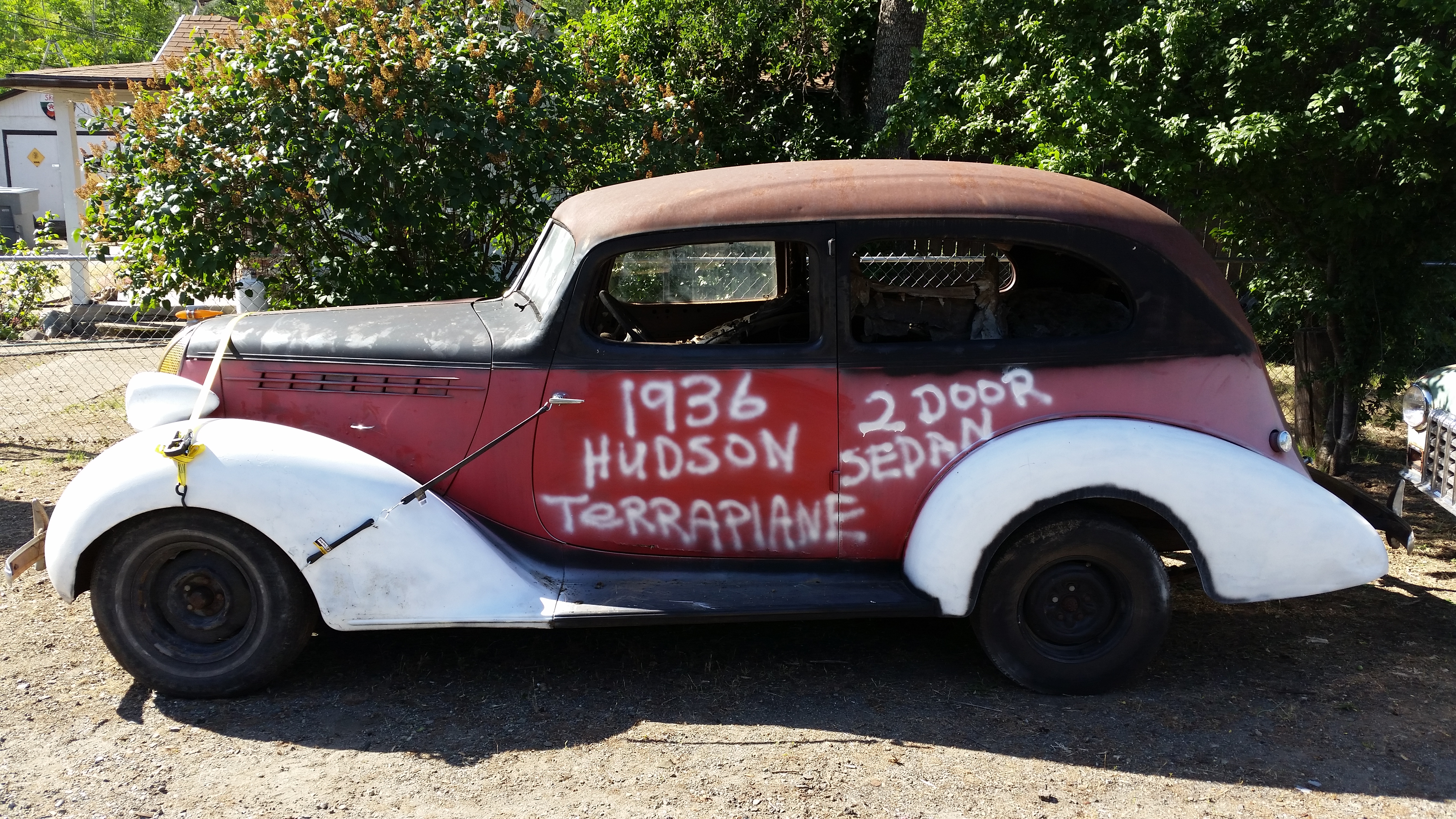

Got it Jon, I'm hoping because this guy parked it in the 50's that the bearings are good. No one knew why he parked it when we redid the babbitting it wasn't to bad couple had some knicks but I wanted this to be an engine that I only did once and not have to keep pulling it apart. I did get the new fiber cam gear it wasn't cheap at all. I can imagine what a parts store would charge seems everyone I talk to about different things on it like upholstery, babbiting, and the rest all they know is the number $3000 lol. Thanks for the helpful tips I'll make sure to take it easy on this I have learned for making so many of these they are hard to find parts for. I sent an email to NADA price guide told them they need to re-evaluate the prices for these cars I asked them if they ever saw any come up for auction at these sales like Mecum or Barrett Jackson? Seems that no one really knows for sure how many of these cars are still out there and how many got turned into the war effort in the 40's. I have the 2 door (Suicide Door) series 61 Brougham nice car but a lot of work. Here's what I started with. Putting it back to original condition.
