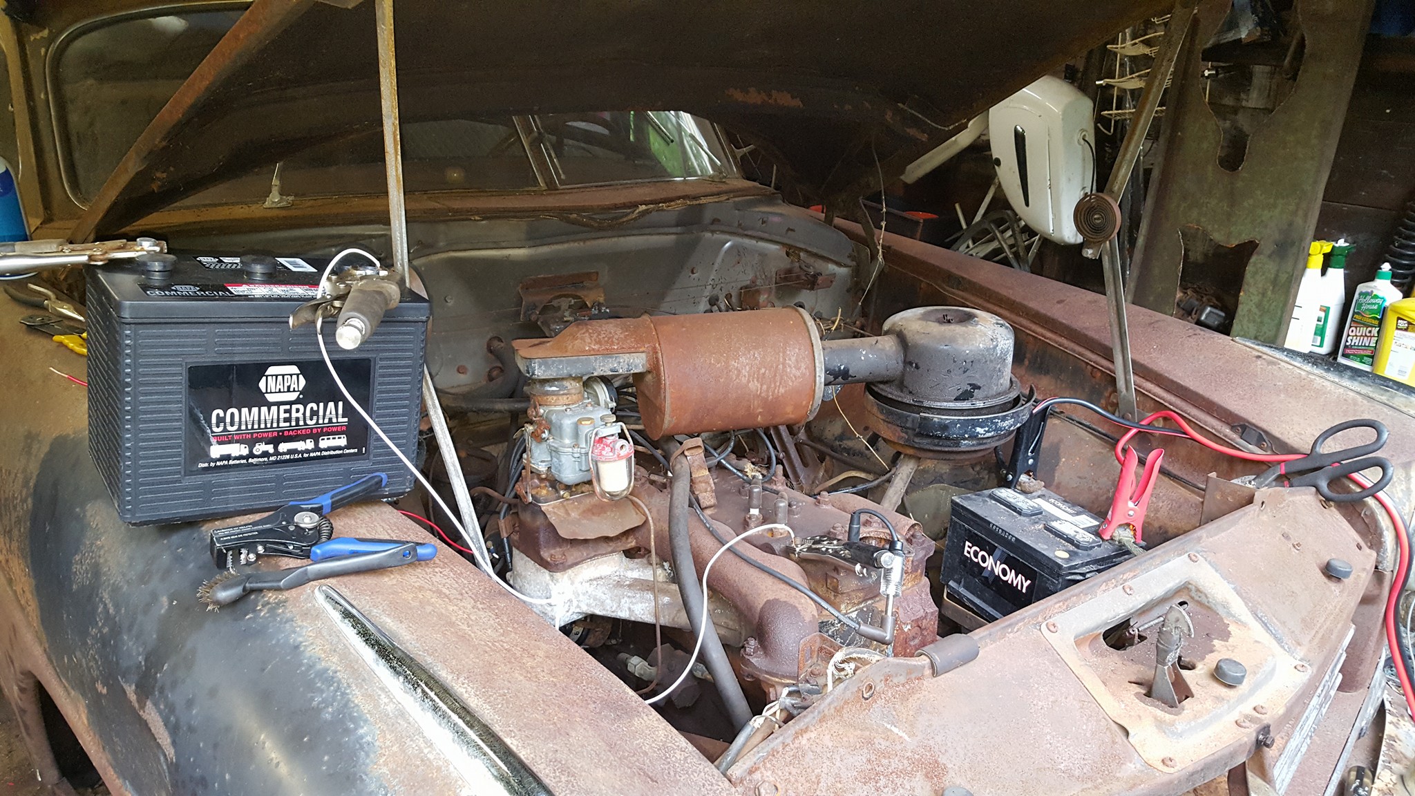

well my friend Derek came up and we had a whole assortment of wires and batteries and cars going to try and get the engine running. Didn't quite get it but def got close (we think).
Filled the dipper tray and oil pan
Bought a new 6v battery (only showed 5.8 when tested tho).
Pulled the plugs and spun the engine slowly by hand. There were a couple spots where it felt a little tight but as we continued to slowly turn it they freed up. It spins very smoothly by hand with nothing erratic or any random noises or harshness.
Hooked up the 6v batt to the starter and a jumper wire to the soenoid - and nada. Solenoid is dead.
Bypassed the solenoid by going direct from bat to starter. 6v would not free the starter from the ring gear. So tried an older 12v bat that sowed 9v when tested. Stlll nada. Decided to jump the 12v battery with my truck battery and that was enough to spin the starter free and we could watch the starter engage/disengage.
Next we added a little oil in the plug holes and cleaned all the plugs and reinstalled after marking them all.
Wired the ignition to the 6v battery and gave her a whirl. ALMOST got her to run! It bucked a couple times and we were getting spark (tho it seemed faint) so seemed to be a gas issue. Poured a little gas in the carb top (the bowl was filled with fresh gas and we filled it manually so the old lines etc were skipped). Same thing. Close but no cigar. With my hand over the carb I didn't feel any suction at all.
Decided to check the cap and I think that's where we caused an issue because after this we weren't getting any spark. Tried it and now the carb was pulling some vacuum (with my hand over the carb i could feel the suction) but no spark.
So this weekend the 6v battery is on the charger and I'll be getting some more proper means to try and fire it and a new set of lead wires for the distrib.
Anyone think I'm on the right path or have any suggestions?
Of course I just realized the previous owner sent the generator out to be converted to 12v so now I i have to convert the coil, etc etc correct? I do have a 12v wiring kit, I just need to make sur I get the right ignition parts,.

My guess: Those "tight spots" when turning by hand were the stuck valves being pushed open by the cam. If they're that stiff, they won't be closed by valve spring pressure, hence the "no suction" at the carb and no compression, which equals "no run".

Frank you are spot on... Much of my experience with Hudson engines that have sat for a few years includes stuck valves. Thanks for posting0
coil has power, to both sideswe bypassed all factory wiring just to see if it would turn over. One thing is we had spark before mucking with the distib and am wondering if we shorted the old cloth lead wires. thats a simple fix so going to try that this weekend along with all the simple basics. from there if i have to inspect the valves we will. i appreciate all the advice, 1 step at a time.0

im guessing stuck valve - not end of world and can be freed up fine.Is it catching at all? like a single chug or two?As for suddenly no spark. points ok, condenser? rotor? no condensation in cap?Your leads look to be in better nick than what have.If its first time trying to start for some time i would take off that old air cleaner. pop some needle nose pliers or something down the carb to hold open the chock so it breaths.Advance the distributor a lil bit to help it catch.squirt a lil engine starter in the carb.try turning over.i found when bringing mine back to life after sitting for 47years i had to hold the accelerator linkage just slightly to give it a lil gas.You haven't fiddled with the carbs fuel screws or anything?What you doing for cooling? just looking at your pic and see its looking a barren there.Take a vid for us man.Alex0
