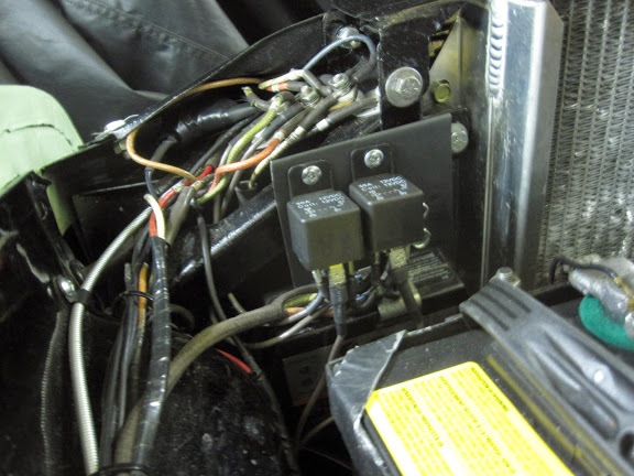

I run 100W Halogen's with H&L relays and + directly from battery. Control current from dimmer. Another positive for 12V.
Relays shown: click below.
