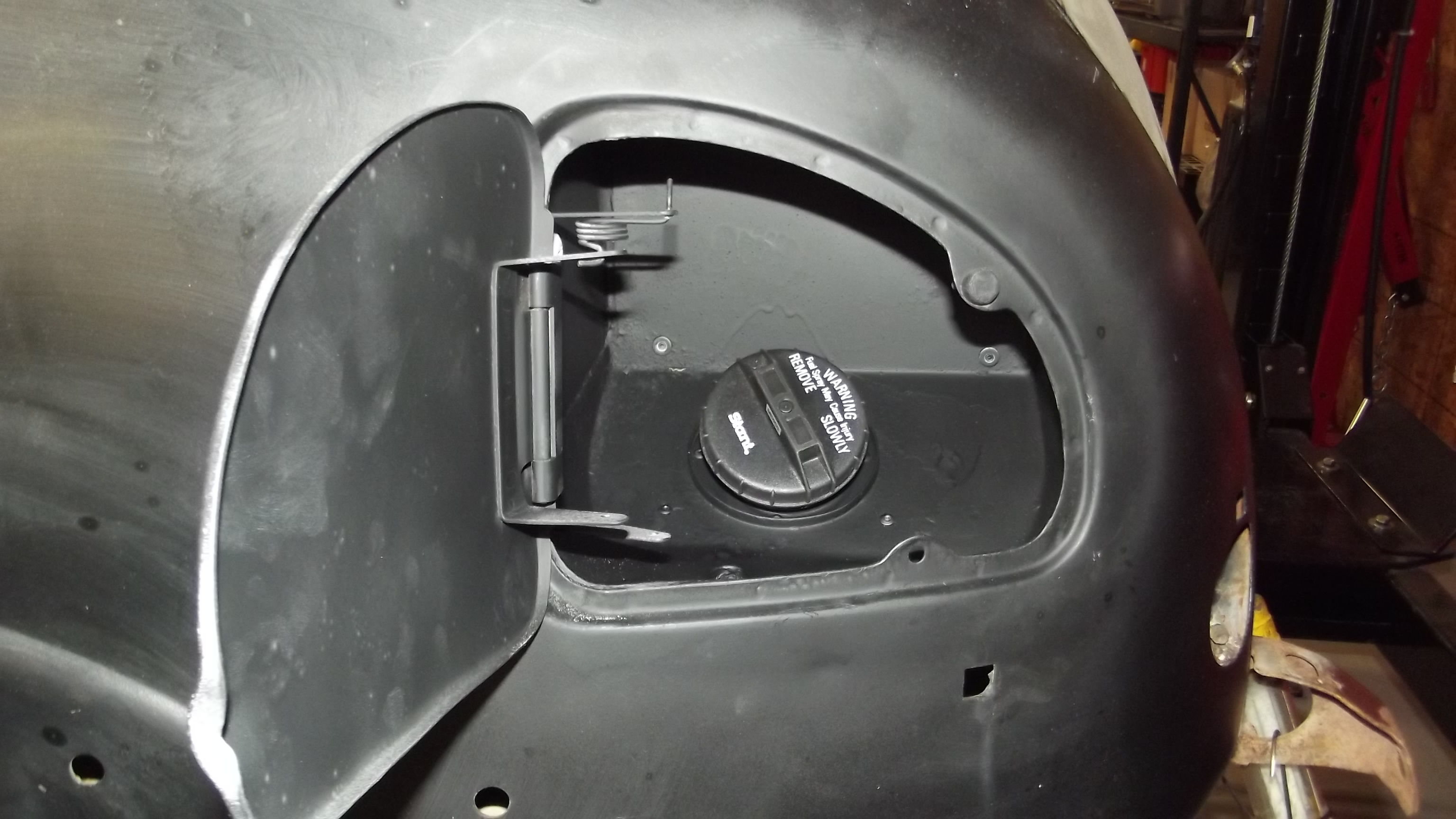

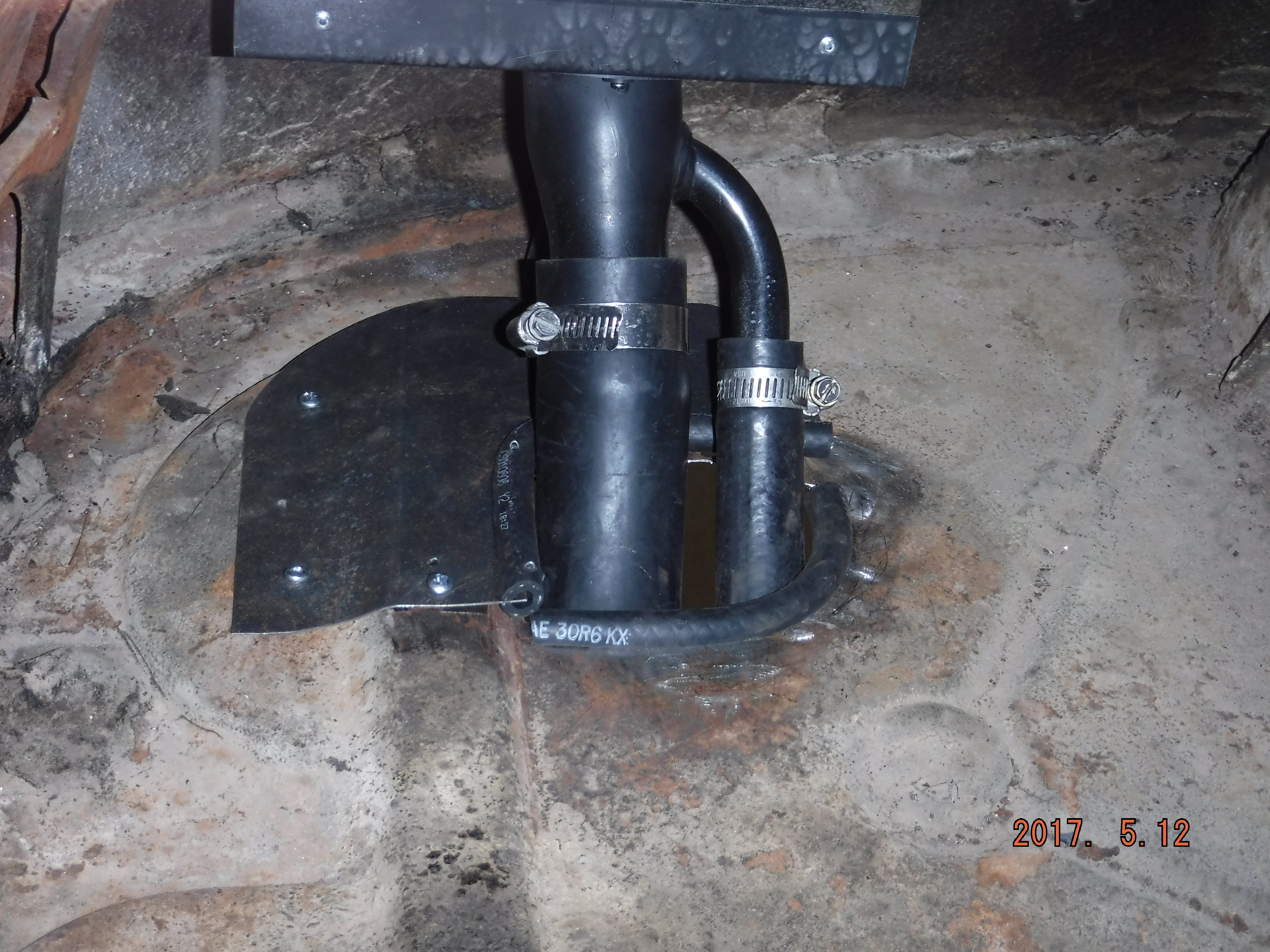

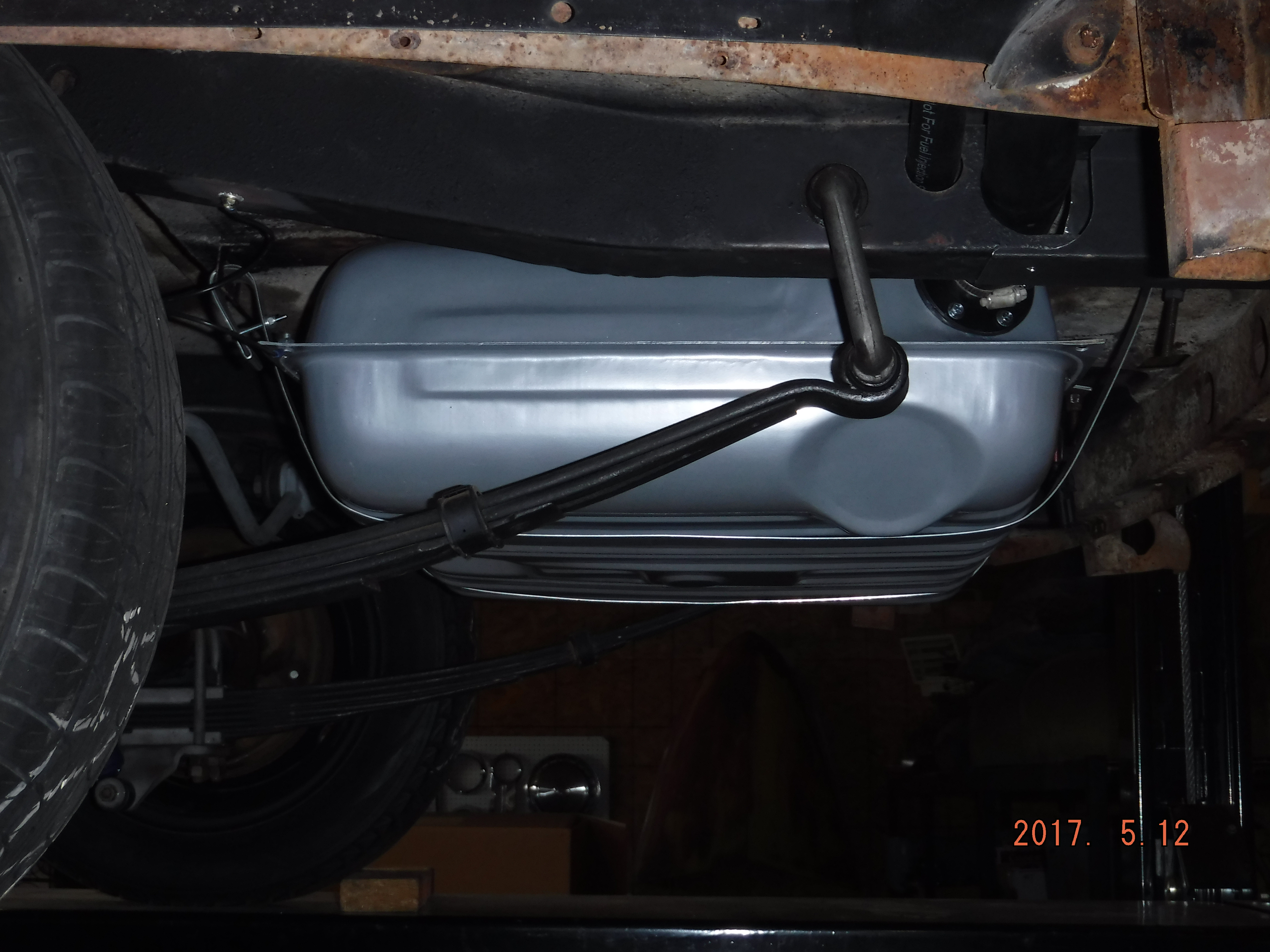

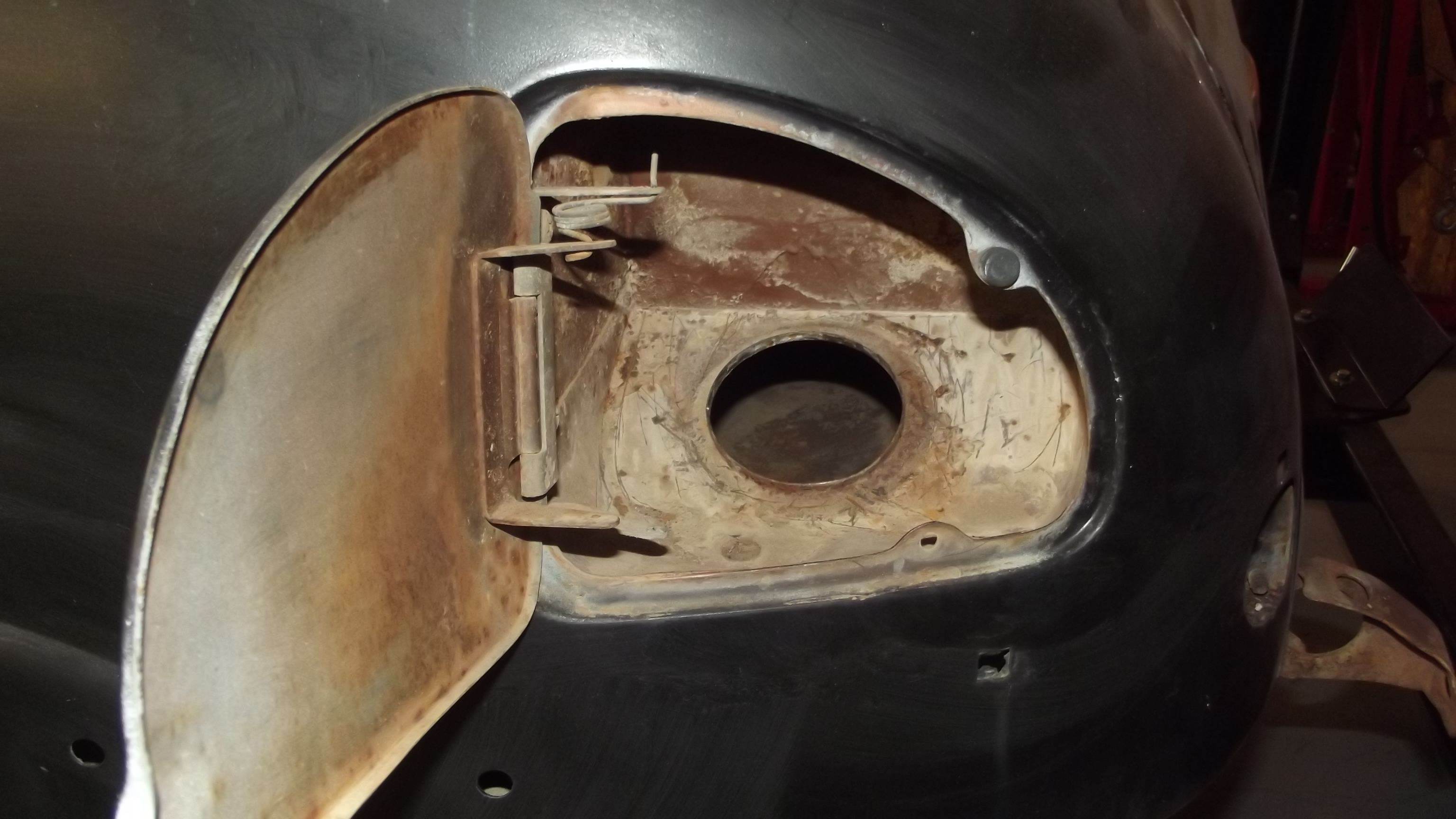

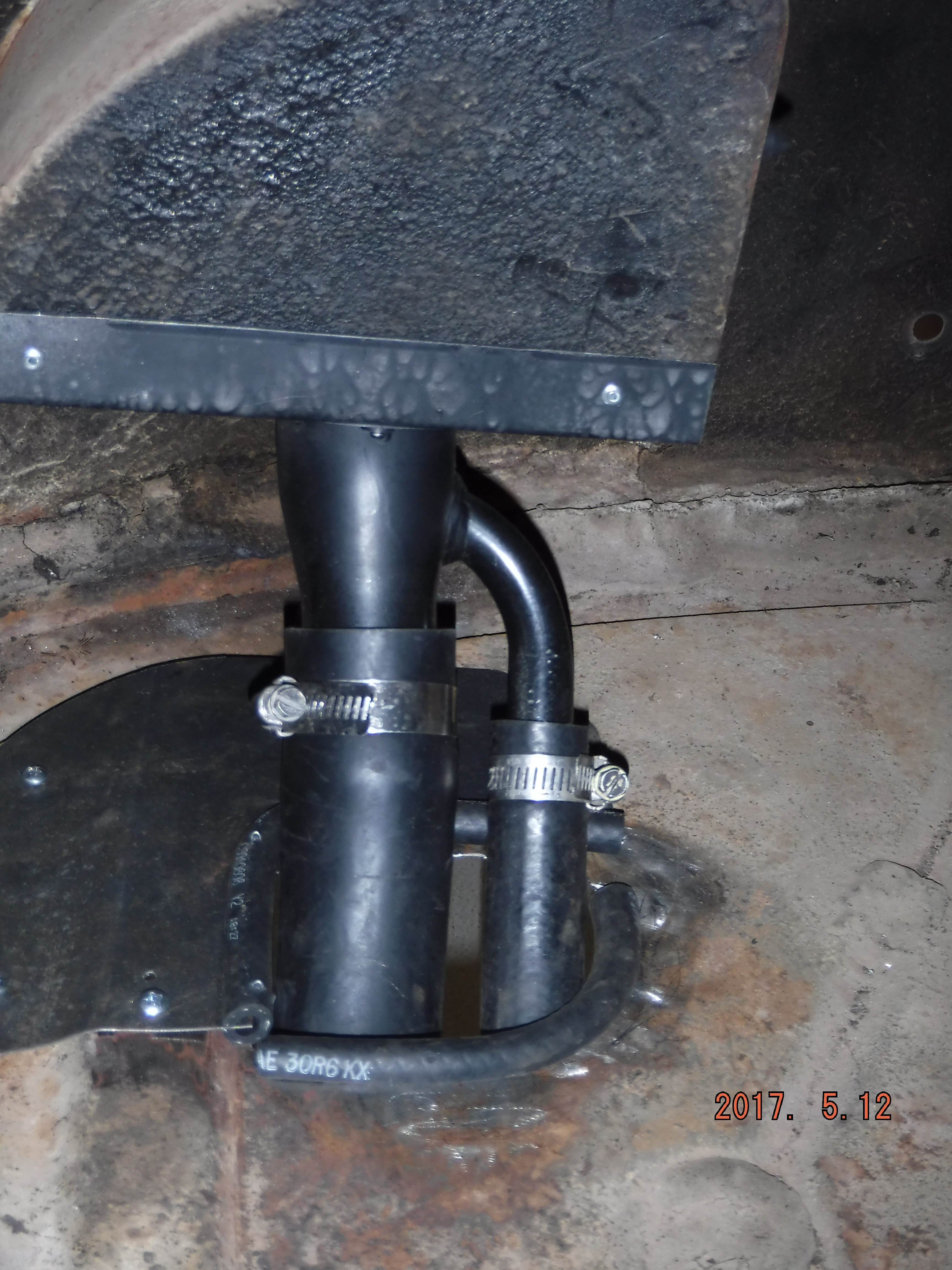

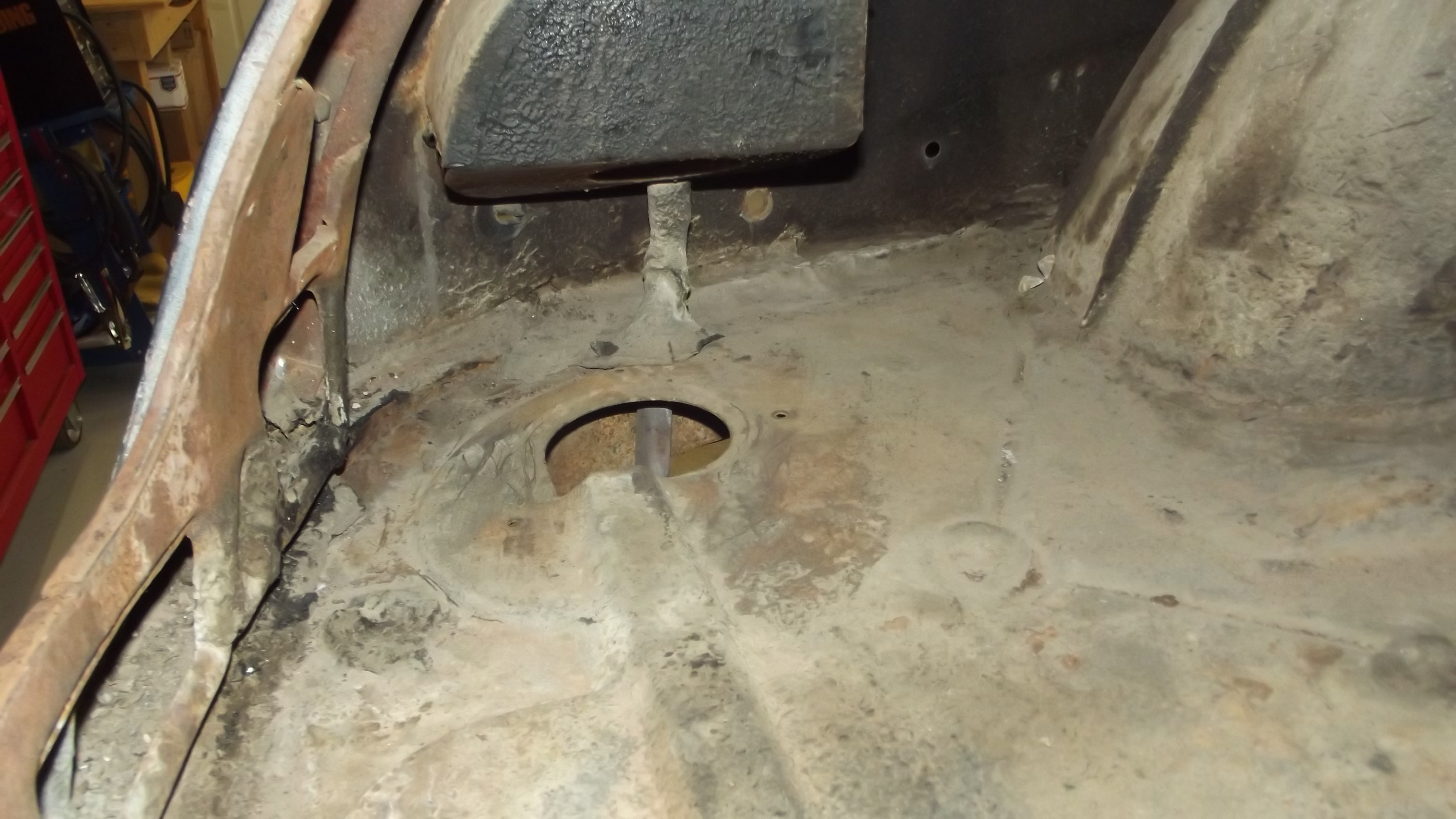

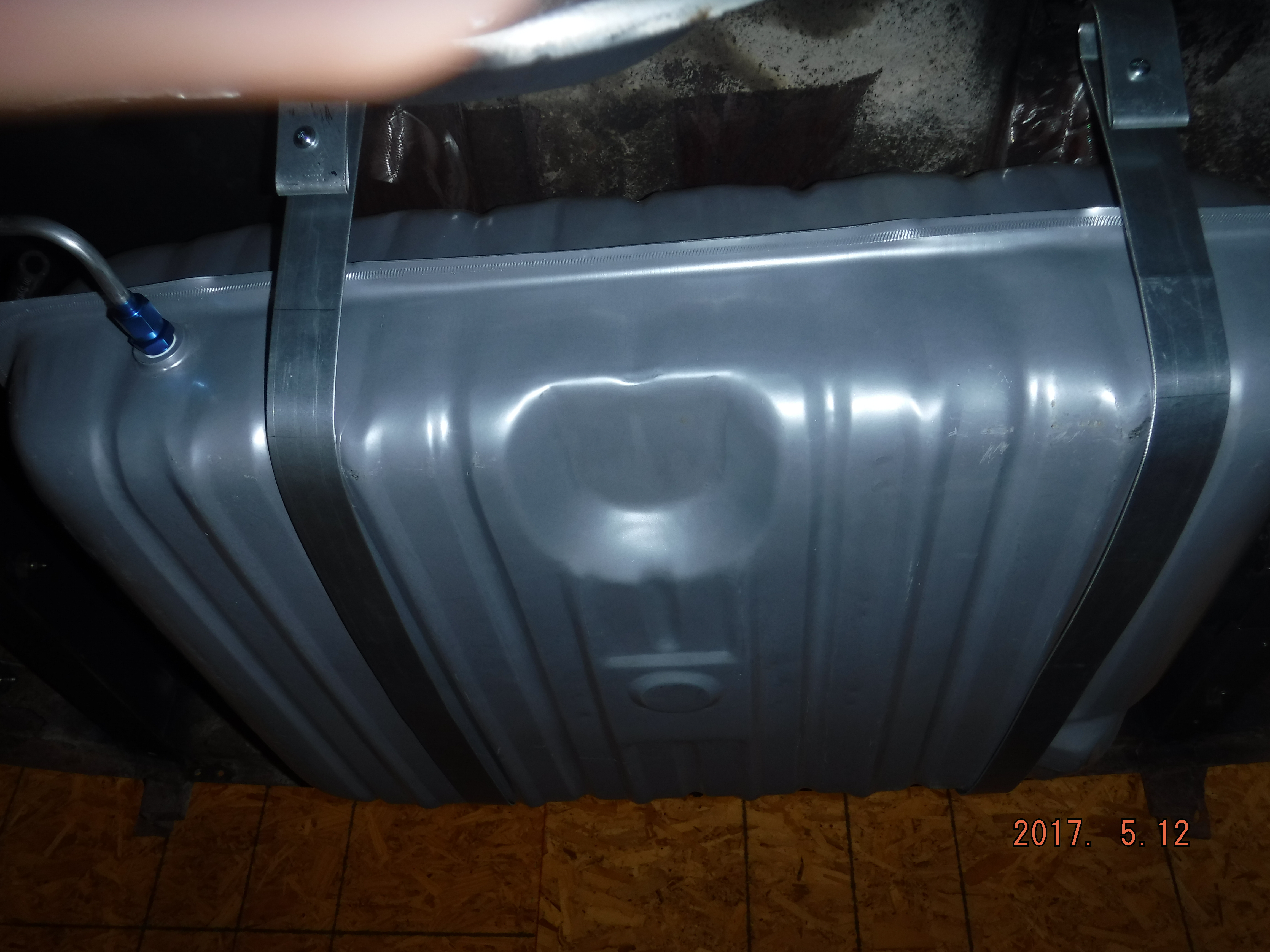

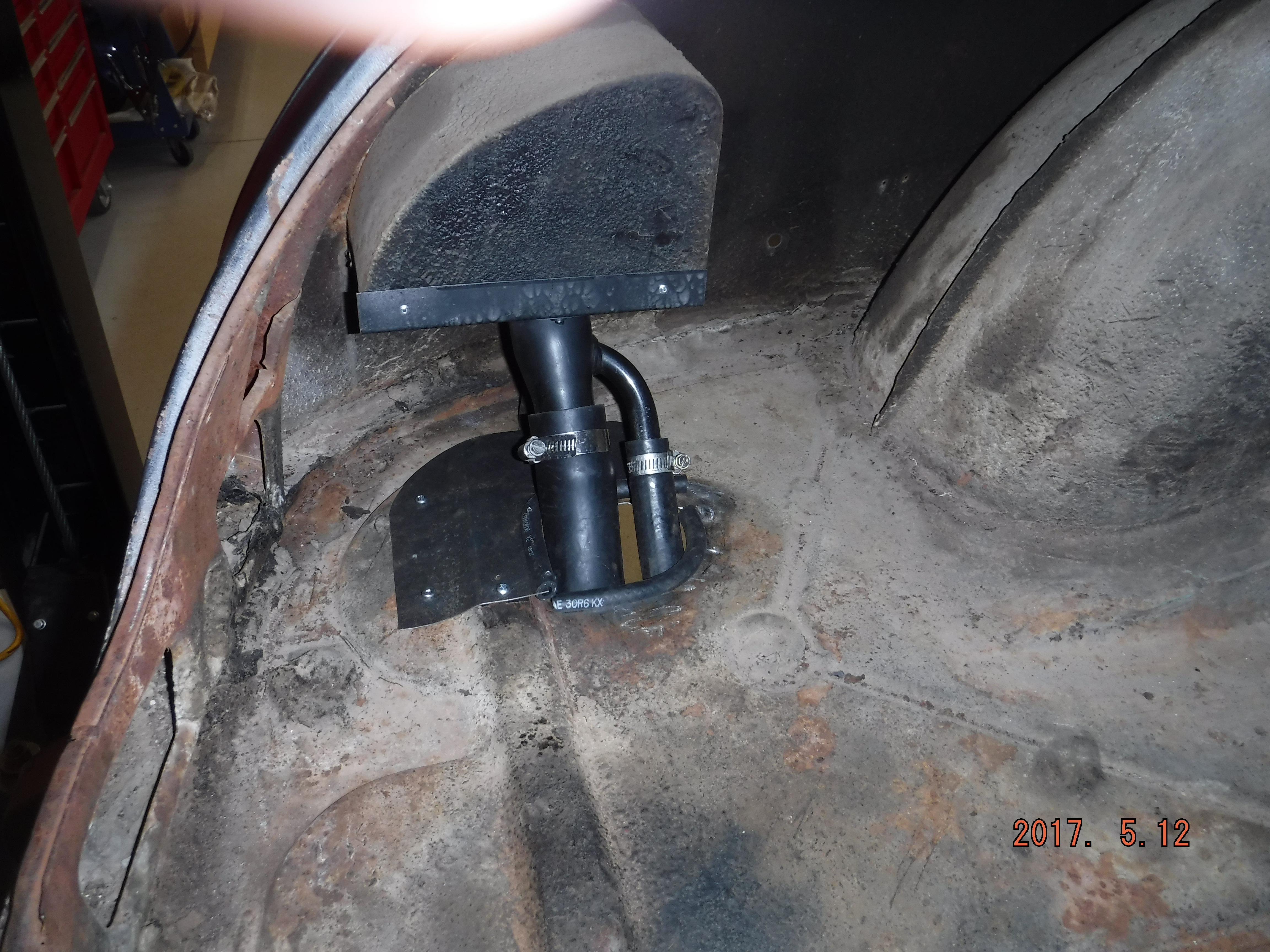

Thanks to all of your ideas regarding the replacement /upgrade of the stock tank in my Hornet I decided to go with a modified Tanks Inc unit. I started with a 1949-52 Chevy tank (51-CG). This tank can be used with either an internal or external fuel pump and can be used with both fuel injection or normally aspirated engines. I still need to build a box around the pass-thru in the trunk.
Modifications:

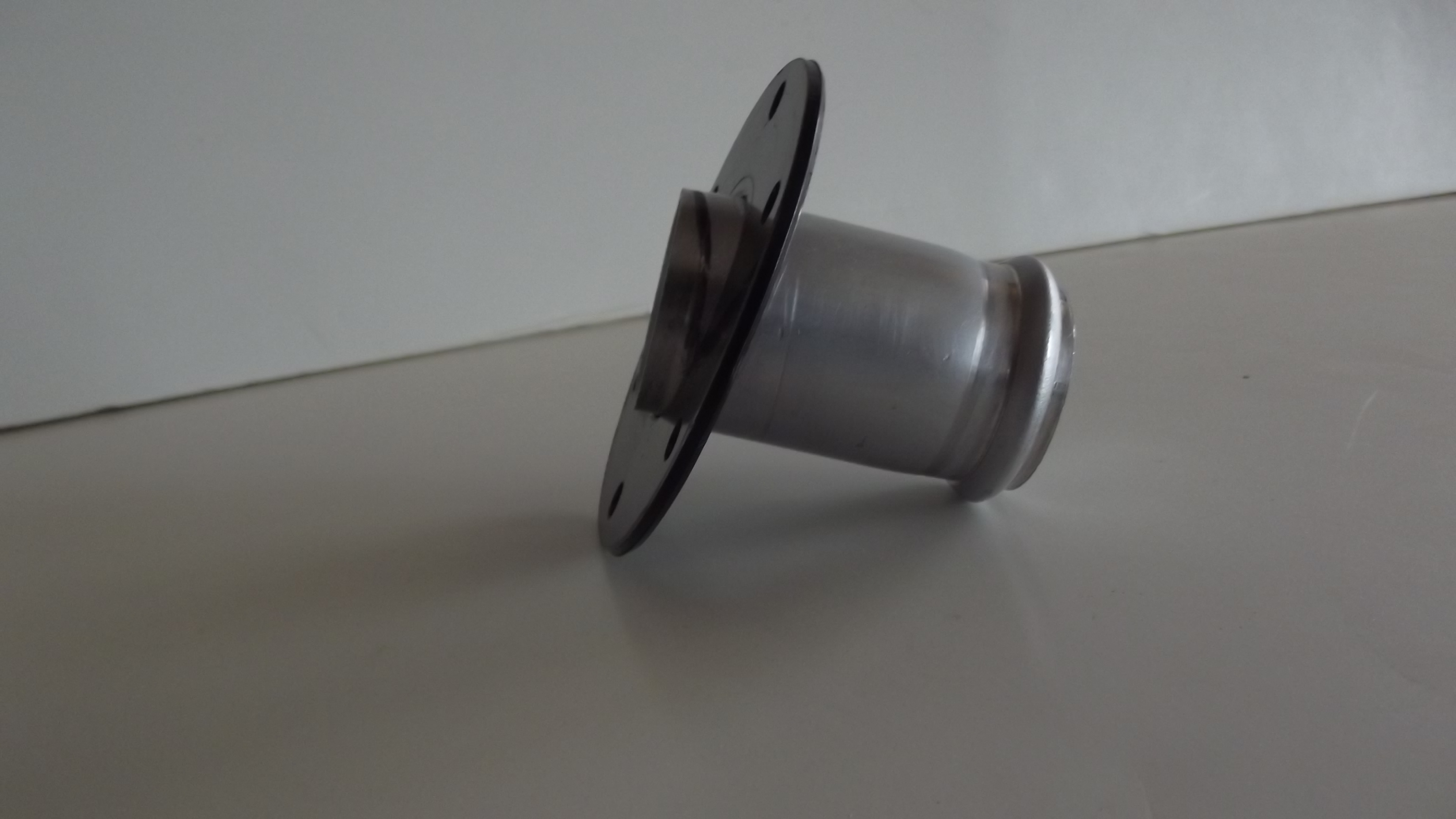

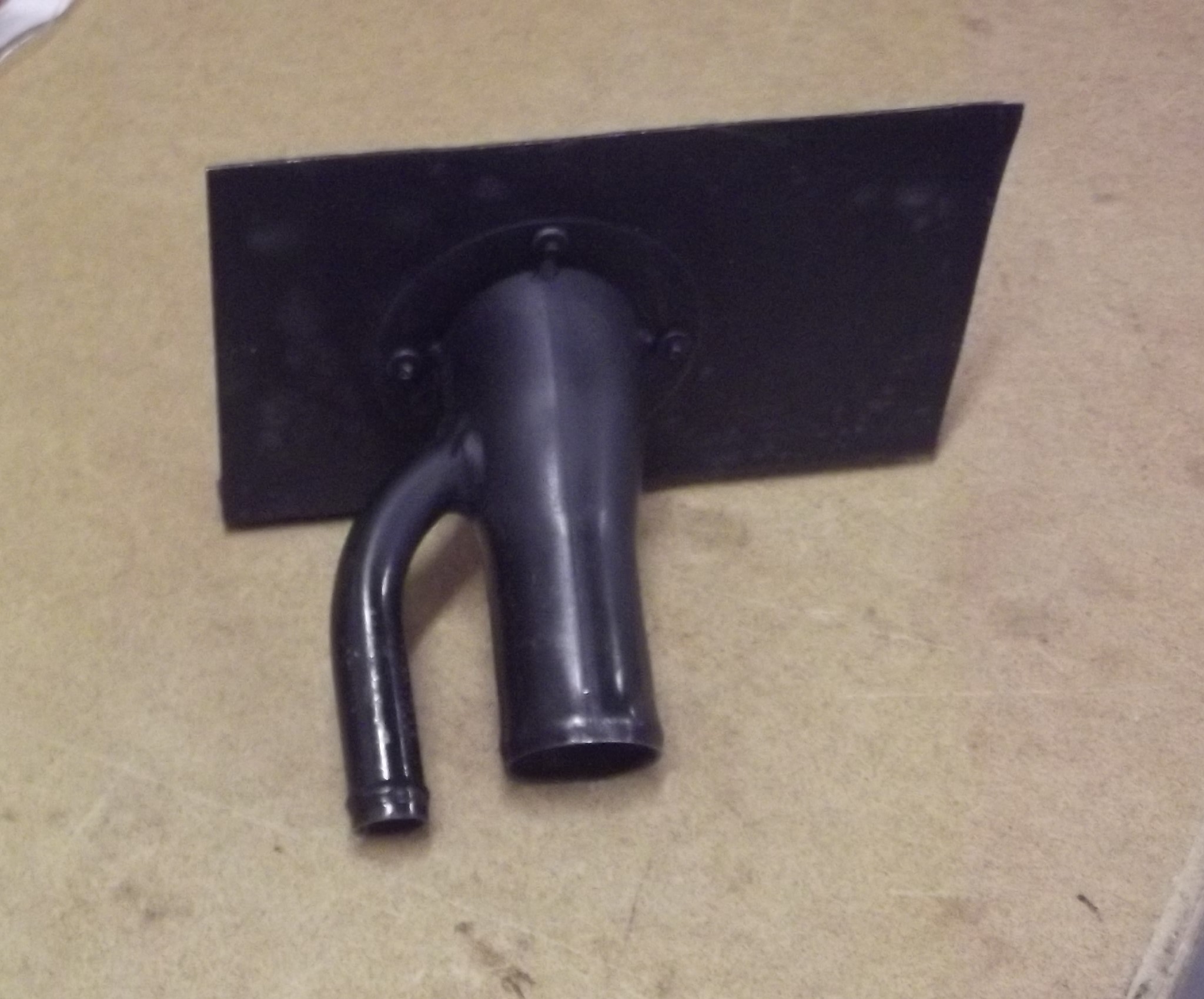

1. I did need to modify the 1-1/2” Fuel intake flange to adjust the 20 degree tank offset back to 90 degrees. (see attached photo)
2. I used a 25 deg 1-1/2” Fuel fill neck (part # Ch001GA25) from Filler Neck Supply Co. I attached this from the underside of the filler neck enclosure using steel pop-rivets. (See attached photo)

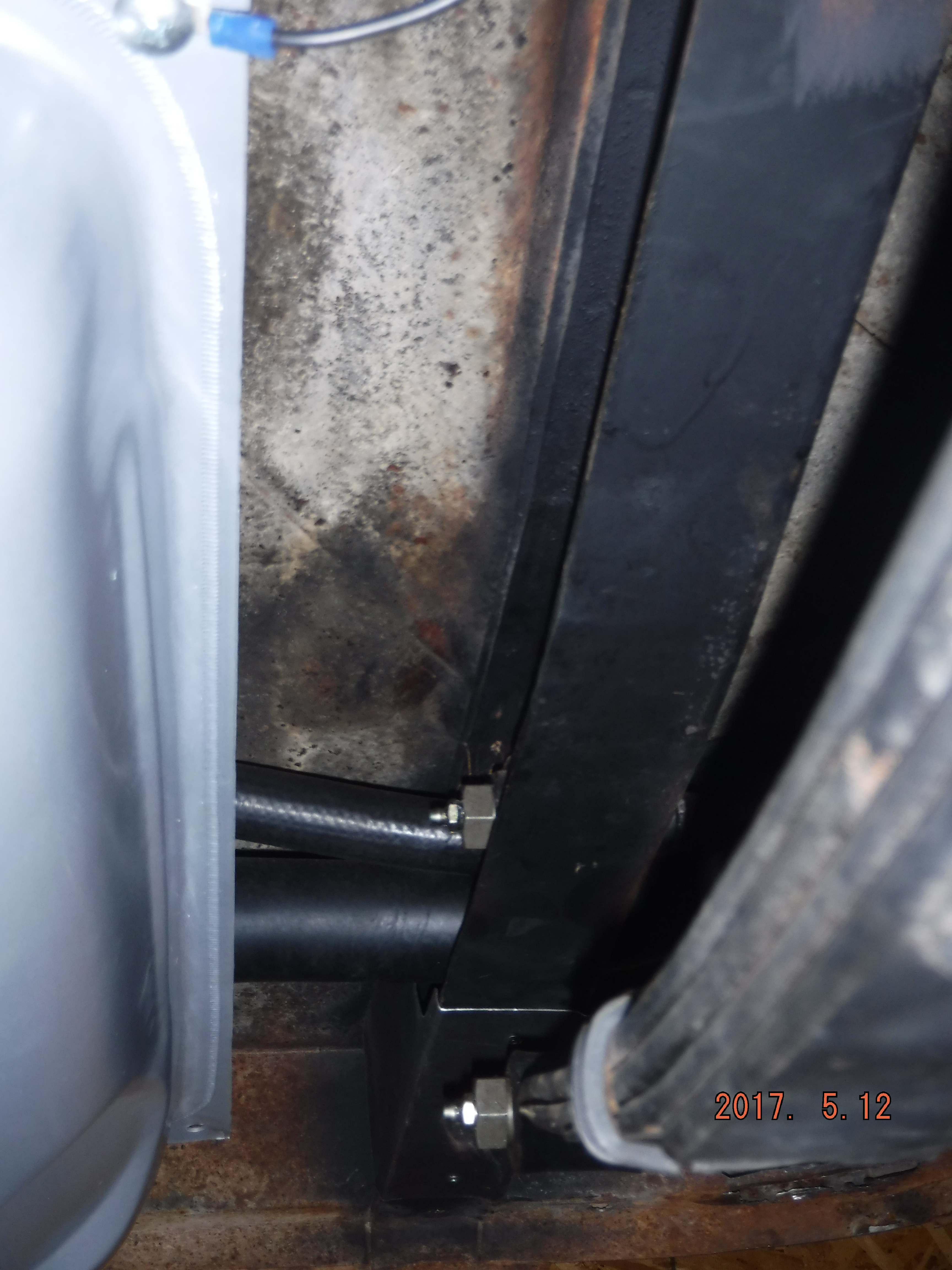

3. The stock tank straps were replaced with those from Tanks Inc. However I did need to relocate the passenger side strap to better fit the tank.

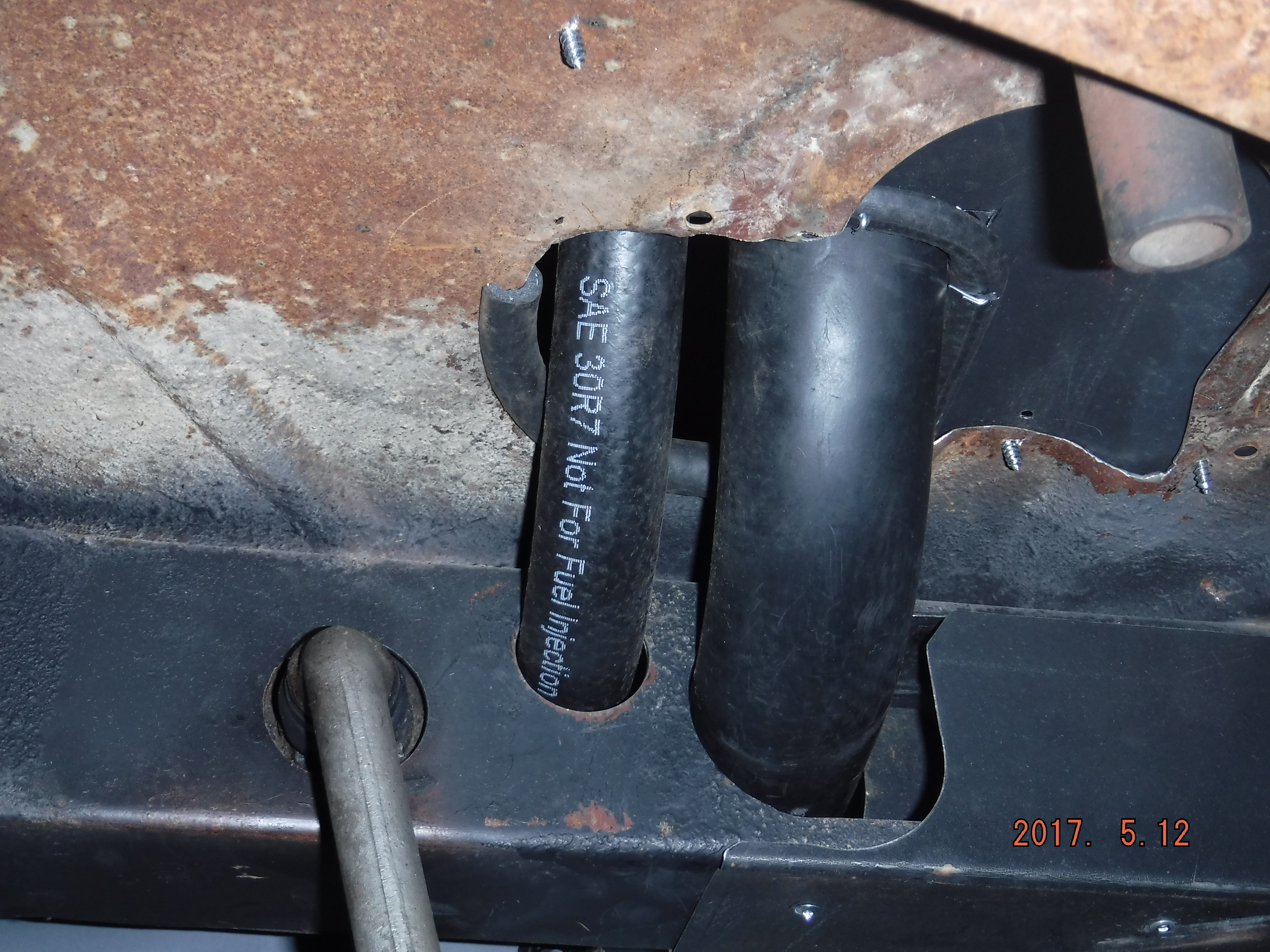

4. I drilled two holes in the frame to allow access to the tank from the fill neck hose and vent.
