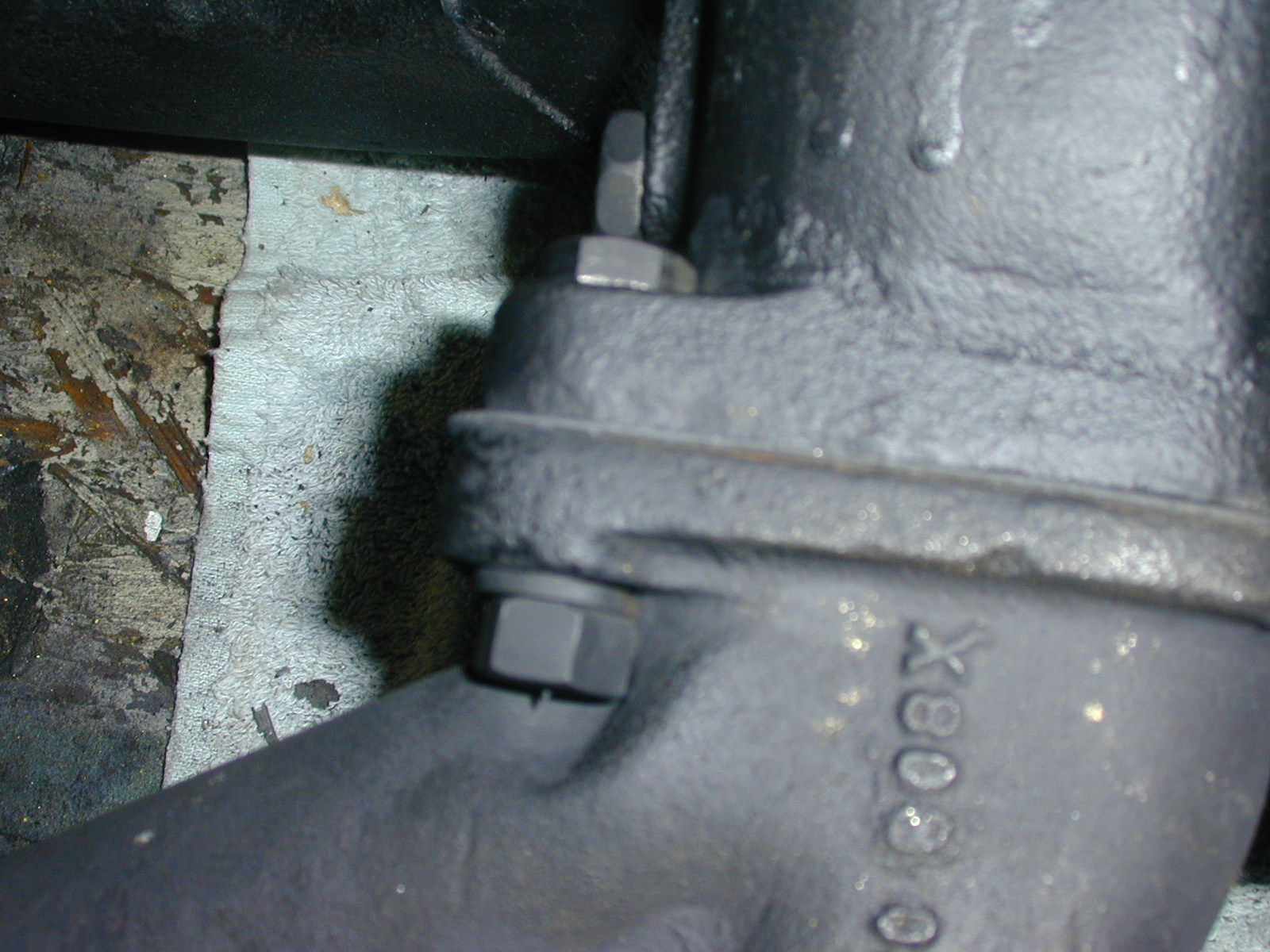

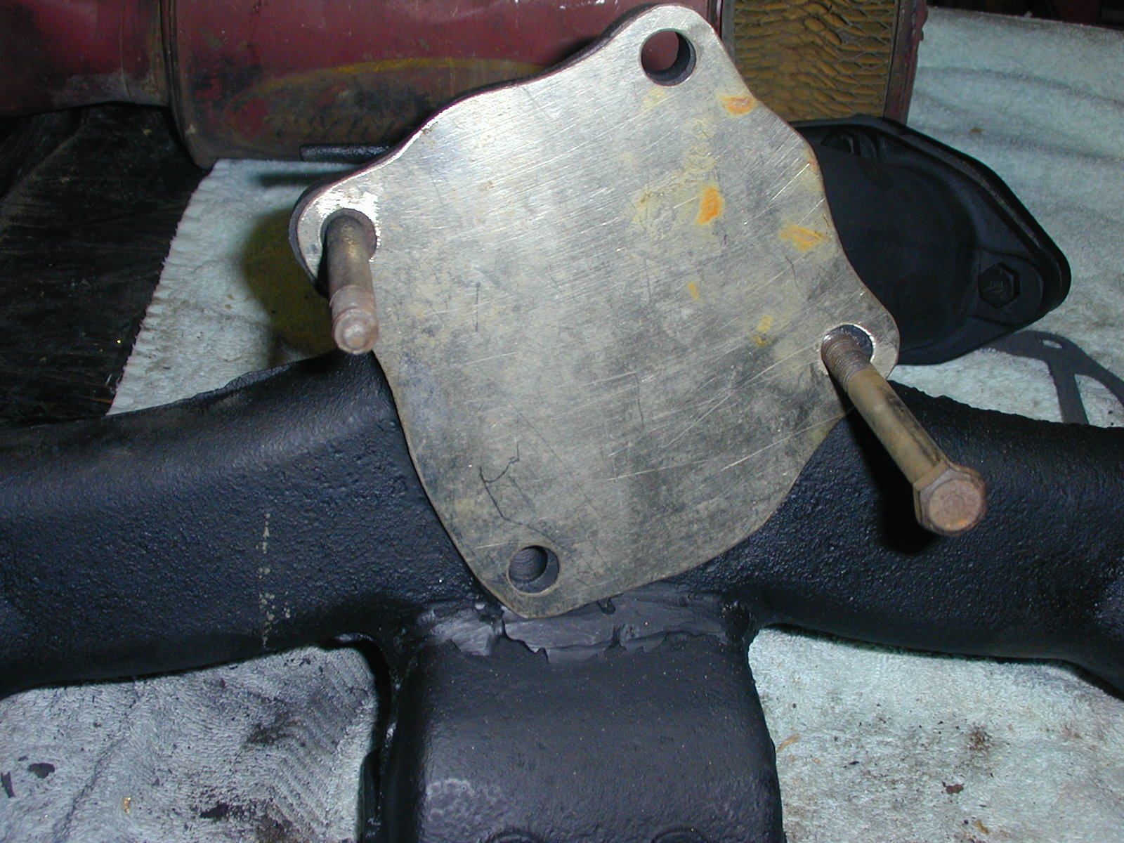

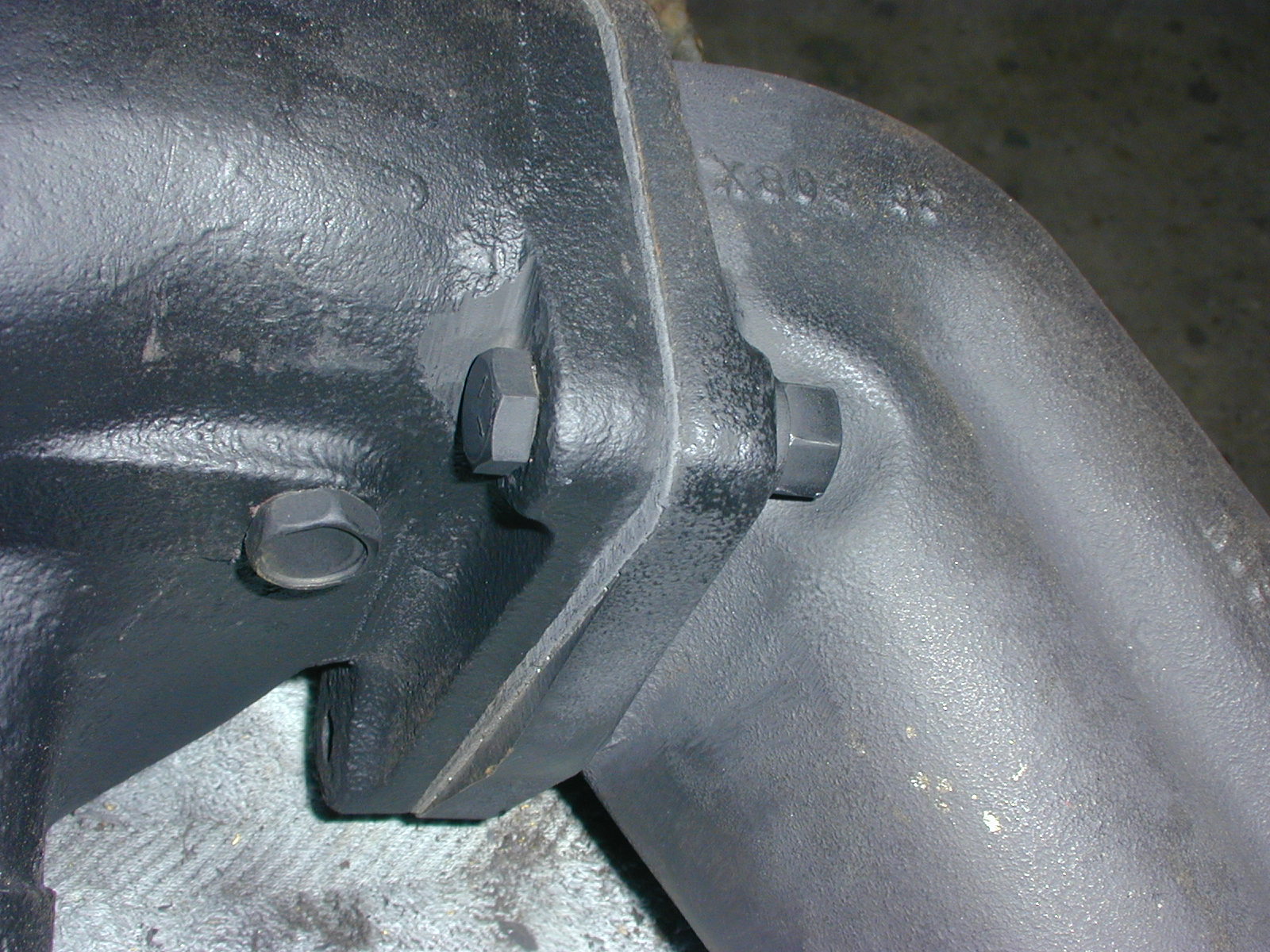

Got mine from Bob. Already did trial fit to a Twin H exhaust manifold. Will post pictures later today. Now I need the matching intake.0
I had to replace one stud with a bolt due to the lack of room to start a nut on the stud with the adapter in place. just drilled the threads out of the original manifold and dropped a bolt in. I also made a stainless shield to keep the exhaust out of the intake. I also removed the heat riser flapper and filled the holes with a couple short bolts. Adapter flange is at the welding shop. I decided to let the pro do the welding. I am going to use 1 7/8 exhaust pipe. It's only a 262 so I don't think dropping 1/8 ' is going to make any significant difference. I am going for the "sound" not performance. Maybe snakeing 1 7/8 pipe through the cross members will be a little easier than 2". Any suggestions on muffler choices? It's a '49 so has more room next to the fuel tank than the 51 and newer.0
