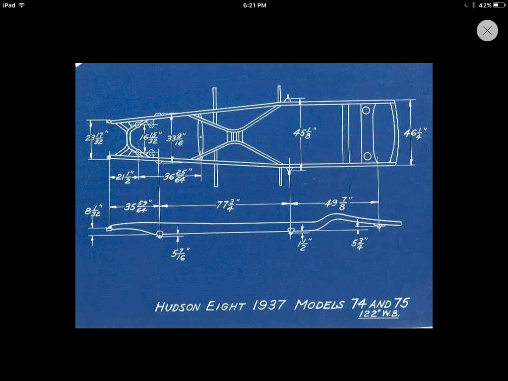

Thanks Jerry - I found the attached dimensions of my '37 frame and it lists the mounting point spacing at 16 15/32" but my '50 262 plate holes are just about 20" c-to-c. Maybe I'm missing something on my frame that provides for the additional distance?
It looks like there are two mounting locations on that drawing -- one for the eight, and one for the six-cylinder engine.
If so, maybe you could consider a Jet engine (if indeed you could find one), because I've been told that a Jet will fit very nicely into a late thirties Terraplane or "112". If indeed the Jet engine has the same footprint and mounting hole location as the 212cid six that originally went into the '37 Hudson Six and Terraplane, it might be a prime candidate. (Of course, that presupposes that your frame has a second pair of mounting brackets already in place).
Here's a Jet with Twin H, for sale: http://www.parts-vehicle.com/detail/complete-engines/1954-Hudson-Jet-Twin-H-202-Complete-Engine_111838982555.html#
Scott, I asked the guy who is selling the Jet twin-H engine what the mount holes measured and he said: 19.5" or so side to side.
That for your info !!0 -
Thanks Richard, that's just about the same as the front mount on the 262. So it would seem that the Jet, 262 (wide and narrow) and the 308, and presumably the 48-52 254 all have the same mounting hole distance on the front plate. I suppose I'll have to remeasure my car or see if anyone with a '30s x-frame can confirm the distance. Thank you all very much for the help!0
