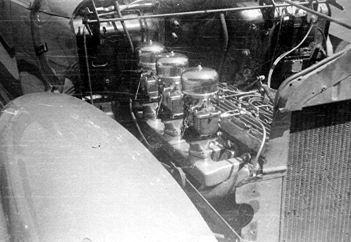

2 carbs for a 254
Edmunds did. Here is one:
I didn't realize they made a twin setup for the 8. Anyone have a setup for sale?
This could be the deciding factor in my '37 Deluxe project. I was going to install my spare 262 with Twin H because I wasn't aware of a dual intake for the 254. If I can find a dual intake for the straight 8 I would rather install the 254 and keep the car in the original 8 configuration.0 -

Jeez talk about over carbureted! two 2bbls !
Maybe if you adapted a pair of those Holley progressive 2bbls. or a couple small WA1's?
The little Stromberg 81s should do the job. I run two 81s on my 200 cid Model A and it runs like a top. Should be good for the 254.0
I had a pair of 990s WA-1s in mind. It should be pretty much equal to the 262 Twin-H in terms of fuel appetite.
Of course, it wouldn't be a "bolt-on" deal with that manifold.

You would need a couple of these: http://www.honestcharley.com/univ-1bbl-2bbl-carb-adapter.html0

Now, if you wanna talk rare, there's this one, for a 308. Only seen this one (The one Glen Johnson has is this same piece).0
