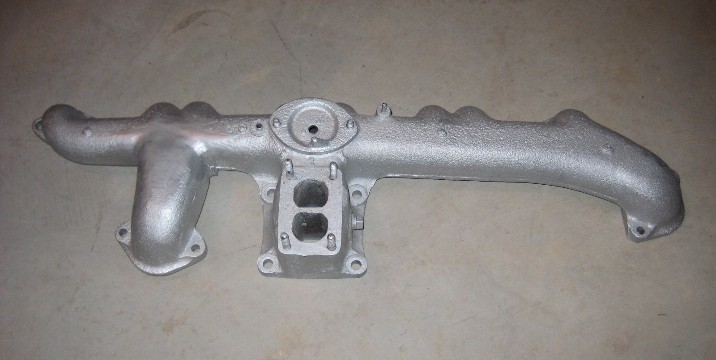

1. Flattening the contour of the "cam face" of the tappets slightly, which increases the open duration. Makes a noticeable difference. Al Saffrahn and a few others know how to do this.
2. A dual exhaust manifold. While Hudson did increase the exhaust flow path for '37, further power can be gained with a dual-outlet modified manifold.
Wow Park! That's a very cool manifold. Sure would love to have my 6 cylinder one done like that!

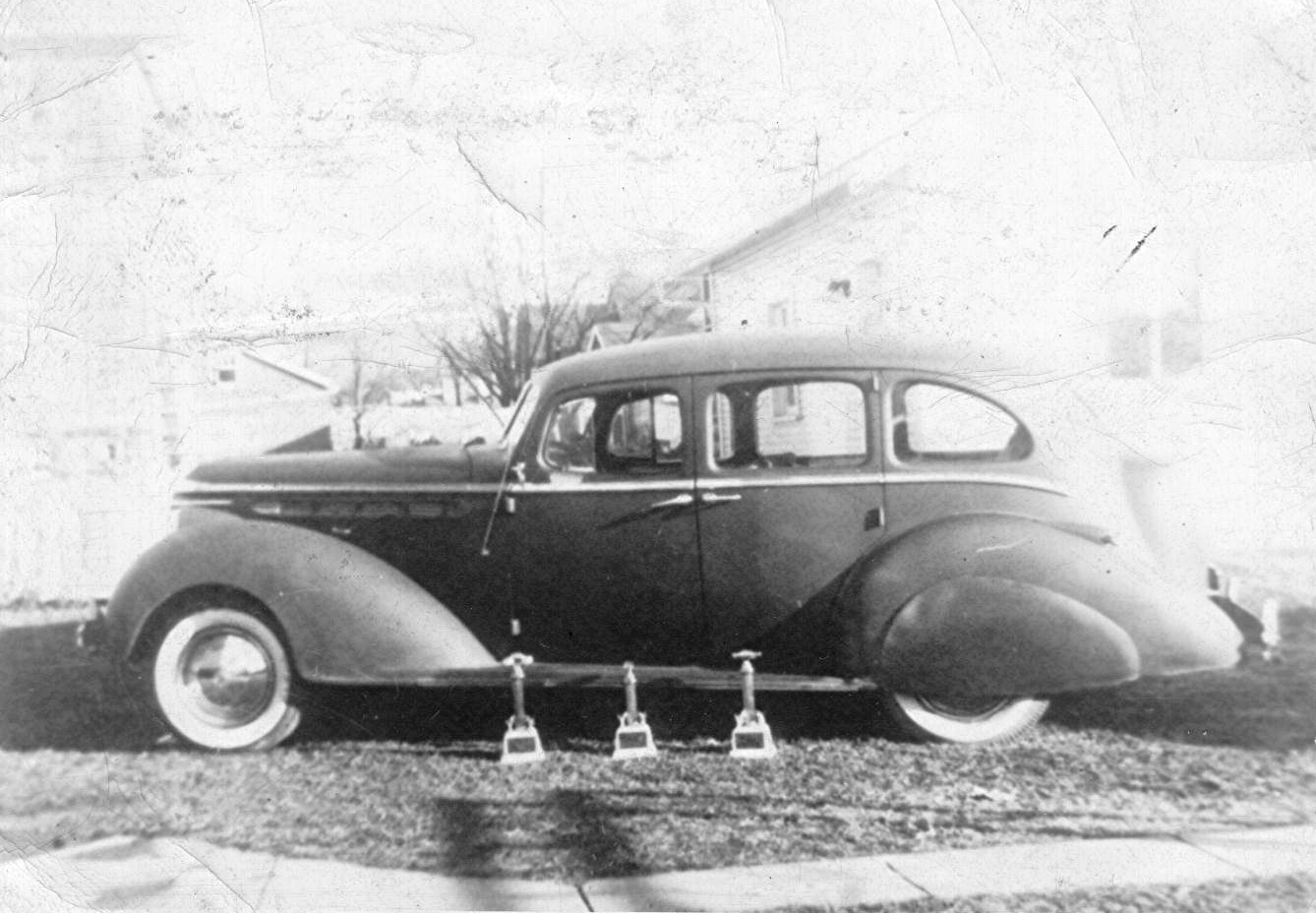

I'll try to find the name of the fellow in, I think, Kansas(?) who did mine. Back in about year 2009 this father-son duo were doing some good work on in-line engine manifolds, and there were a few photos and comments here on the Forum. My first one was in 1953, on my '38 8-Cyl sedan. In our senior year of HS a buddy did it for me in his welding class. Don Bright, Ft. Wayne's version of Smokey Yunick, who ran 2 '38 Hudsons at our 5/8 mi. hi-banked track, had built an 8-cyl engine for me. When the engine was ready, I put the split manifold on it before installing it in my sedan. I didn't realize how much the manifold was contributing until I had an occasion to swap it with a stock manifold temporarily. I was shocked at the difference in Performance. BTW, this 3,300 lb. sedan, at the big drag strip near Chicago, ran the quarter in 17 seconds and 84 mph, which was pretty respectable in those days . . . almost none of the new Olds 88s would match it.

There was a phone number there too at the bottom of the first link. It appears that you can cut a hole with a hole saw in the manifold then weld on a cast-iron outlet. Doesn't seem that hard to do.50ClubCoupe said:looks like the email address mentioned in the first link (above) is no longer valid. Does anyone have another source for splitting the exhaust manifold?
I do know that Ivan recommends running a bigger 2.5" exhaust and says you can feel it in the seat of your pants compared to a 2" pipe. He said that it is important to follow through right through the whole exhaust system not just upgrade the manifold. That would indicate to me this approaches at least a 10% improvement as it is hard for the average person to reliably detect less than that from what I have read.
I note that Park's car on a weight shifted basis at 84 mph indicates 155hp at the flywheel. I assume the 3300lbs included the driver etc.
Ivan must be biting his tongue pretty hard by now.
Frank
The 3,300 lbs. came from the scales at the drag strip (I wasn't in it when they did the weighing). Also put it on a truck scale back home, and that confirmed the 3,300 figure.0
That would mean the gross weight with say a 150-170 lb. driver would be 3,450-3,470lbs, meaning around 160fwhp using the ET terminal speed and weight calculator.Park_W said:The 3,300 lbs. came from the scales at the drag strip (I wasn't in it when they did the weighing). Also put it on a truck scale back home, and that confirmed the 3,300 figure.

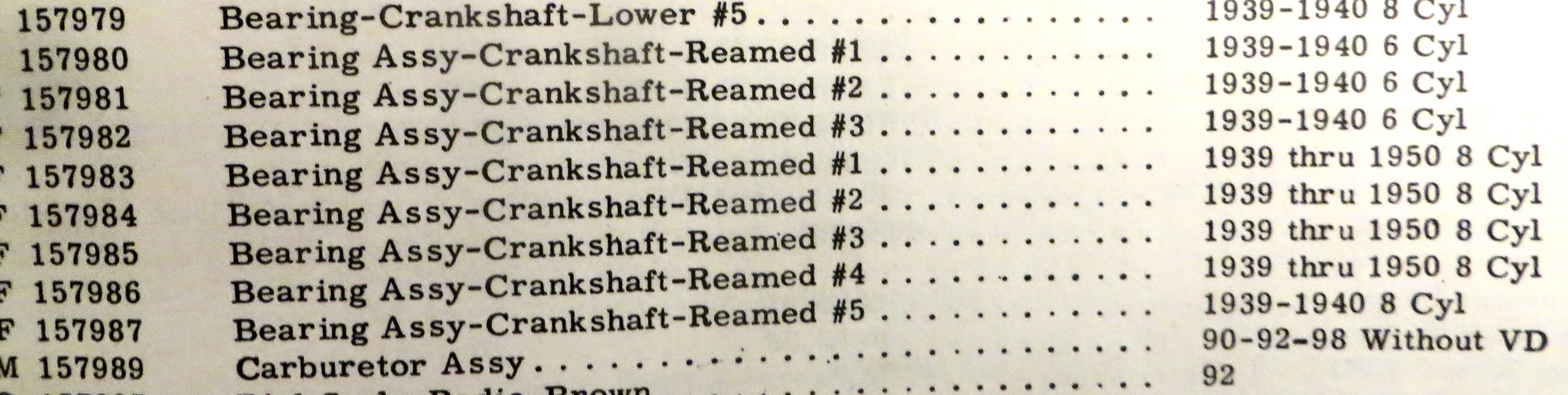

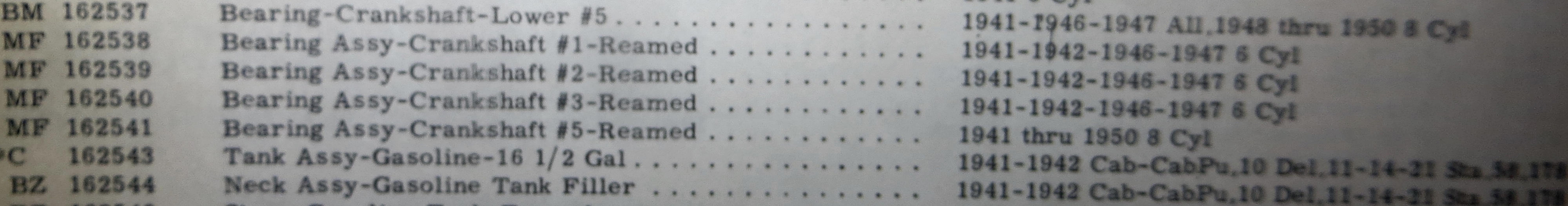

Do any of you know why Hudson listed #5 bearing#157987 as 1939-40 only and then changed the number to #162541 for 1941-50?
Info found in master parts book
Are std mains still out there for the 41-52 254? I have seen many for the 262 out there.
Looking for #157984thru157986
Thanks0
