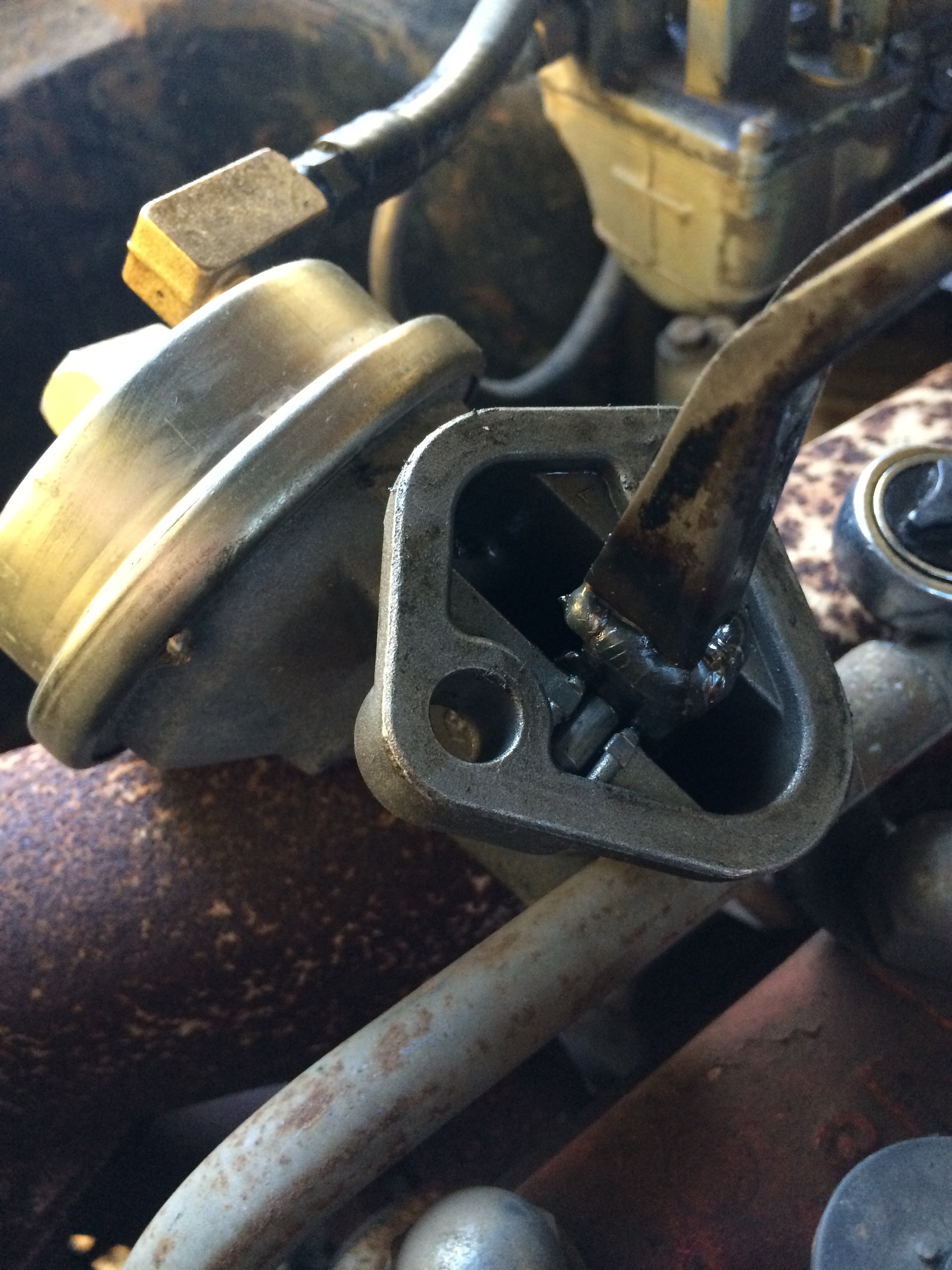

I hear what your saying and I'll check it out, maybe removing it disturbed something. So heres the pump and idk what the last guy did but the welds are pretty solid. Is this a common thing to do?
WO! You mean that the last owner welded the arm in place? If so, he might have welded it at a slightly different angle to what it should be. Which might mean that it doesn't have full contact with the cam lobe, and therefore does not have the full movement that will result in full vacuum. You might look for a replacement fuel pump.

That appears to be one of the AMC near-fit replacements. They will sorta work if shimmed correctly but I'm guessing that someone installed without doing so and screwed up the arm, then welded it back together, possibly to "correct" the arm angle. Scrap it and get the correct one.

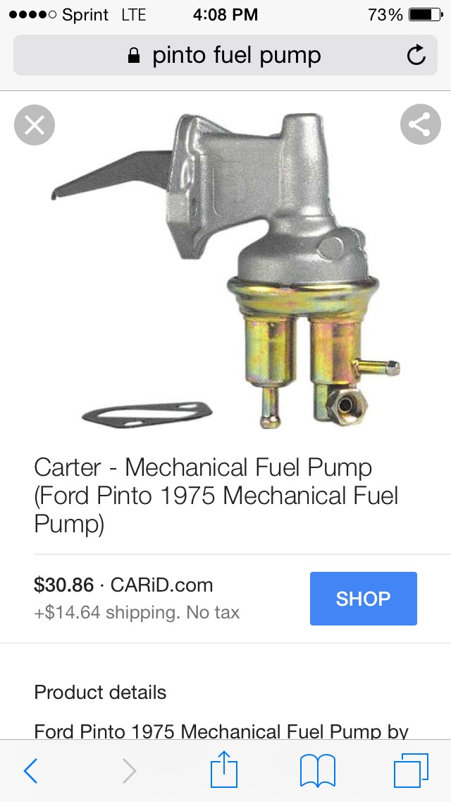

Ford Pinto pump bolts right on. All you have to do is either utilise the return pipe and runs a return tot he tank, or block it off.

Do you happen to know what year?Geoff C., N.Z. said:Ford Pinto pump bolts right on. All you have to do is either utilise the return pipe and runs a return tot he tank, or block it off.0 -
Sorry, don't know the year. We never had ford Pintos over here, but a club member sent me one and it bolted right on.
http://www.partsgeek.com/gbproducts/DC/15214-05415404.html?utm_content=DN&utm_term=1974-1975+Ford+Pinto+Fuel+Pump+Airtex+6445+74-75+Ford+Fuel+Pump&fp=pp&gbm=a&utm_source=google&utm_medium=ff&utm_campaign=PartsGeek+Google+Base&gclid=CP6dqqWIrNECFUmHswod5HkFcw&ad=47362750812
Here is one with straight arm , 71-73 have bent arm ?0 -
