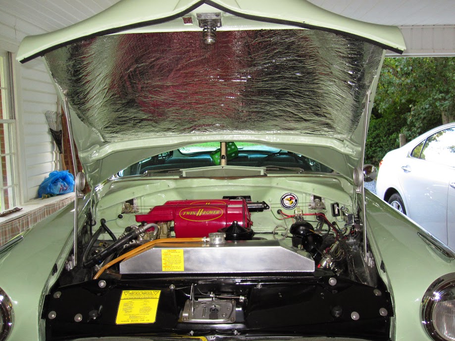

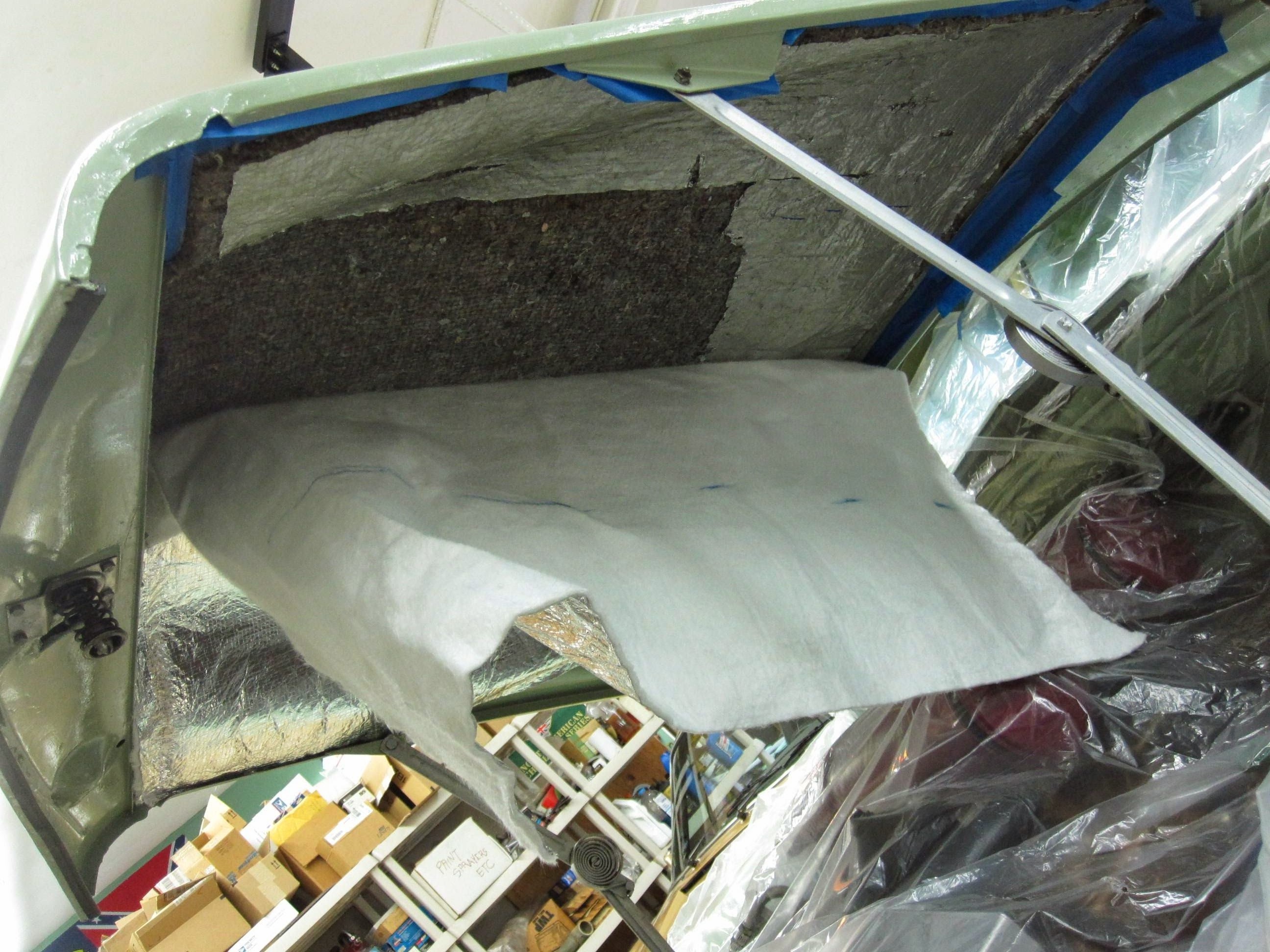

I have foil and 'fiberglas' insulation, 1/4" thick; but that was to cover up old torn stuff. I would suggest NO insulation because the heat needs to escape the hot engine compartment. Assuming the finish looks good for show.
Photo below is work in process.0 -

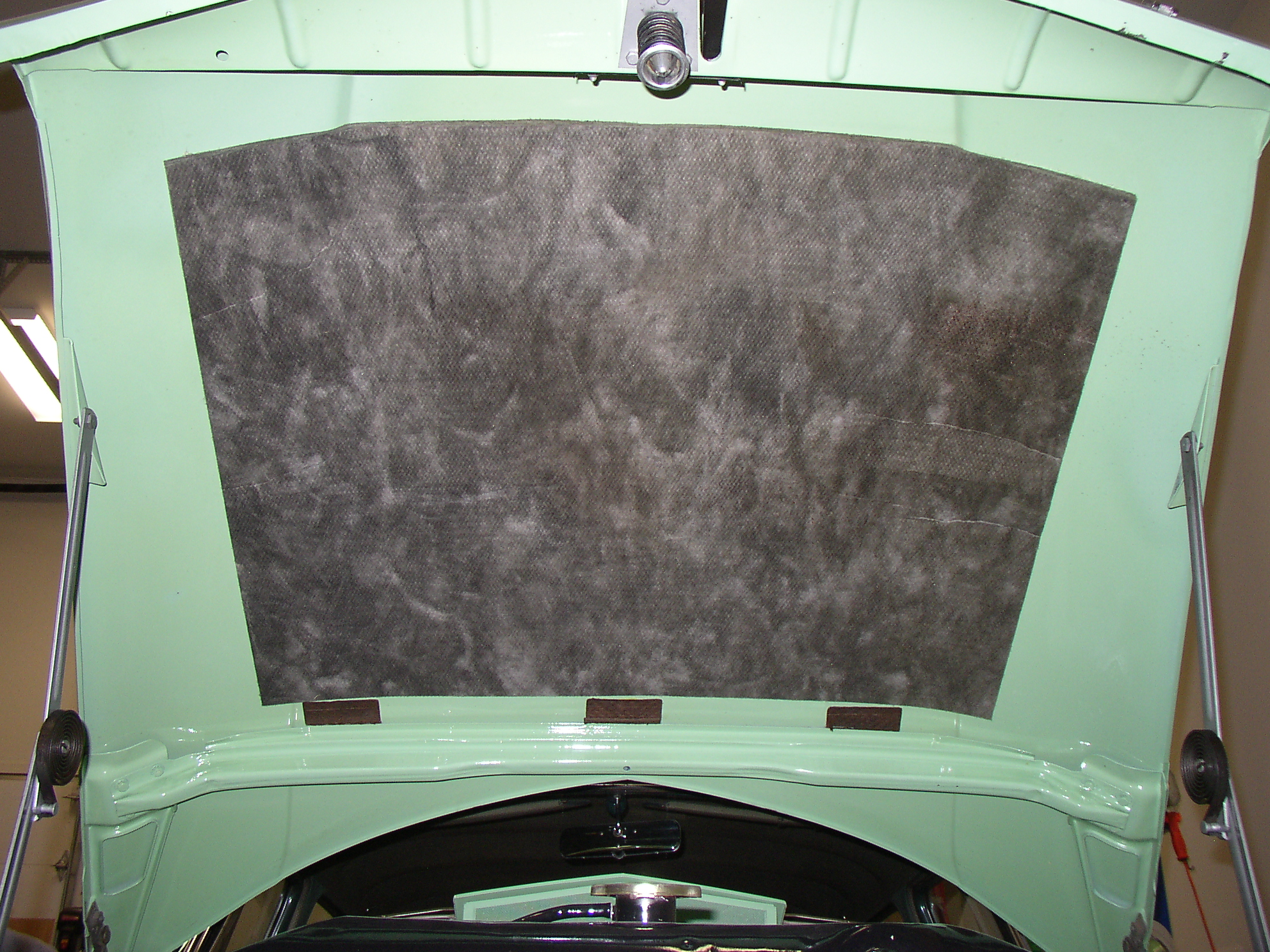

My 54 had ratty insulation on it when I purchased it. I replaced it with this after the repaint.
Beginning in 1952 Hornets & Commodore 8's had a fiberglass pad glued to the under hood area approximately the size of the picture above. It was placed there we were told to cut down on engine noise more than for an insullation.
