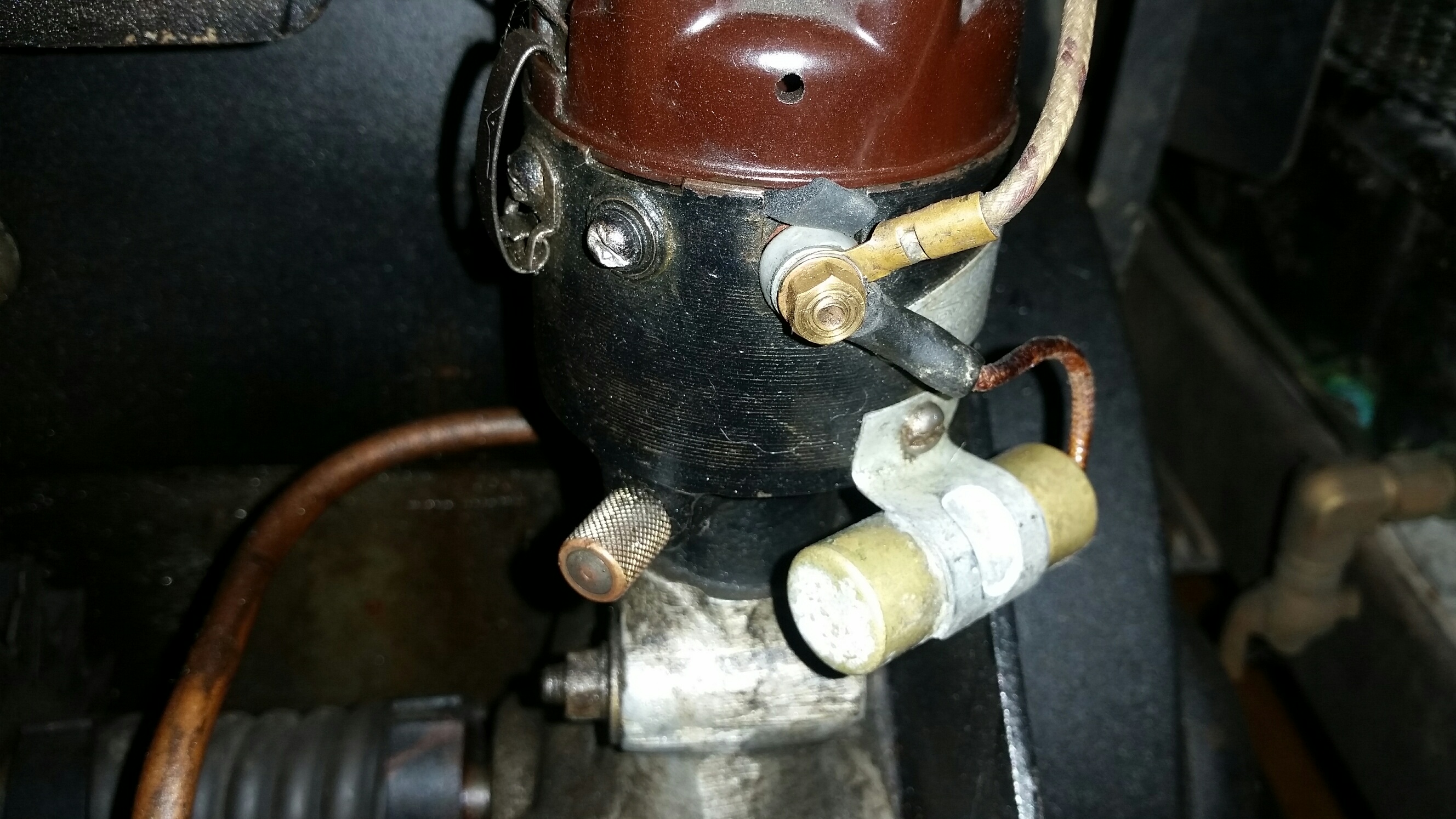

What a great car to have inherited. I have attached a photo of the distributor on my '28 which should have the same one as your '29. Hopefully this is clear for you.

Alistair's photo shows an after market condenser (very common)
If your distributor is an Auto-Lite IBA (or IB)4001 then originally the condenser was flat curved mounted inside the distributor. These are rare in my experience.
The other distributor often used in the 29's is the later IGB 4022 (much smaller than the 4001) which also had an internally mounted condenser.
If you have a 4001 be aware that the counter-weights are made from the dreaded die-cast zinc (pot metal or muck metal) & are likely to disintegrate. Geoff Clark (in New Zealand) has reproduced these in bronze & can supply them.
Excellent pictures and advice! That is just what I needed! I have a similar condenser to the one in the picture. It has been a great week, I found a new ring gear for my flywheel and got my questions answered on the distributer, now I just have to figure out my steering wheel hub. Thanks!0

Gary Lynch has the new steering boss for the 1929 Essex. I only have '28 version. You distributor will have steel counterweights.
