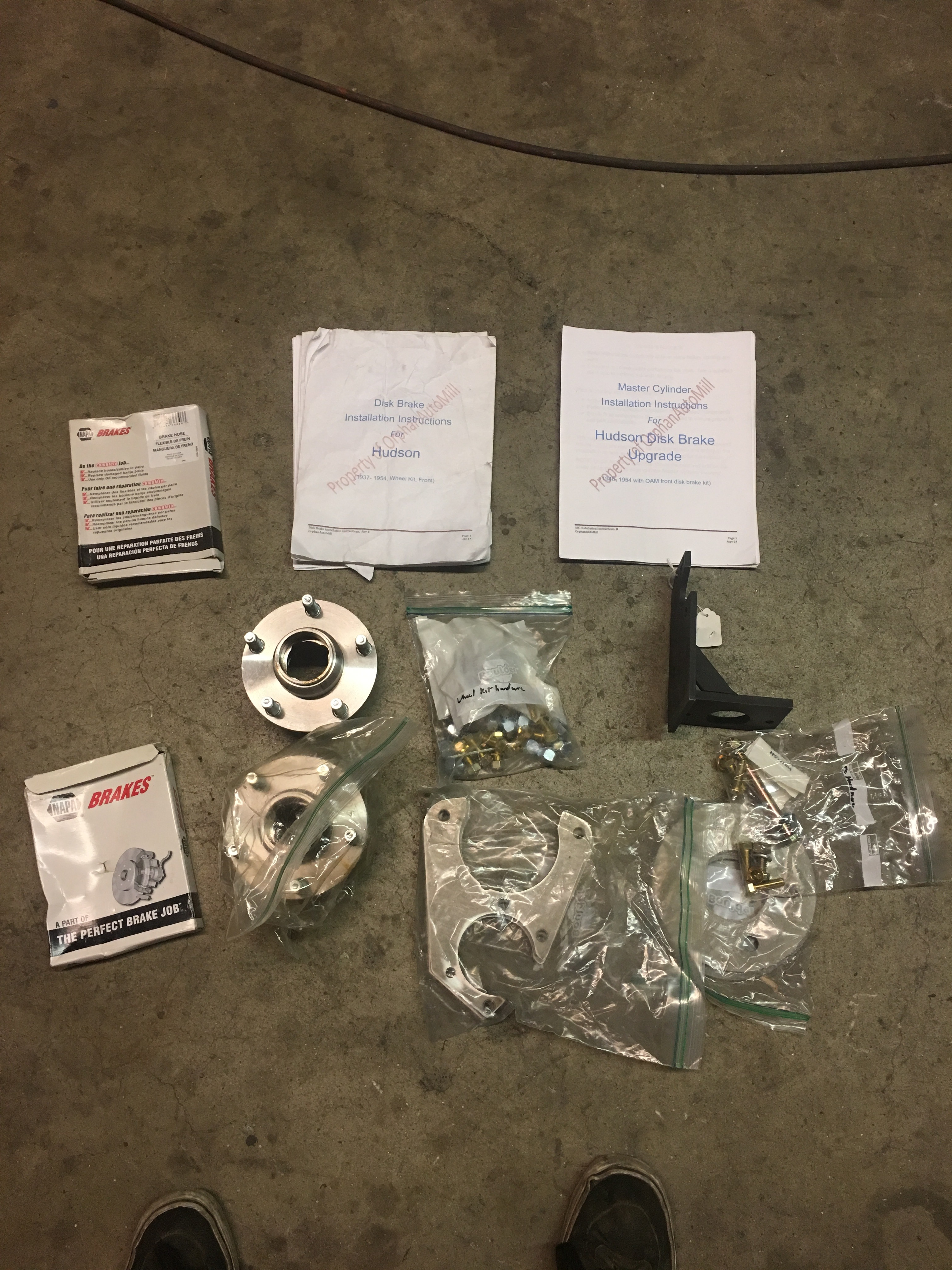

I have a front disc conversion setup for step down from orphan auto mill which I think is ran by member faustmb for sale. I believe this was based of off the Lubuds kit. I have the MC kit and the hub kit. Looking to get 400 plus shipping. I believe I paid 540 plus shipping.thanks

What kind of MC kit do you have?
I have the rest of the disc kit, just haven't looked at the master cylinder conversion yet...k
