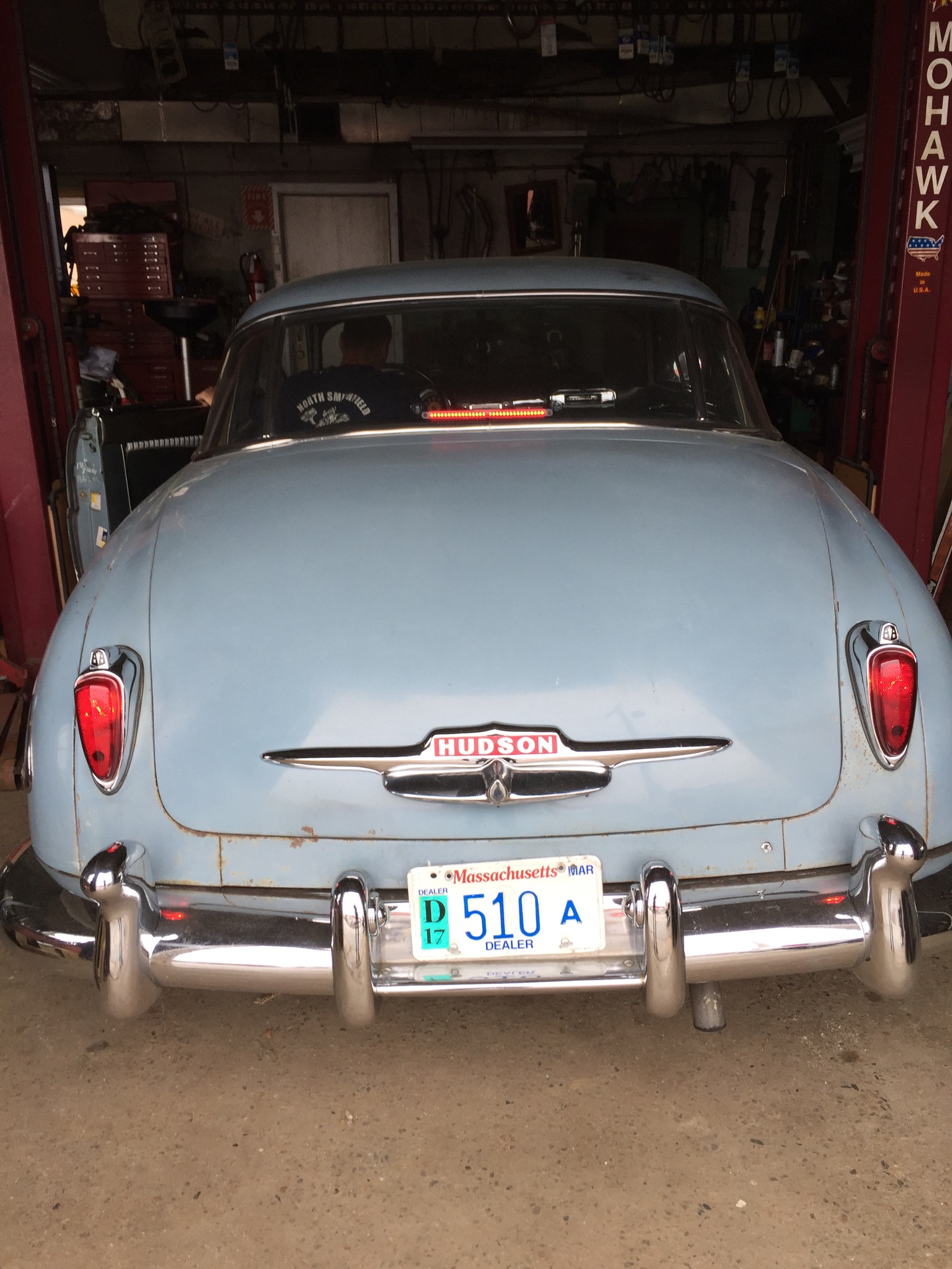

Hey 35 Terraplane,
I have the same third brake light as well. VERY happy with it, and he is a super helpful guy.

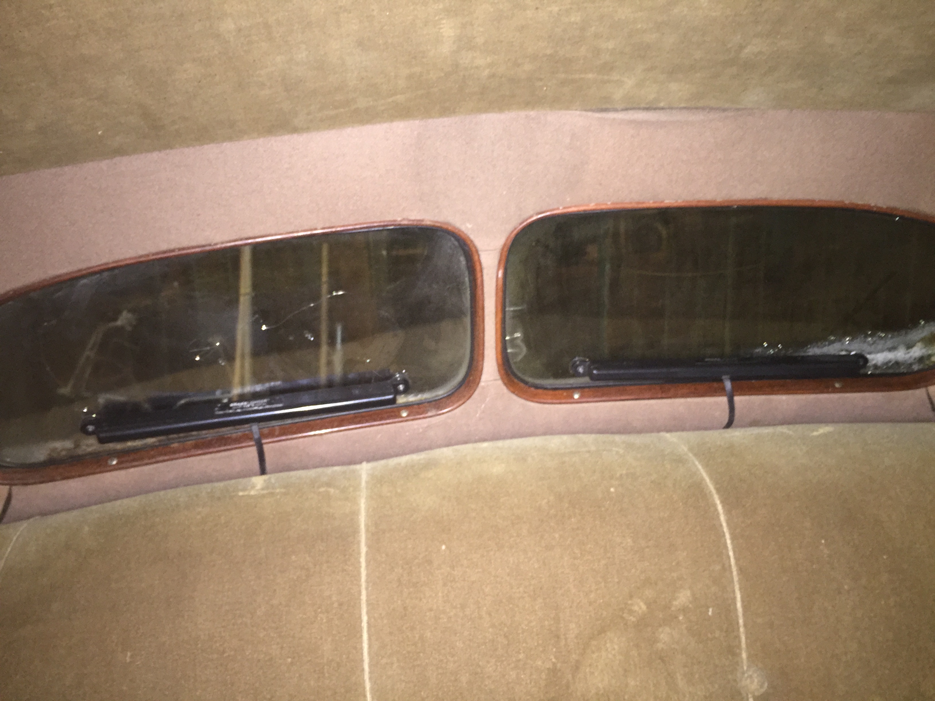

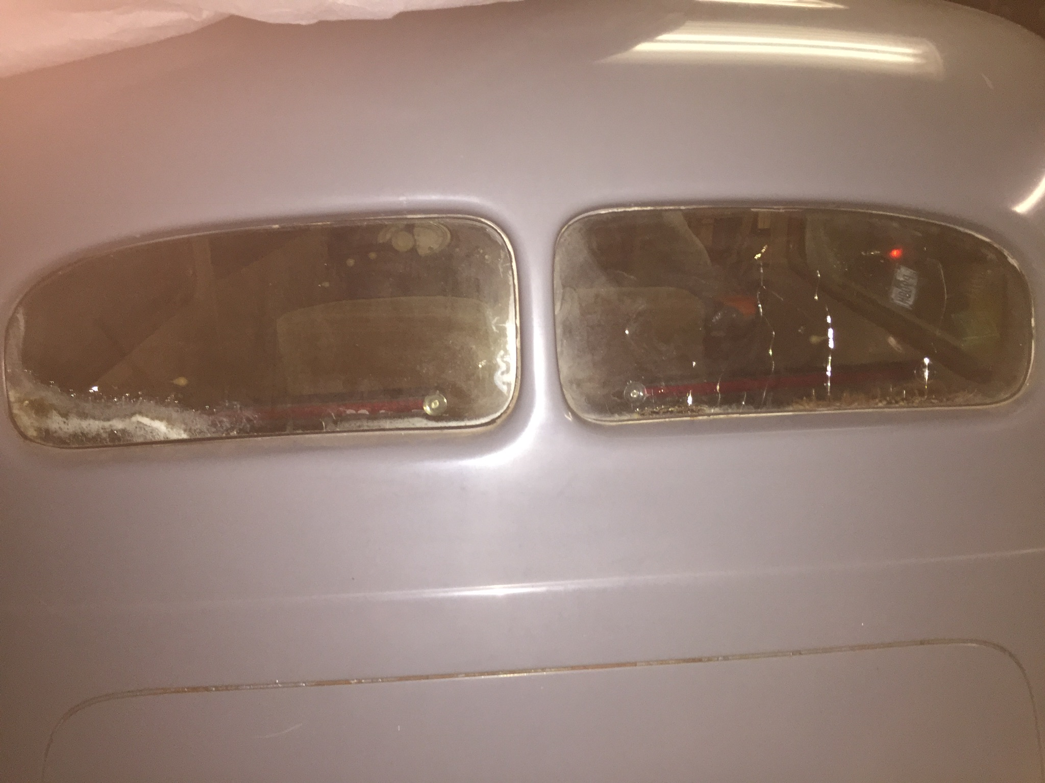

Being my Terraplane is the basic G Special with one tail light I was always nervous others didn't see me in spite of using hand singles. I don't think most these days know what hand singles are. Anyways, when I rewired my car I added the third brake light, well actually two, one for each rear window. I like to think I'm a little more visible. Just took a few pics, hard to see them from the outside as the cars in the barn for the winter here in upstate NY.

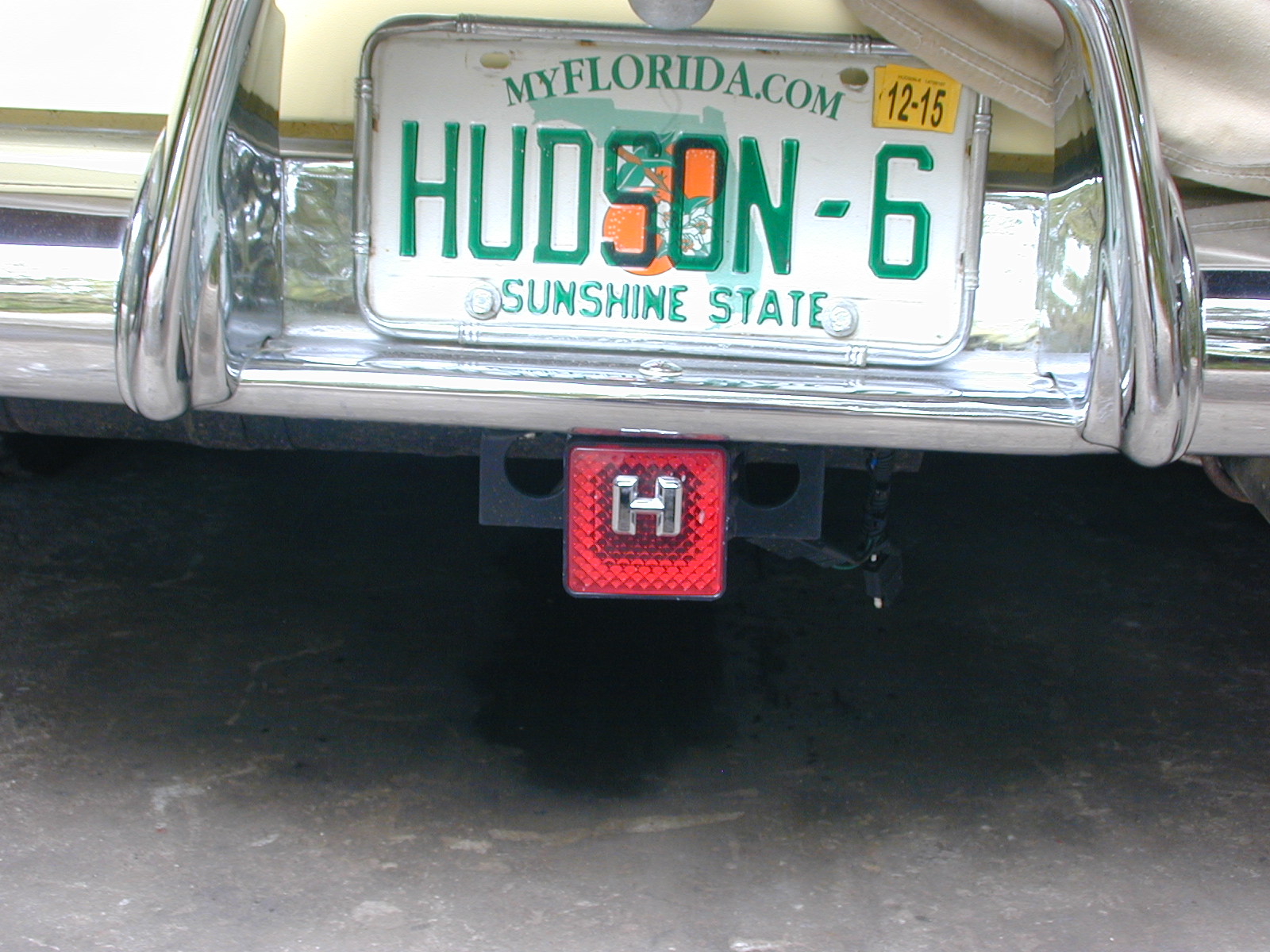

Since we are talking about third brake lights. Here is mine. In the trailer hitch receiver.0
