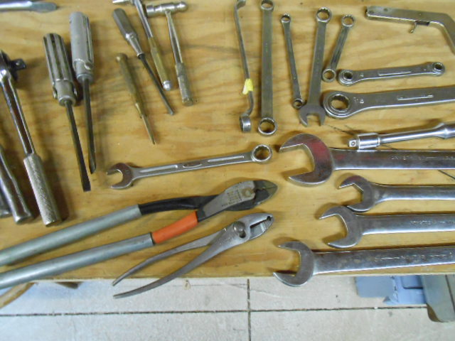

I have two of these , only need one. This pair has extenders on it , more leverage.
Easily removed. $20 plus shipping if someone needs them.
Send a PM
