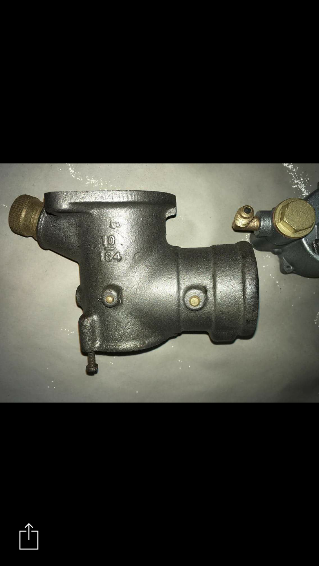

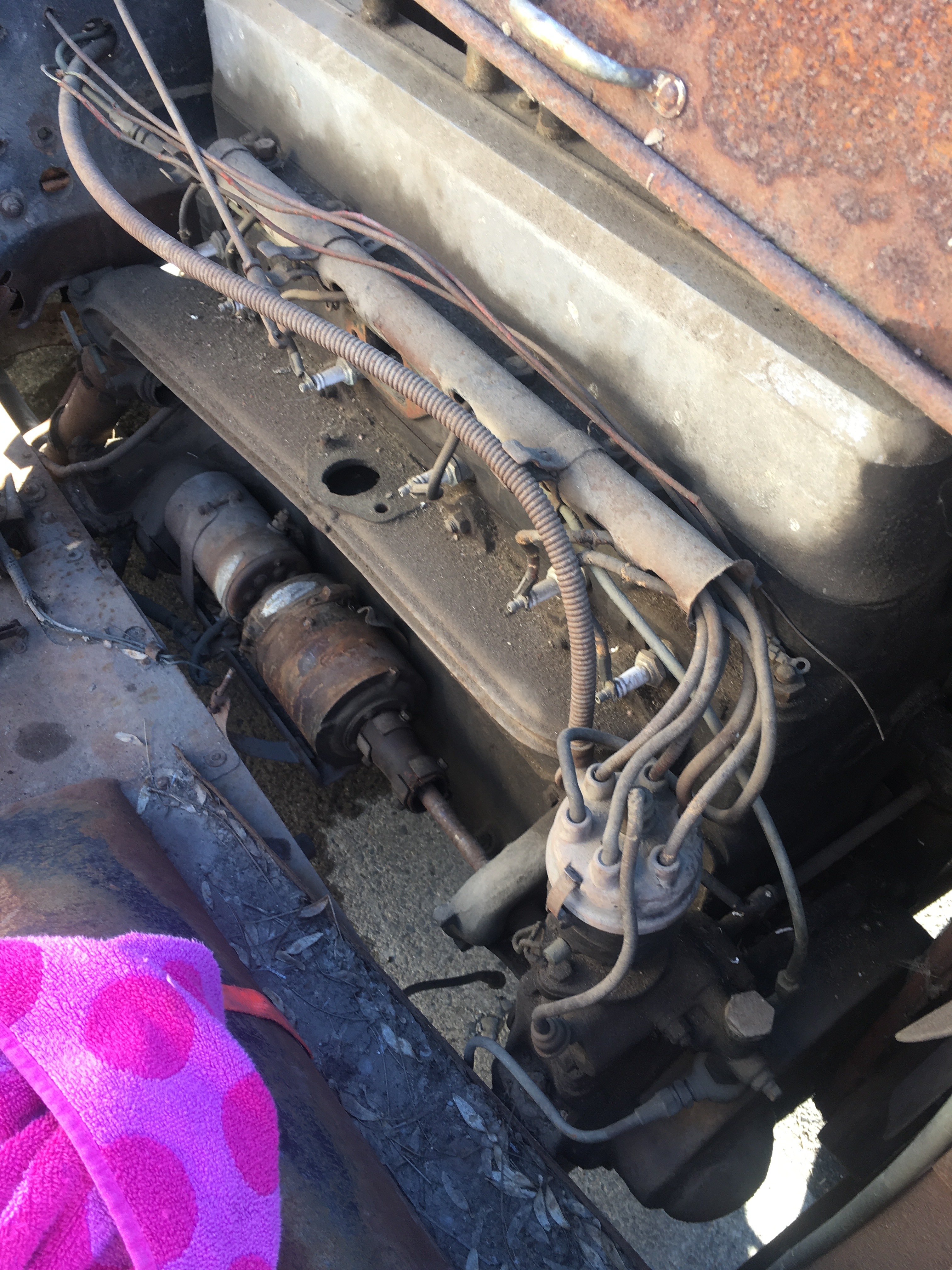

Went through all of my parts and pieces and it appears That I'm short the whole carb set up ( The water pump is not pictured but I do have it as well as the impeller) Shaft does seem a little bit beat up but we can all get to that and others once I find all of the relatively (few) missing parts
P.S. any ideas what other cars may have used this model of carburetor in case I can't find one through this group ?)

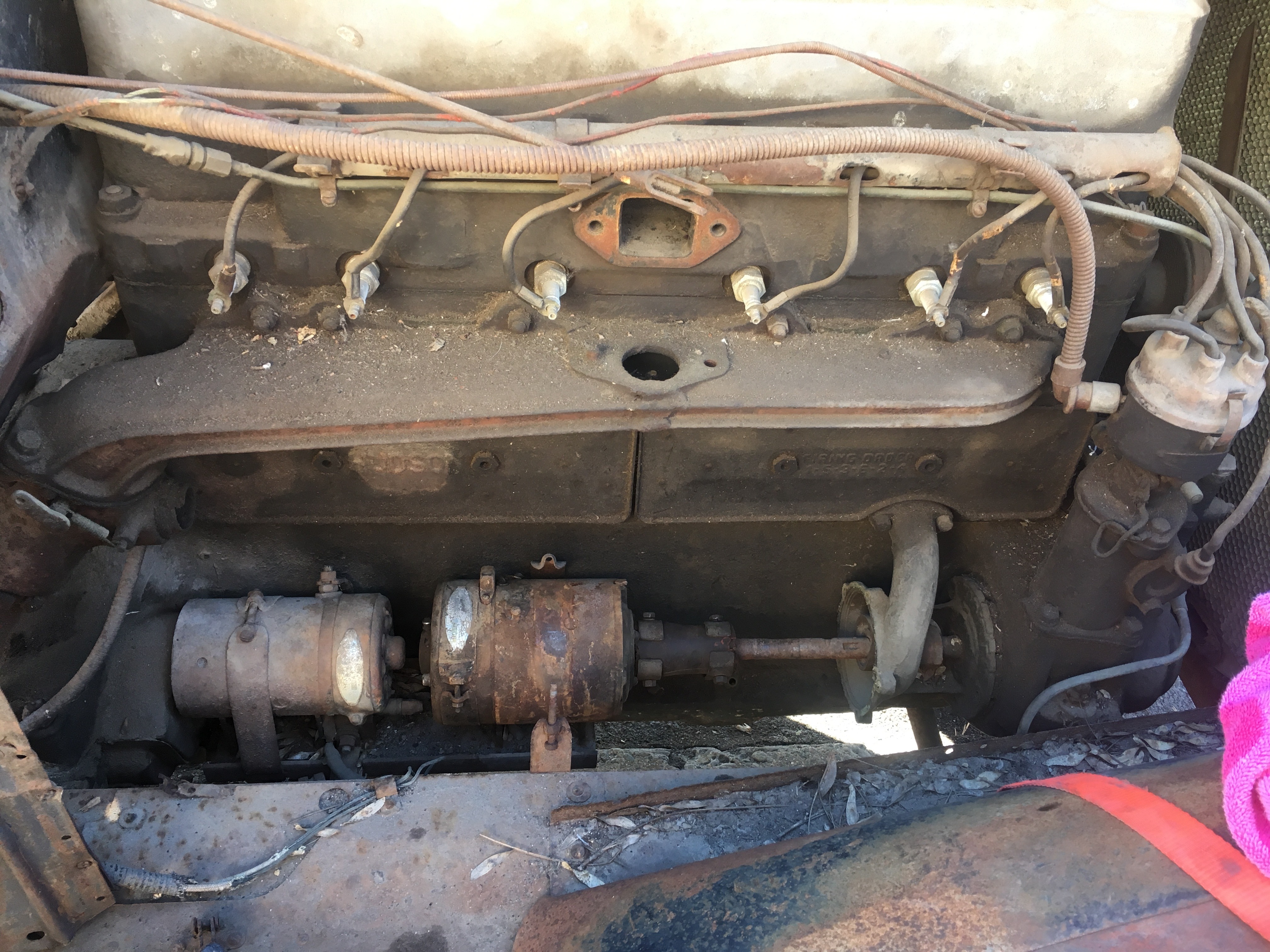

I found some '29 Hudson engine photos on the internet. Not sure they are all '29's, because one has what looks like an air silencer down toward the bottom, which the others don't have.
http://www.spudsgarage.com/archives/29HudsonCab/
http://www.spudsgarage.com/archives/29HudsonCab/presentation/019.jpg
http://www.worldwide-auctioneers.com/photos/29/99/9.jpg
http://www.desertclassics.com/DC9/image/Hudson29sedan34.jpg

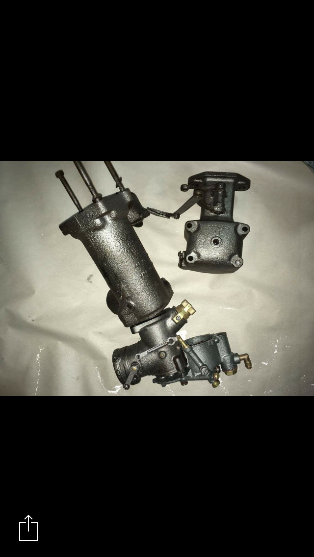

Looks like you need the whole caboodle, inlet elbow, heat exchanger carburetor and air cleaner. By the way, it is marvel Model "E" you require. If you cannot find one it is very easy to convert to a down-draught type, but you will need an electric fuel pump.

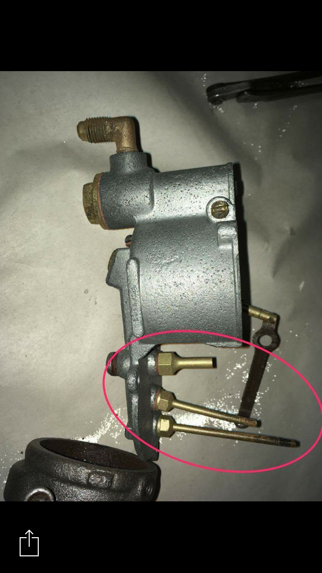

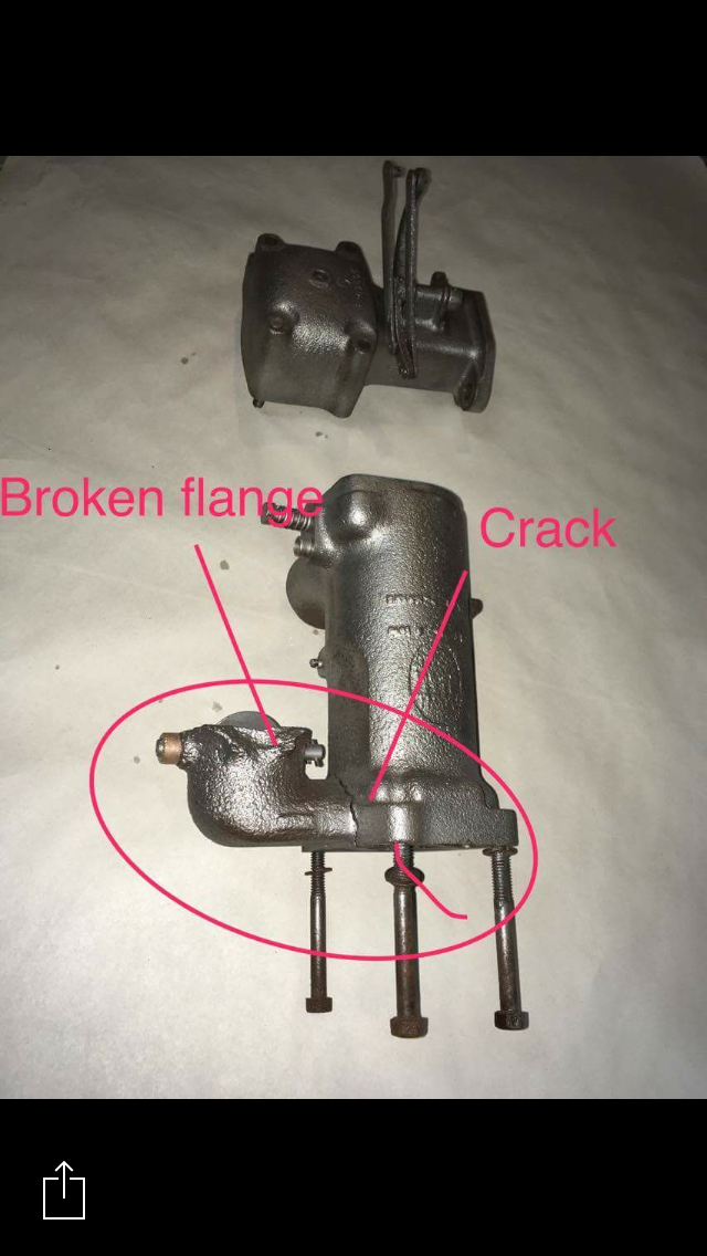

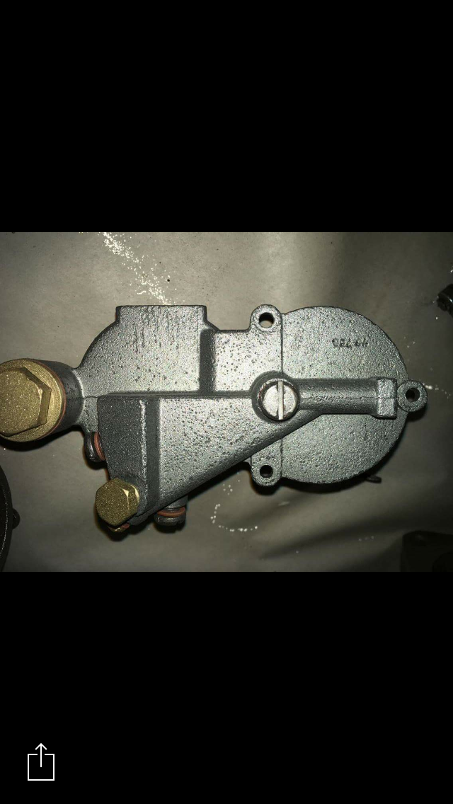

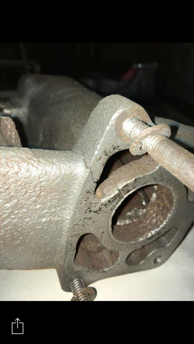

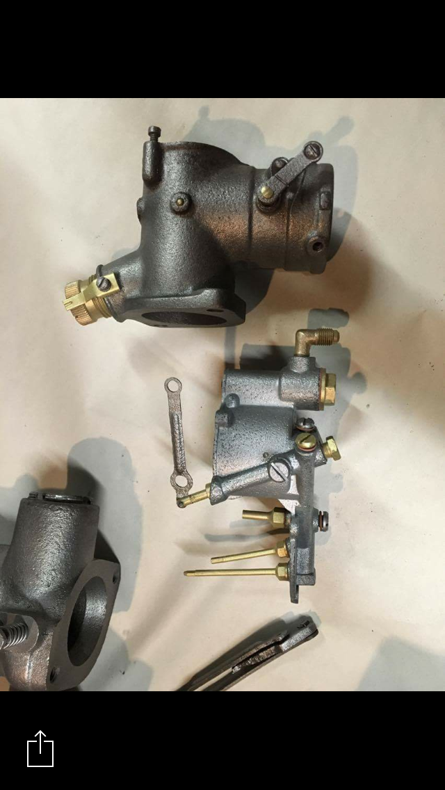

Hello, A guy I know has this carb set up for sale, came off a 28 that had been upgraded from the 2 jet to this pictured 3 jet set up at some point... ( he's asking a reasonable $250 as a core/ rebuild). Not sure on the model, best I could find that I needed was a vb-10-724 but you mentioned needing an "E" ??? What do you think about the set up below????
I wouldn't pay $250 for a unit that is broken like that one, as you will have to have specialised welding to repair it. As stated, the hot box is 1928, as is the throat, but the float bowl and jet assembly is 1929. so the high speed jet is on the wrong side for that base.
