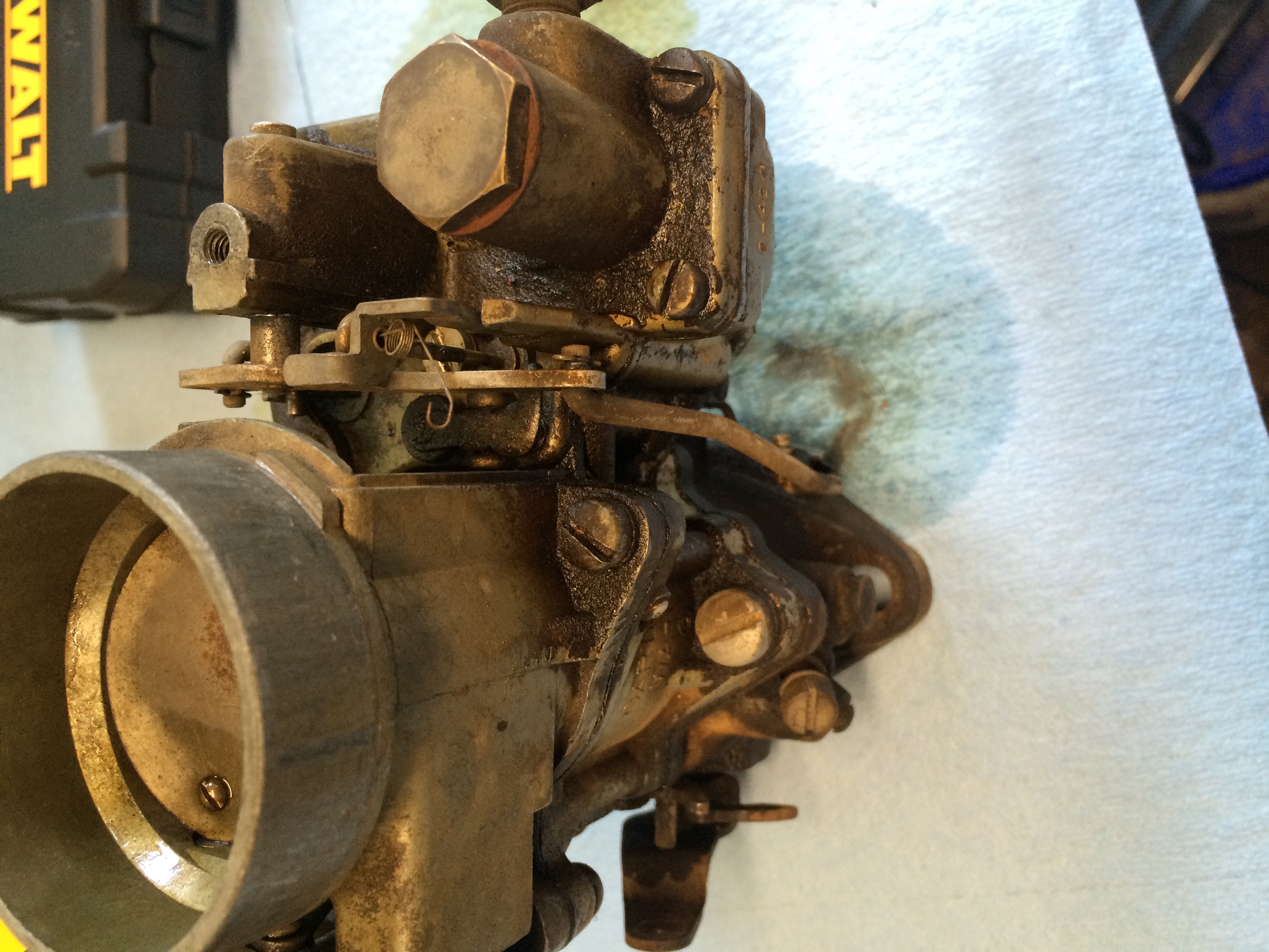

so a few weeks ago I decided to rebuild my carb because it flooded the engine in the middle of an intersection. There was a good 3/8s of fuel sitting in the bottom of my intake manifold. I got the parts the other day and gave it a good clean and replaced what parts I was given. Put it back on the car and it started fine, then the next day it had trouble starting and there was a little gas sitting in the manifold again but nowhere near the amount as before.
You may note in the picture the carb has a spring that is not attached but seems to hold the pin in place, should that be attached somewhere?

You have not placed the metering rod spring in place. Go to my website select "fuel" from the index and find the rebuild chart for your carb.http://hudsonrestoration1948-54.com/index.html0
Thanks! I got it pulled up right now, my spring is currently broken. Do you know of someone who sells them? Or perhaps use a pen spring?0
Yes, spring needs to be properly positioned. Float level and condition of needle and seat
can also cause the flooding problem. I'm more concerned about the carb number. 749S is for the 232 engine. Also the base of the carb shown looks like mounting holes were "altered/stretched".
Good luck.

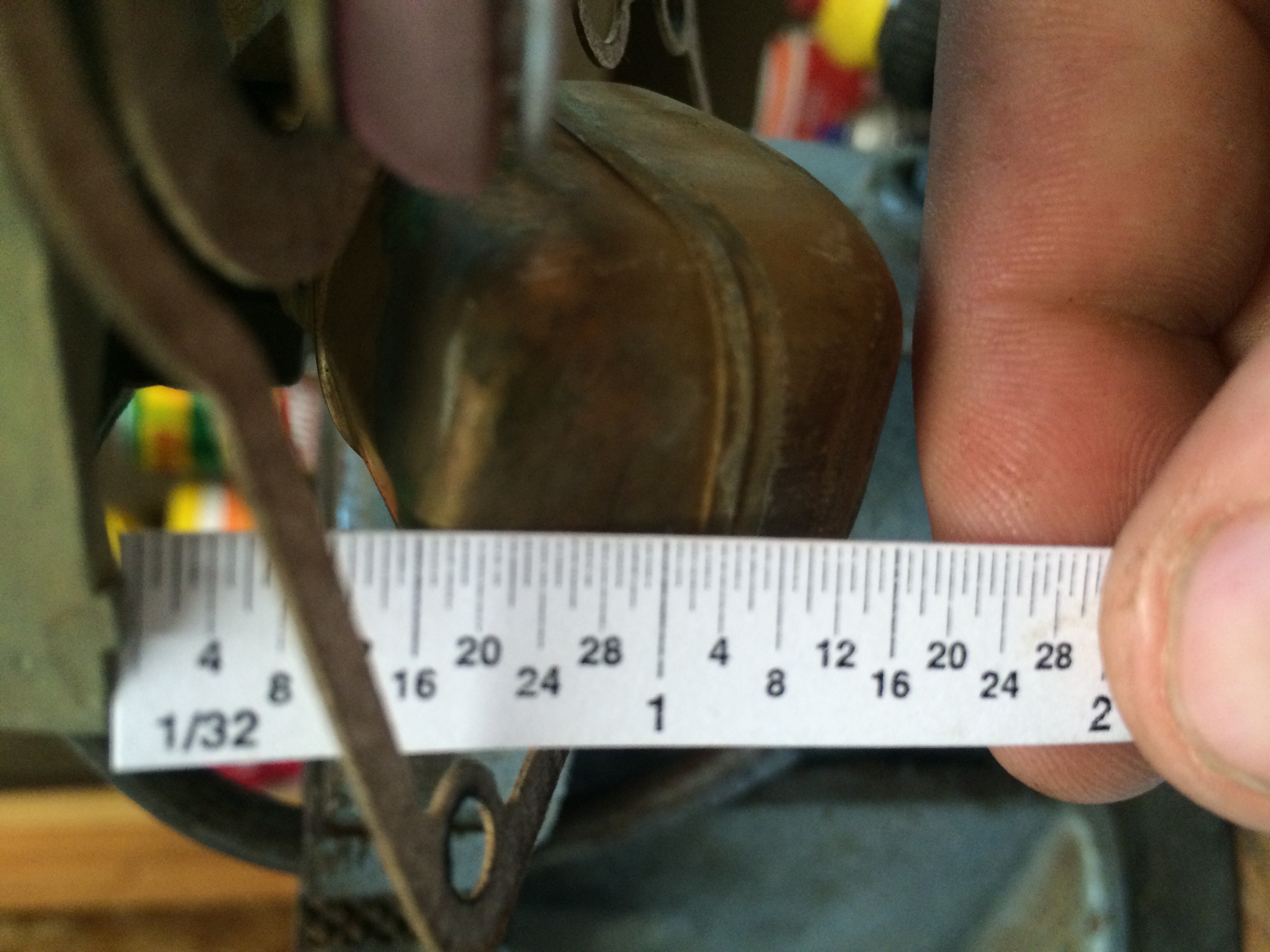

Are you measuring float drop ?? or height ? Did you study the procedure for these settings? Will never get that carb, designed for a much bigger displacement engine to work properly on a Jet.

It was float drop, and if you have one that'd be awesome!0
