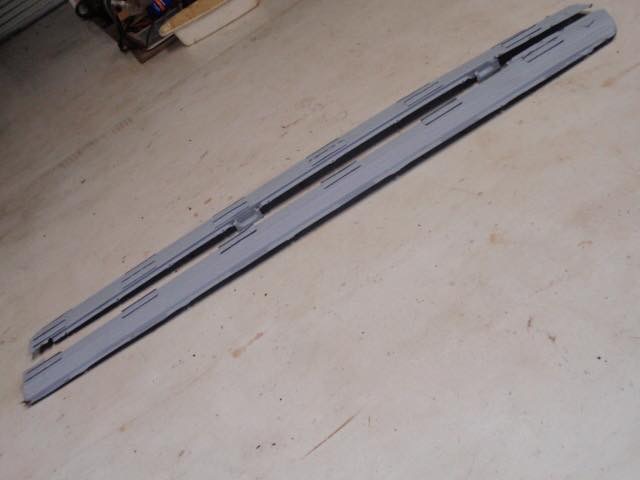

Im after rocker panels for a 49 four door.
Mine have a few rust holes and I thought if I could get whole panels then I would go for them rather than fix up the ones i have. I would prefer rockers with the contouring body lines but really it isnt a big issue. Im thinking i will have the lower stainless removed since I will have side pipes down there.
I see Classic to Current Fabrications make rockers. After doing a bit of a search here i see they are actually 54 rockers and dont have the contours of 49 along with maybe being to short. Still that price is tempting... if they are the right length for a 4door 49 then I may go for them. Advice?

I had some rot in the front areas of my rocker panels and I bought a pair of skirts. Cut out the rust area, then cut a contour-matching piece from each skirt and welded it in.
Problem solved.0 -

Has anyone used the C2C fab ones? they fit a 4dr 49?
Thanks again
Alex0 -
C2 items are for 1954 and are great for that application. Not for earlier Stepdowns0
