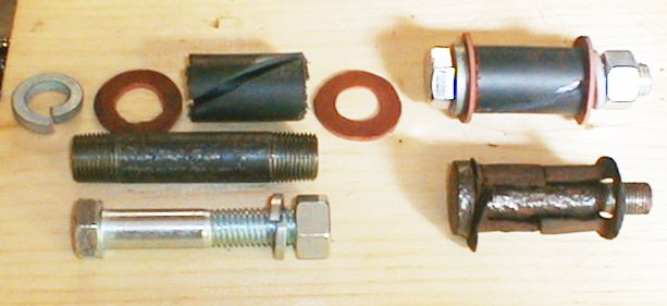

It's been a while, and the memory is a little foggy, but I happened to take a pic of the parts when I did my 47 pickup.
You want to disconnect the rear shackles and raise the car to remove any spring tension. The lower right pic is the original pin with 2 T-shaped rubber bushings facing each other. The pin has a large end which fits in the frame bracket, with a threaded nut and washer on the other end. Remove the nut and washer and drive the pin out and remove the bushings from the spring eye. They may not be re-usable.
Mine was too trashed to replace so I used a standard bolt with a lock-washer under the head to mimic the large head on the original pin. I cut a piece of hose (probably heater hose) for a bushing and 2 rubber washers (probably from a truck inner tube to mimic the T-ends of the bushings, and re-assembled, inserting the bushing into the spring eye, and the bolt with rubber washers in the frame bracket. Finish with a lock-washer and nut. (upper right pic)
I don't think I used the pipe, and may not have had to spiral slice the hose.
