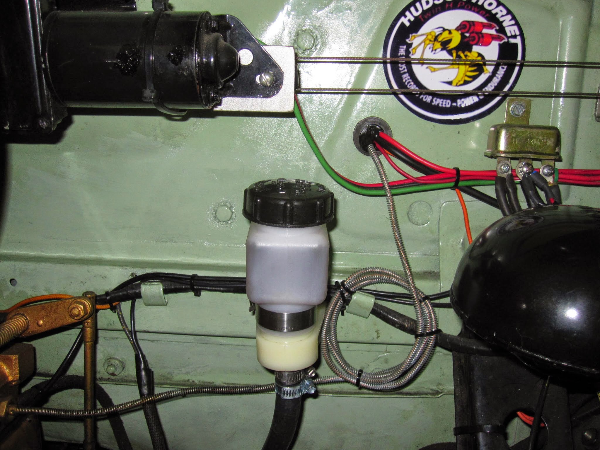

Might want to consider; 2-speed, no slowdown on hills
Edit: after talking to them, I don't think what I am showing is theirs !!
