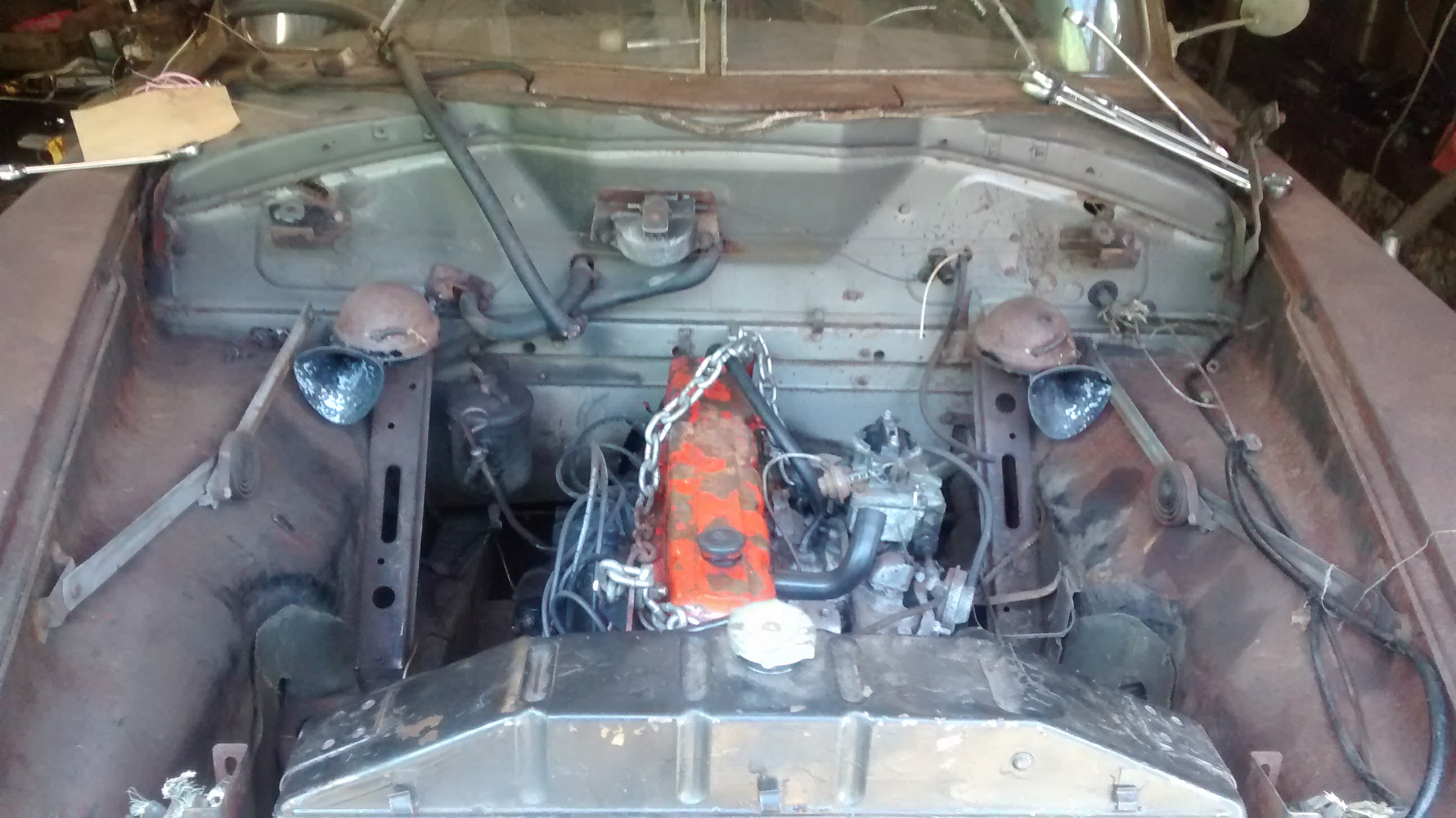

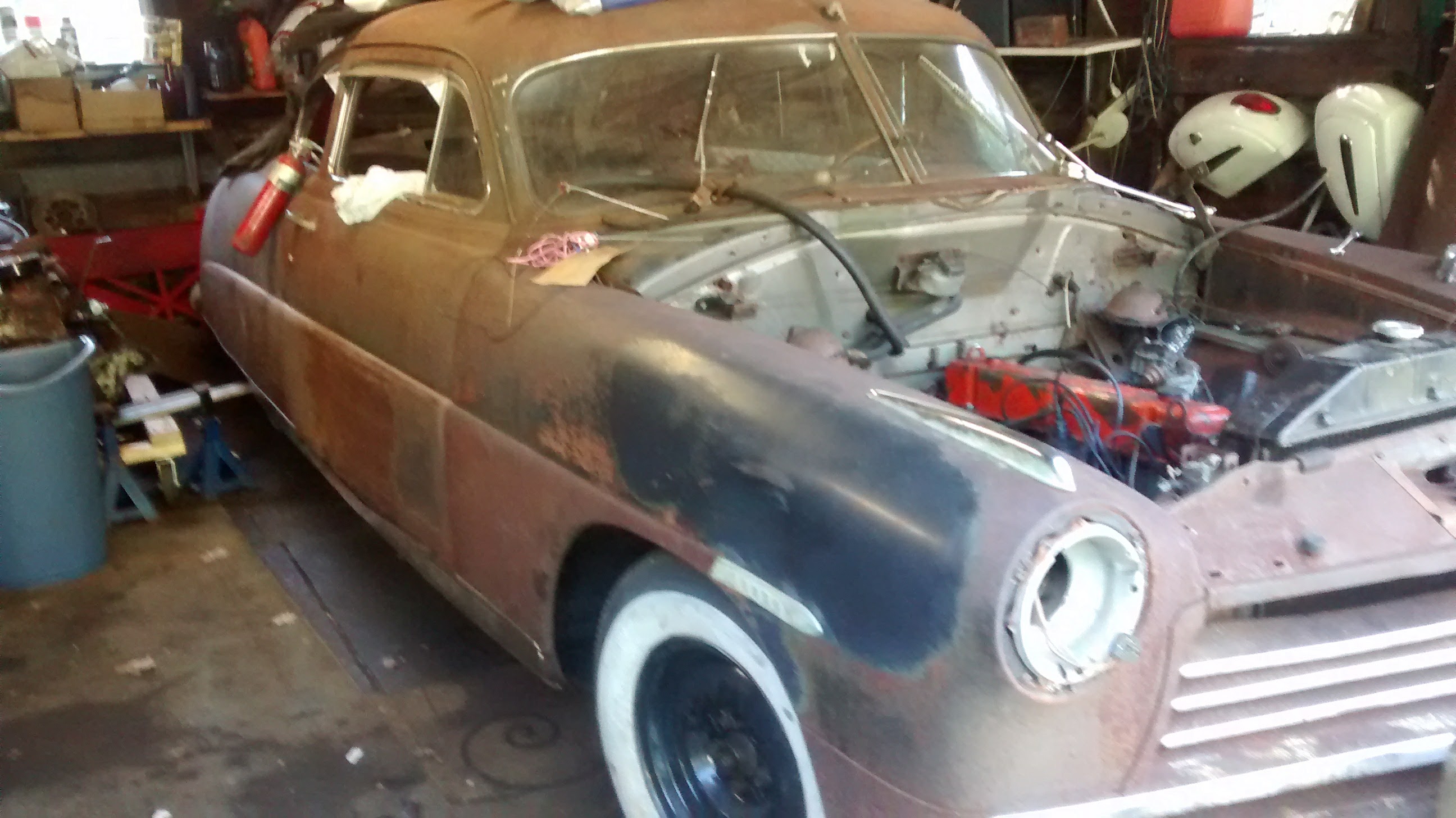

well got some progress done over the couple days off for the 4th of July. chevy 250 and T5 trans are in. Mounts fully welded. Made up a battery box. So far everything clears: steering linkage, clutch linkage, looks like plenty of clearance for the exhaust, using stock radiator. Need to measure and order a shortened front half driveshaft. Still lots to do but back to having fun with it. Still have original engine setting inside garage waiting to win lottery for a rebuild. For now I just want to get this thing going.0
ps SuperDave - i didn't have to cut anything to get the 250 in there. Plenty of clearance for the oil pan to sit above the crossmember and steering. maybe I did something differently?0
