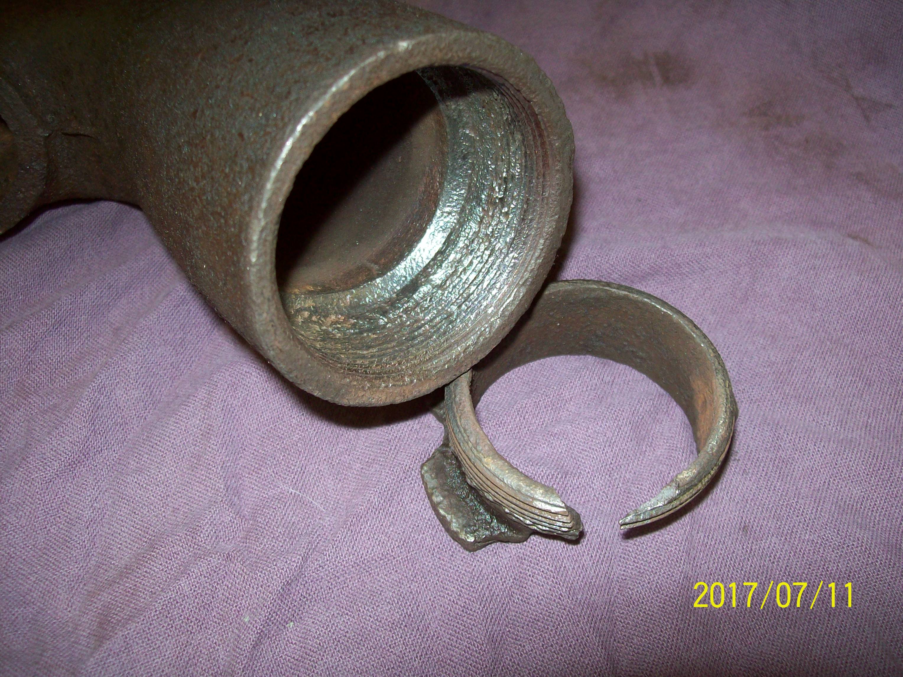

Thank you all for the input. I have 2 broken manifolds & it looks like the nut has swelled with rust & pushed the side out of the manifold. How would you put a flange on? I would go that route since it would solve the problem .

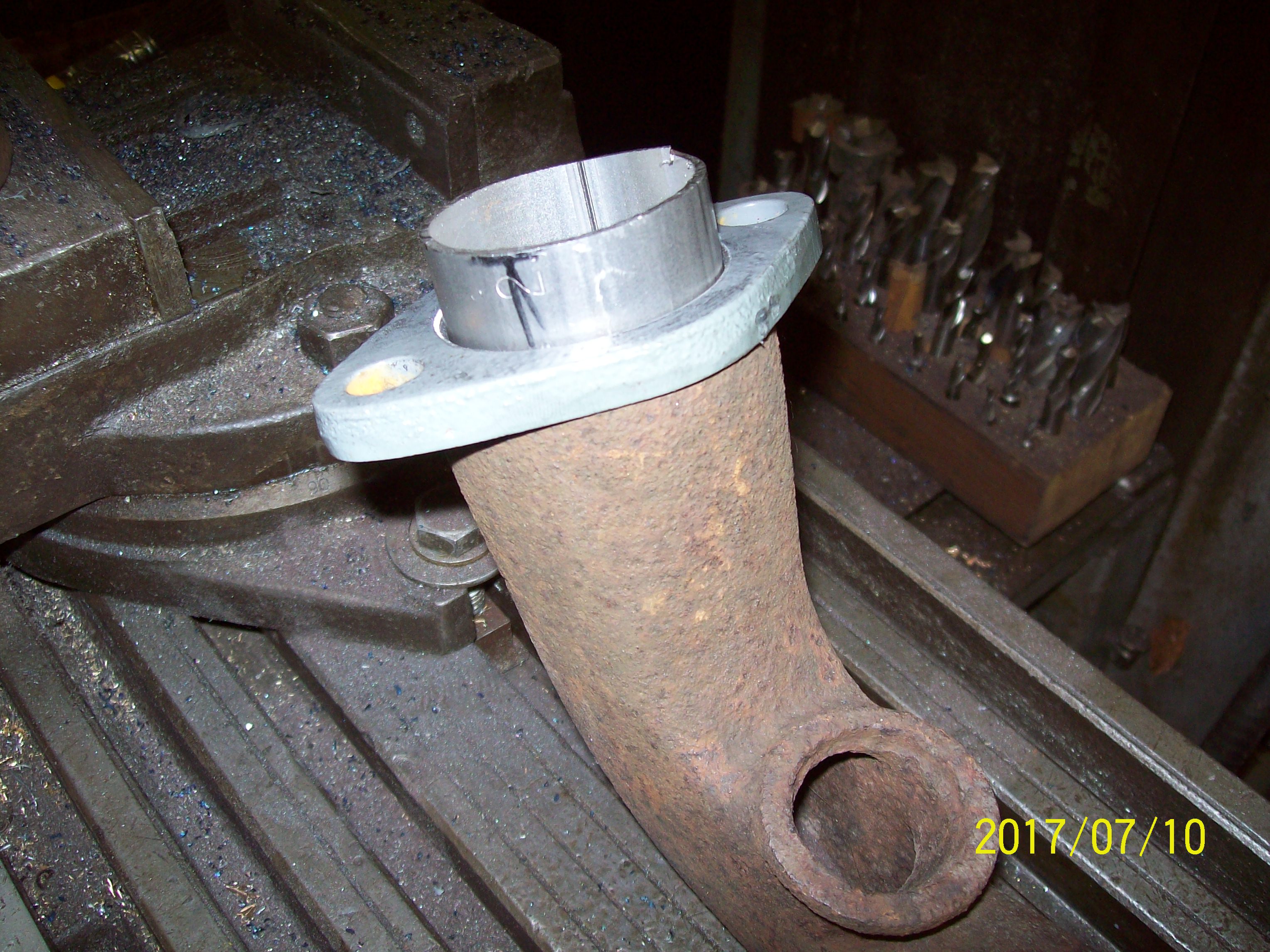

How is the flange fastened to the cast iron manifold? Thank you for the offer Geoff but shipping the manifold from Canada to & from N.Z. would be very costly.

The flange nuts were all the same from '24 thru '29, so Gary's flange will fit your car. You arc-weld a flange on if you are going this way, using a nickel-iron electrode.0

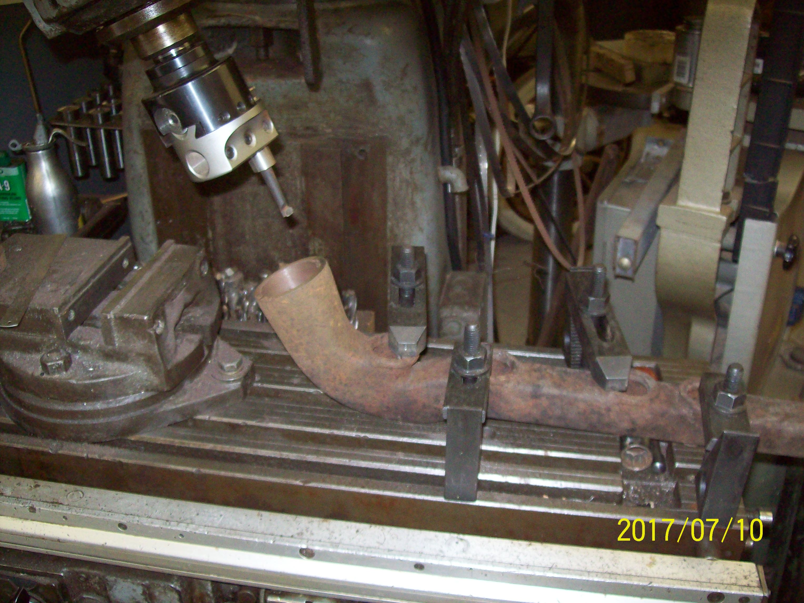

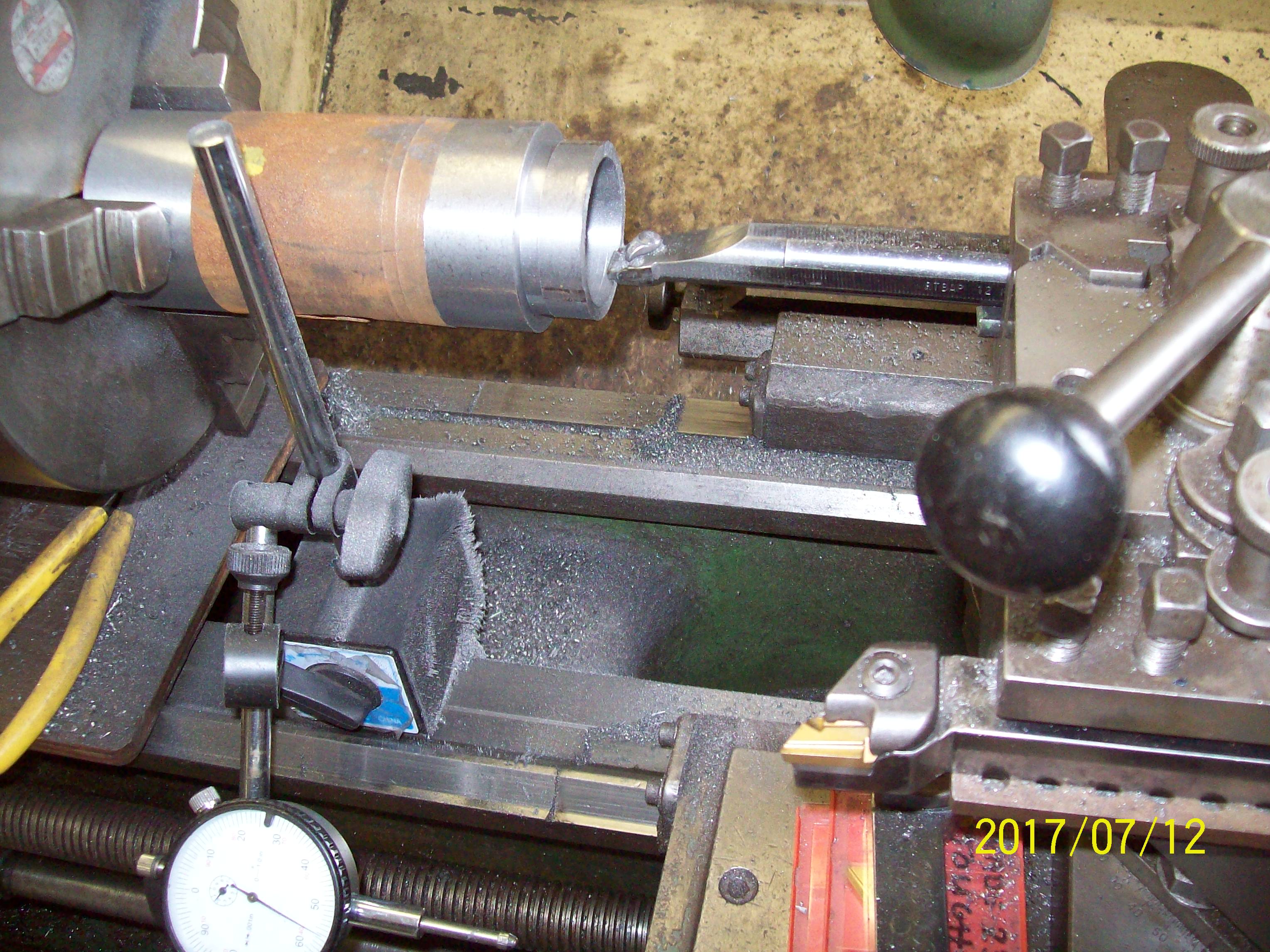

Thank you Geoff, I did some experimenting today with the loose broken manifold I have. I cleaned up the broken end & opened up the remains of threads to 2" ID. The steel flange is now 2" ID as well. The mating flange can have the exhaust pipe protruding about 3/4" so it will enter the manifold & reduce pressure on the gasket. If you agree that this will work I will have it welded by a professional welder. ( I am forbidden by my cardiologist to weld due to an ICD that might go off due to the field from the welder.)

That will work fine. It's easier if you position the bolts at 2 and 8 o'clock, to give easier access to the nuts.0

The nut was partially broken away at the notched end - about 25%. It took several heating & cooling cycles & careful removal of a section of nut thread to get it out. The nut was beyond repair. It also seems that there was an excessive amount of packing so only about 1/2" of the nut was threaded in the manifold. It will take some careful cleaning to clear the threads beyond that depth. I will contact Gary again.

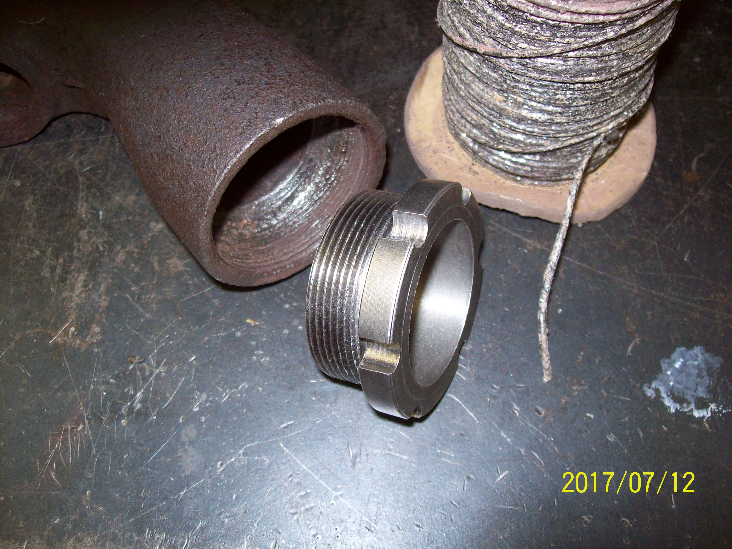

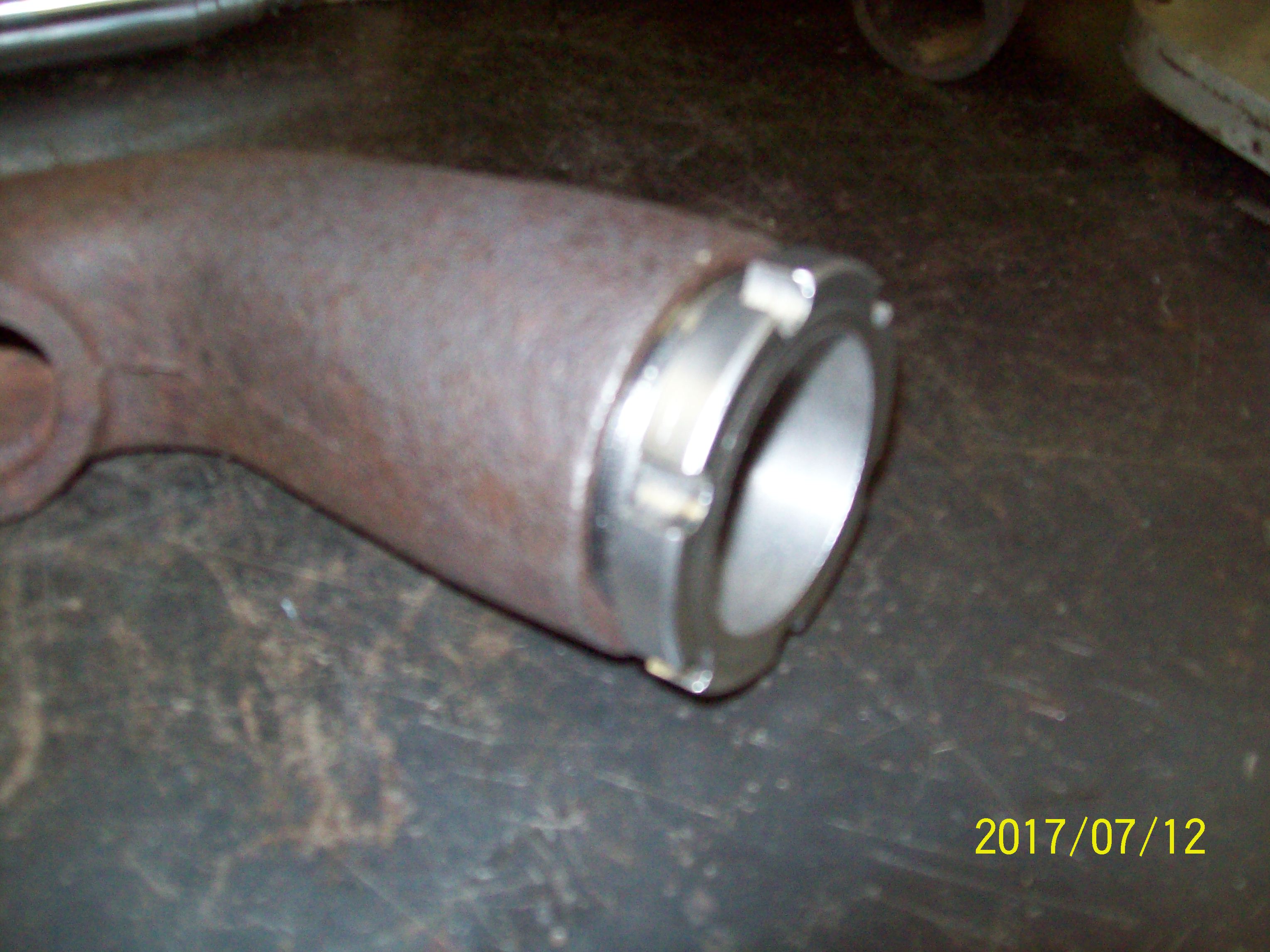

I went forward & cleaned the threads & packing area then made a new cast iron nut to suit the threads as they are now. Fortunately I have been picking up the evil asbestos packing any time I ran onto it for years & have a roll of asbestos string that should do the job.
Jack
