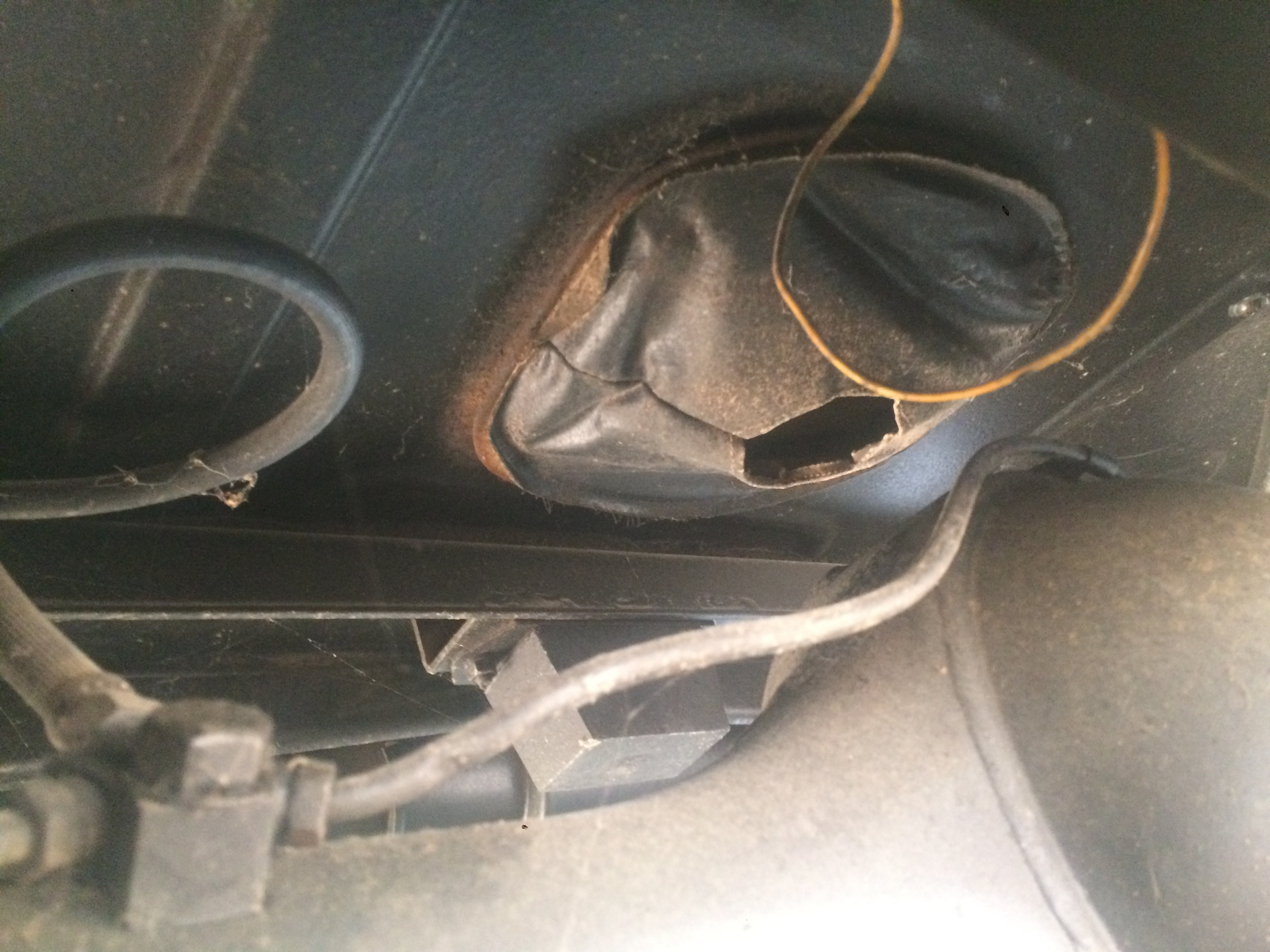

Hi, I'm wondering what engine oil you guys run in these older vehicles - I'm currently running 15w-40.Also I have attached a picture of an opening above the rear differential and am curious to what it's purpose might have been.

The opening is for ventilation, the fabric is a filter. Don't know why there is a hole in your filter, though.

I have the same vent filter in my 39 and I have the same cut out (hole). So far as oil I use Shell 10W 40 with Lucas oil additive.0

I would cover that hole too, I had mice get into mine and build a nest under the rear seat. Even if you pull the seat and place a board over the opening when in storage.0
