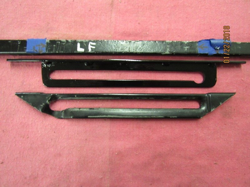

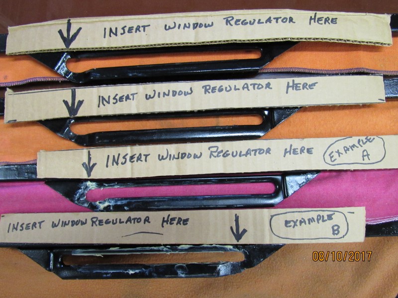

I only have one " example B " and I need another, to attach the left window regulator .
When I purchased the Essex , the left front window was broken and gone. An " example A ", was attached to the window regulator and I didn't know it was the wrong part. The photos below, show 3 right side pieces and one left. When I tried reassembling the regulators to the channel is when I first noticed something was not correct.

ESSEX28-1 , Thanks for your reply. I know shipping is high from N.Z., as I have already had a part shipped from there, by Geoff Clark. If you can give me an idea of the shipping plus the part costs, I'll consider it. If it's really high, it may not be worth it. Be sure it is for the left front door and looks like example "B" in the photo. Thanks very much, Sach.
