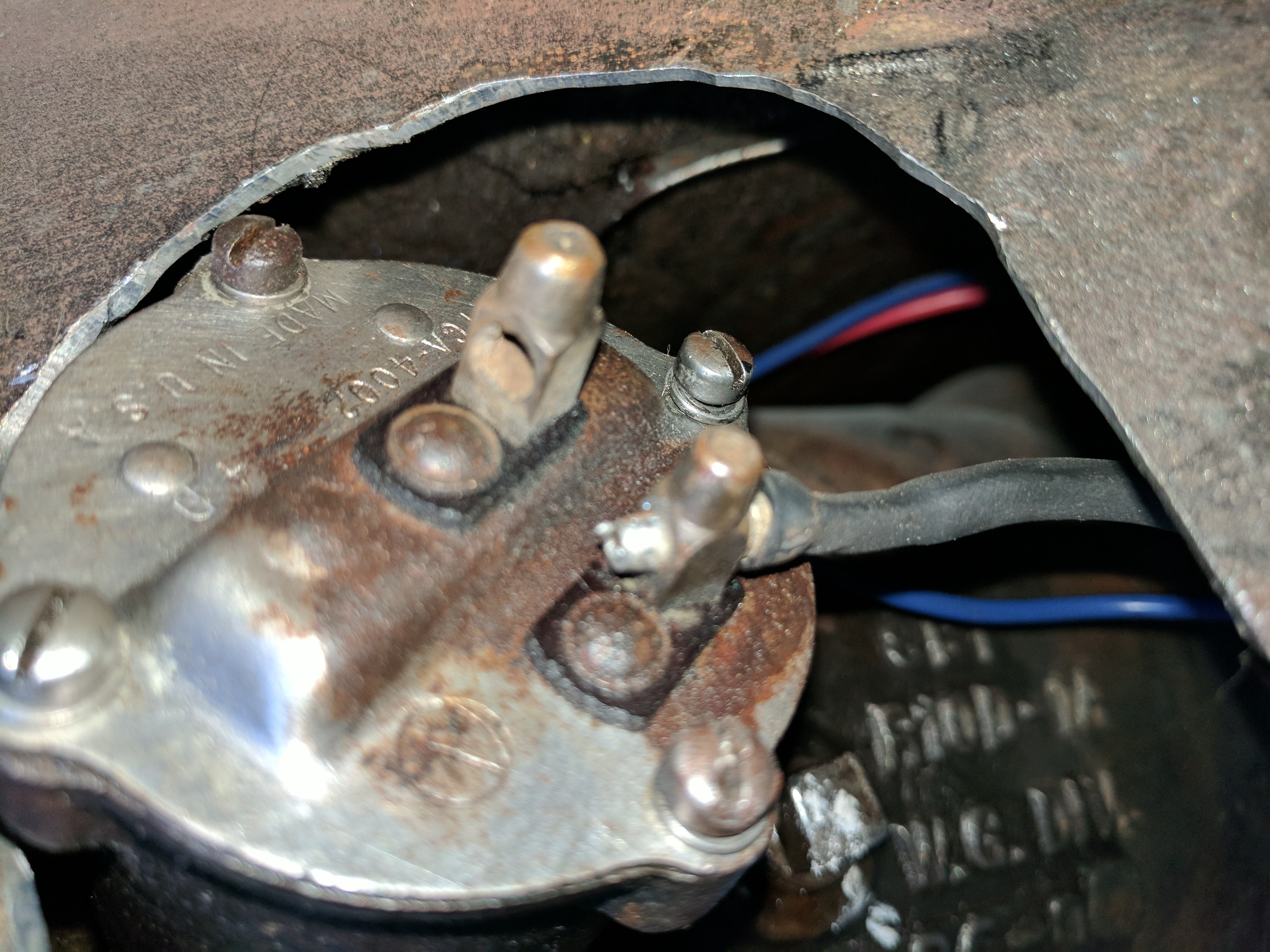

Ok Guys I have checked so far the travel of the lever at the trans when the knob is in the fully extend and pushed in fully positions. It does travel to the full distance. Here is the Gov. (centrifugal Switch?) where the wire comes in should I be able to move that by hand?0
Move WHAT by hand? Are you saying that the terminal on the switch is loose? Or that the wire is not secured to the terminal?0
the wire is secured but I can move the terminal0
The terminal would be "suspect", then. can you get the switch out to work on it? Perhaps if you remove the four screws around the perimeter of the cover, the cover can be removed and this will reveal what's going on inside the switch.

Val, why does one of the two terminals on the governor switch seem to have no wire attached to it?0
Val, I disconnected the terminals and remove the whole unit to empty the oil and clean up but yes the back cover needs to be removed.0
