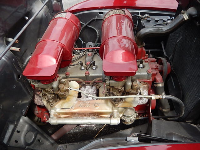

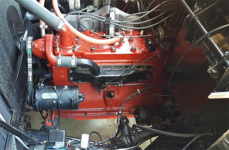

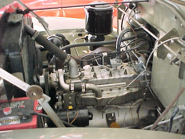

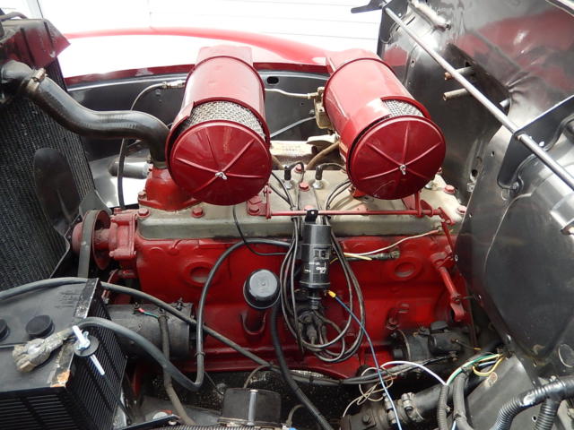

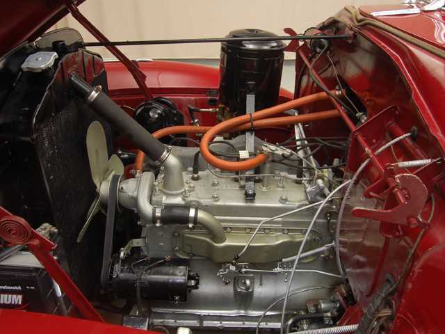

The following pictures were found on the INTERNET... represent where the original location for the battery... As JON B said ... many have hoods with battery welding scars due to the terminals contacting the hood....0
Thanks for your help guys, and I was looking at the clearance and I do not want to be anywhere close to the hood.0
Lance, If your going the 12 volt route? Use the GM type side terminal battery and that eliminates the hood shorting out problem. If sticking with 6 volts you may be able to put a rubber pad on top of the battery?0
