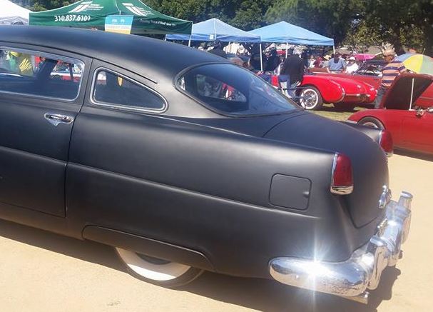

Anyone have driveshaft issues lowering Stepdown? put 2-3" drop blocks on my '54 Wasp and seems the driveshaft might be a bit compounded, already had it shortened once.
Please no comments about NOT lowering lol.
