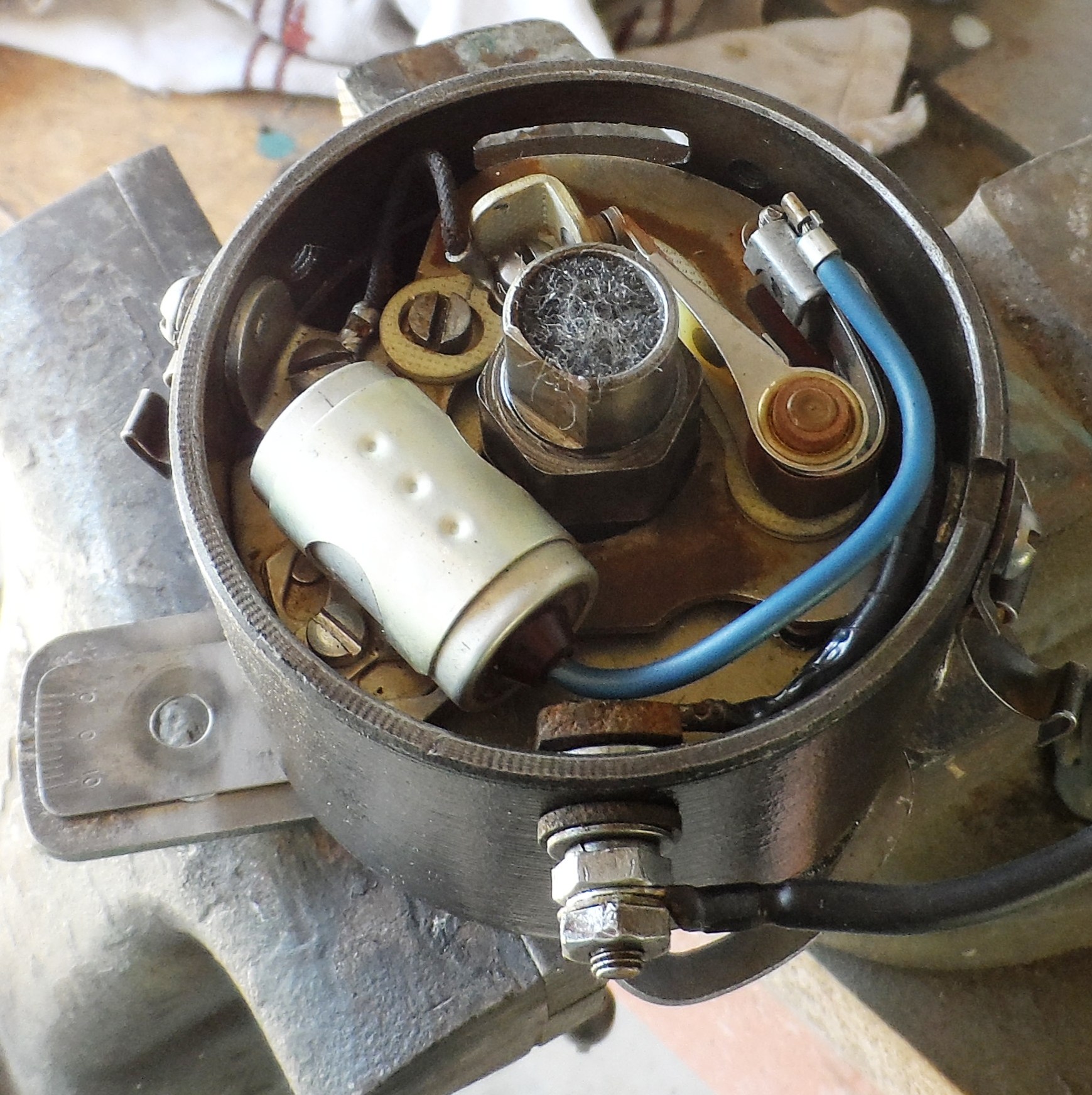

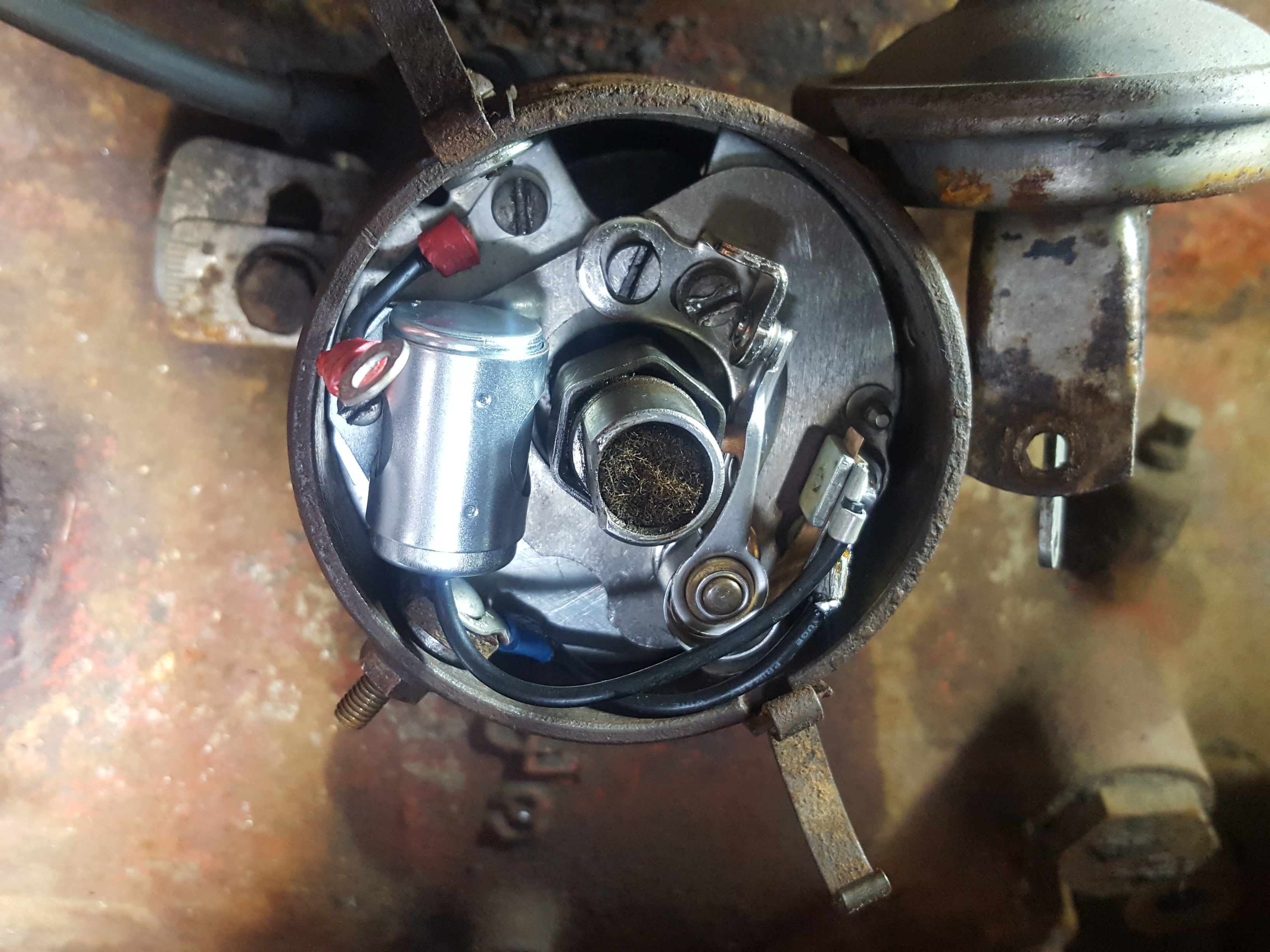

Ok should have taken a picture but had to rebuild both wires they were shot and now cant figure out where the smaller one co. Ected to and the diagram sucks anyone have a pic of how its supposed to be?? Here is where im at so far0
Pictures usually are easier than words. Expand picture size to see connections.
Perfect thats where i hoped it went hewwww0

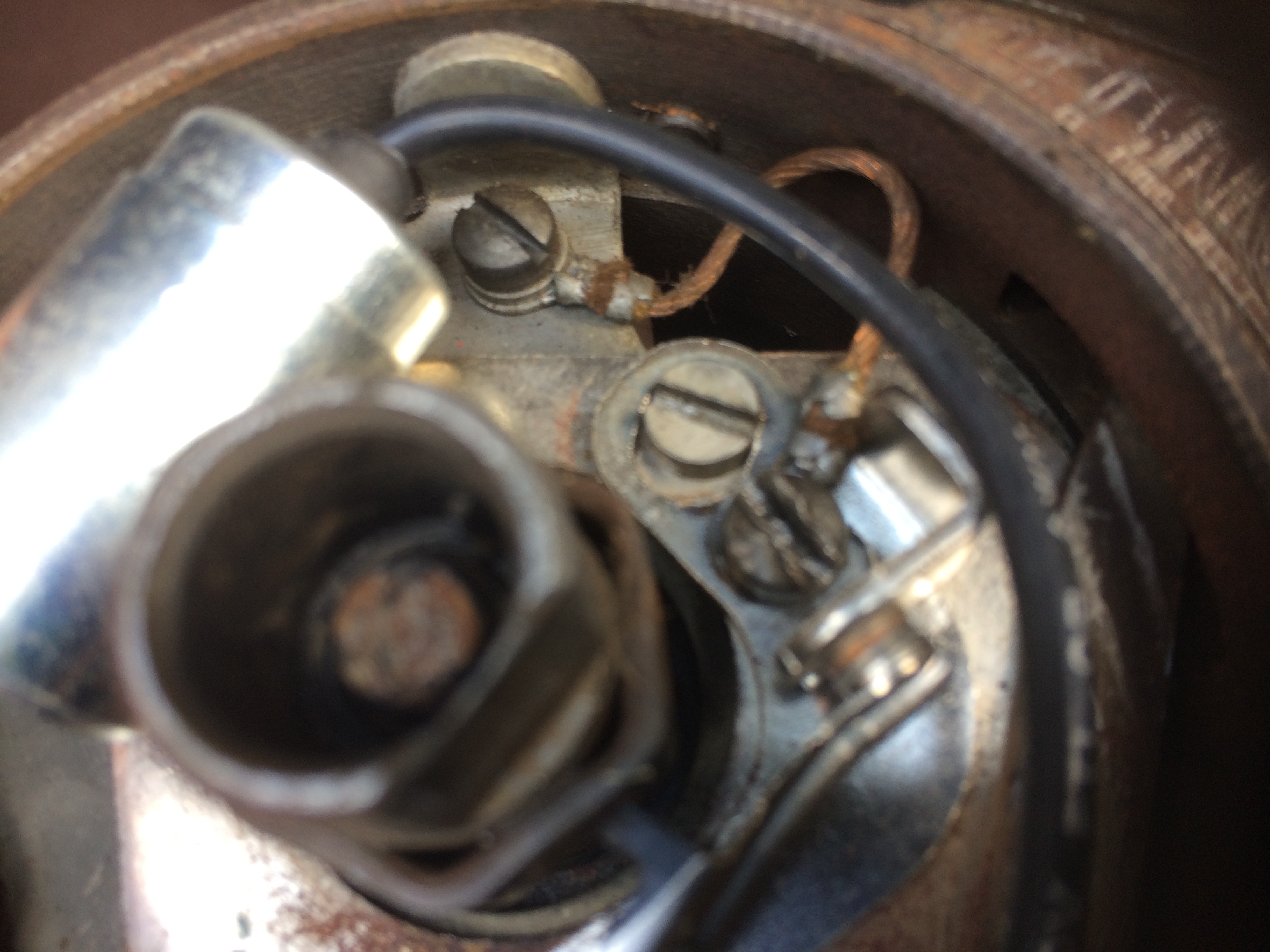

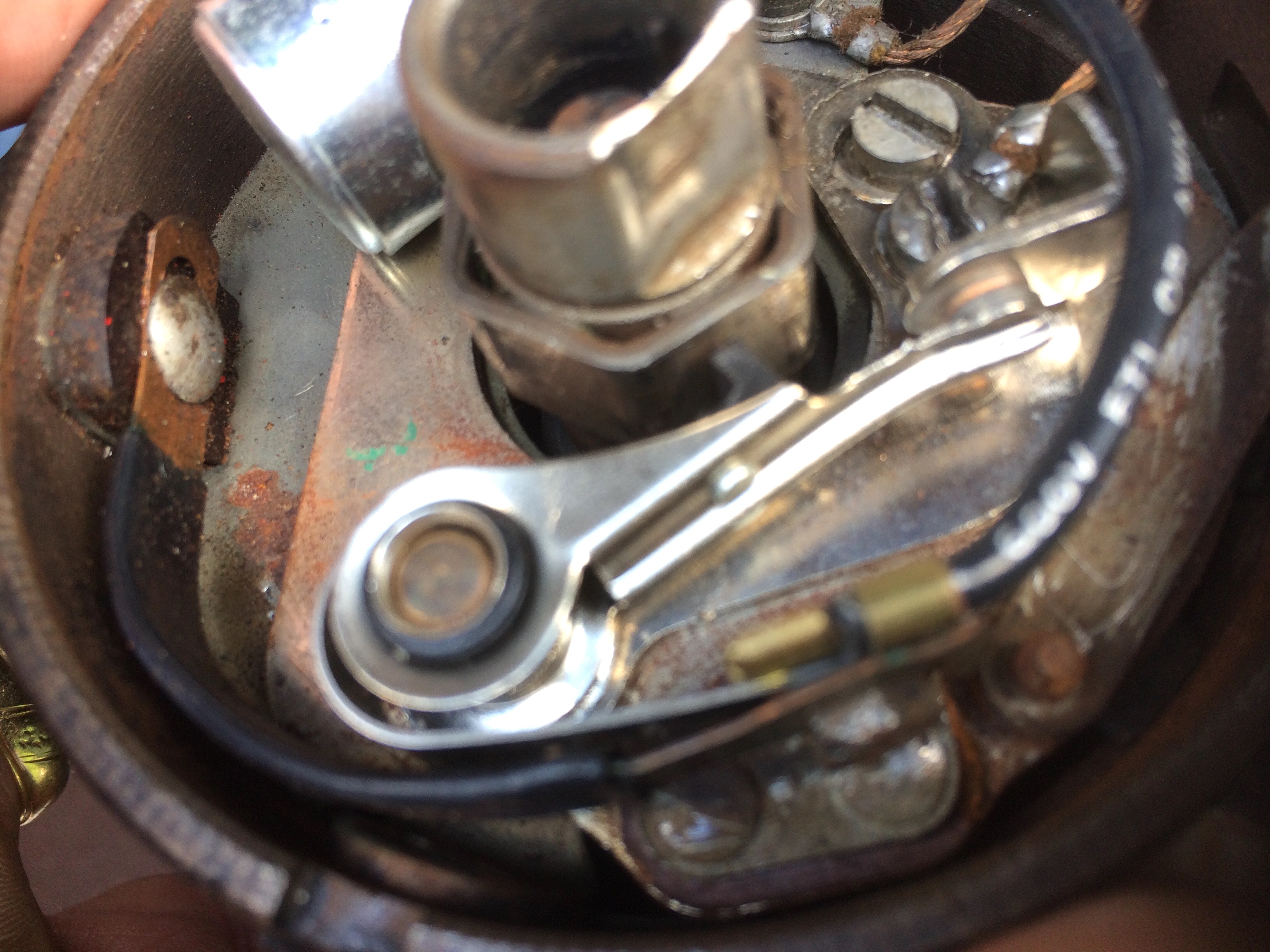

Old farmer is the wire coming from the points connected under or on top of the i side insulator? Looks like it is under making it contact with the housing....i have mine on top connecting to the screwOldfarmer1947gmailcom said:Pictures usually are easier than words. Expand picture size to see connections.
Your picture does not show the vacuum advance unit.0

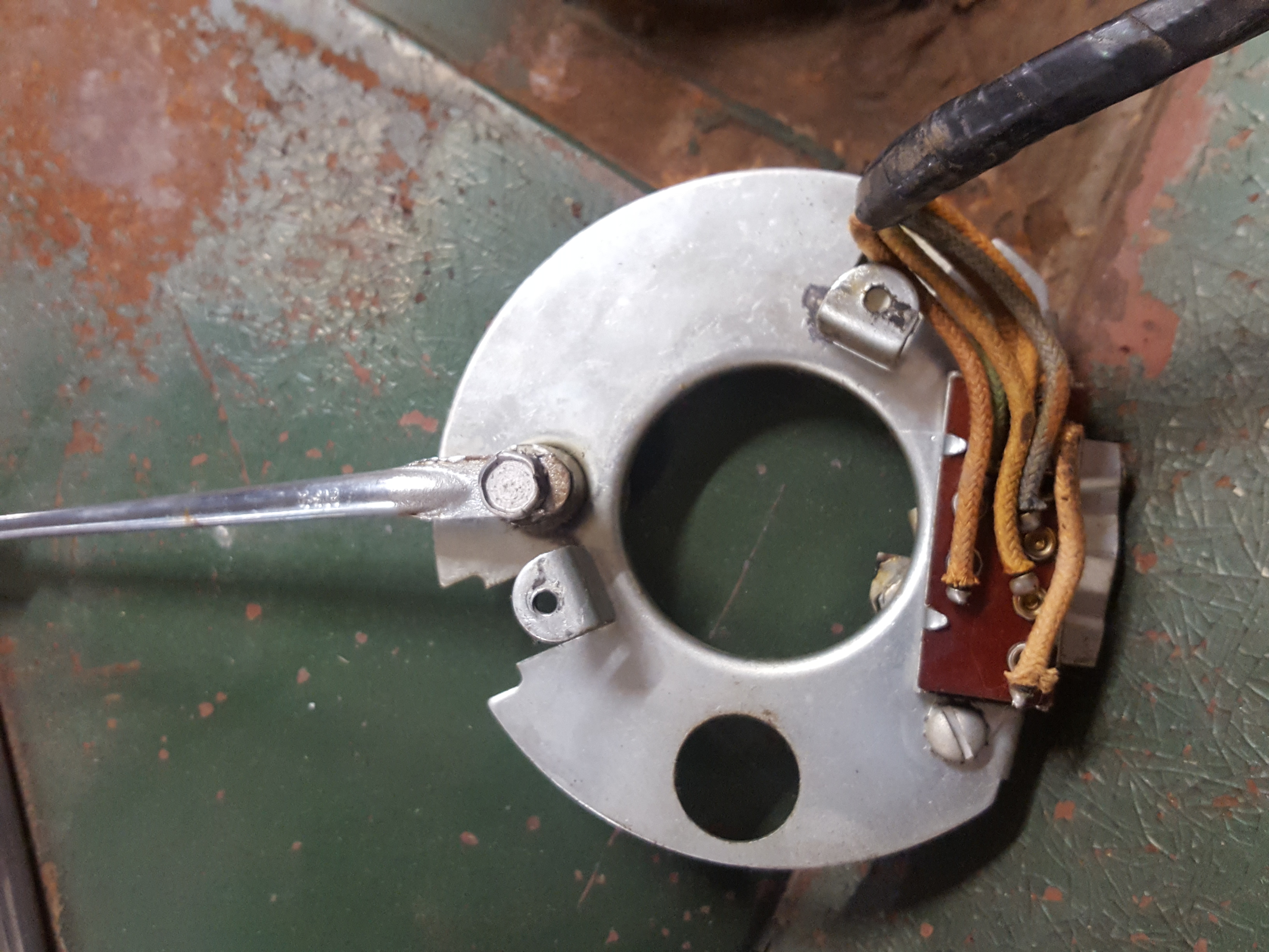

Yes positive 6v ground it was the economy harness from speedway motors I think I just got daunted by the massive amount of wires everywhere but I've almost got it now everything except for the last little bits of dash lights and not putting in my dimmer control for the headlights until after the new floor pans get here biggest question is the turn signal and flashers diagram for the Hudson only indicates two wires but looking at the indicator and the turn signal switch housing that I pulled out I've got what's attached in this picture not really sure which one does what0
