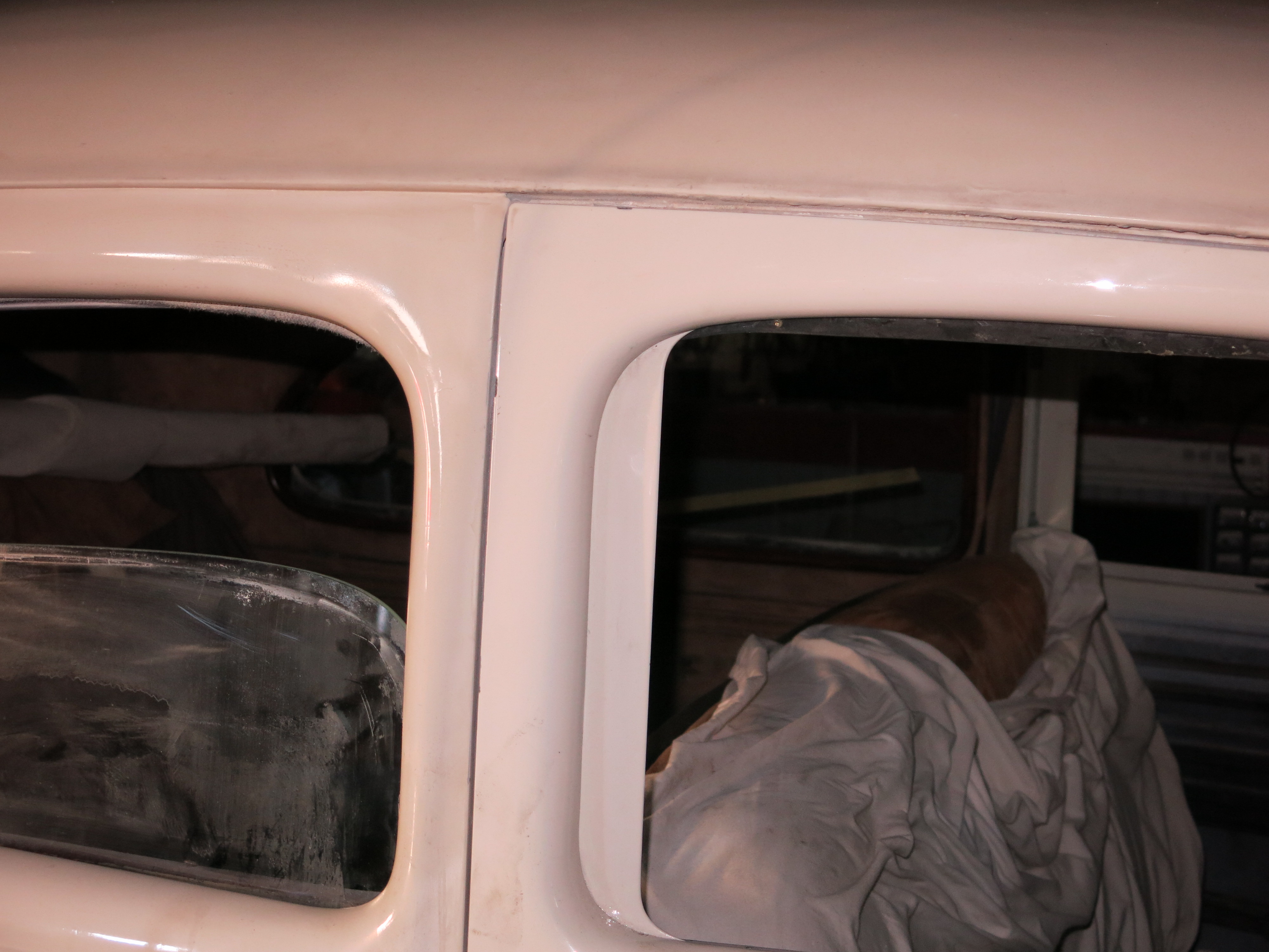

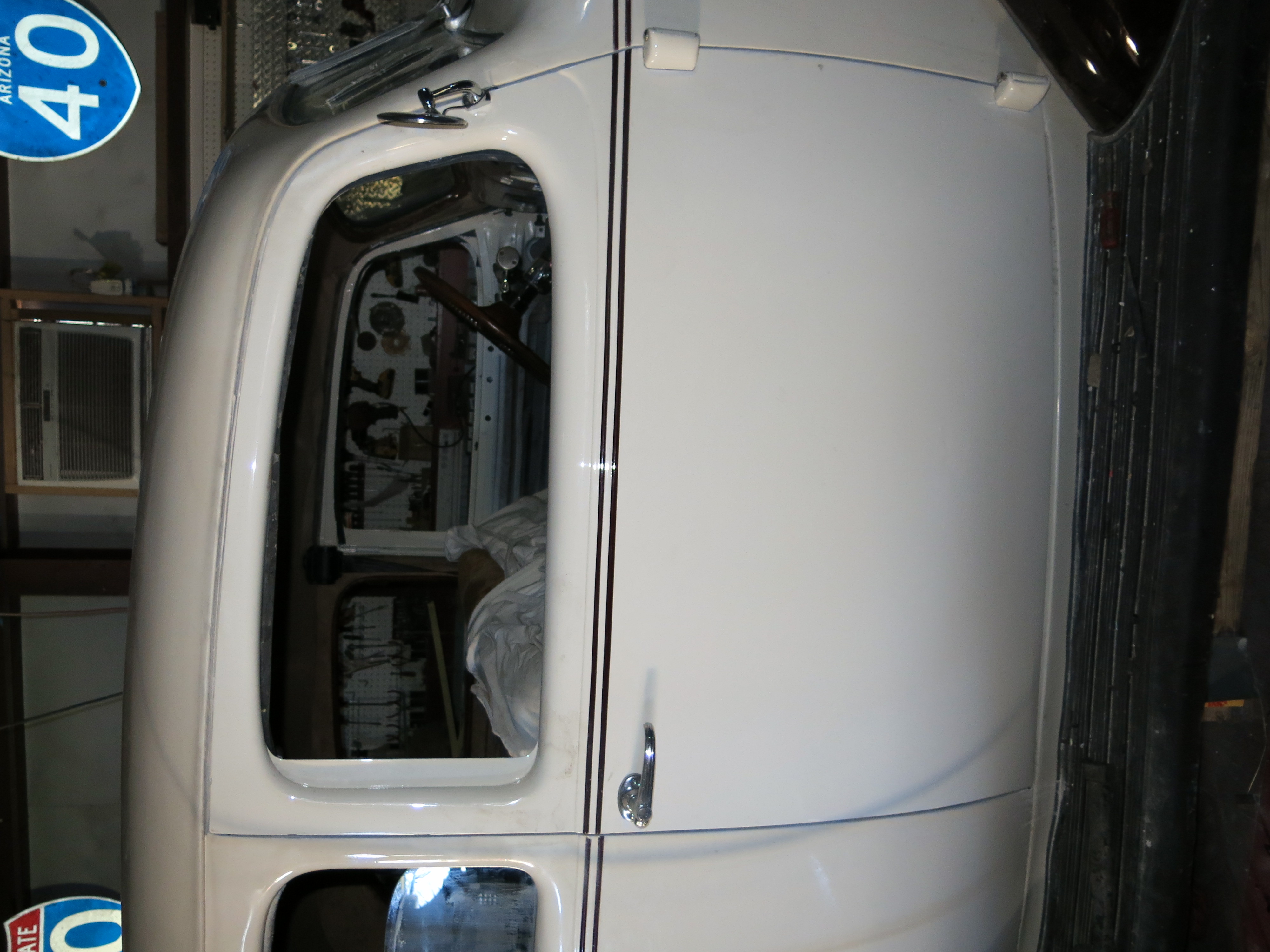

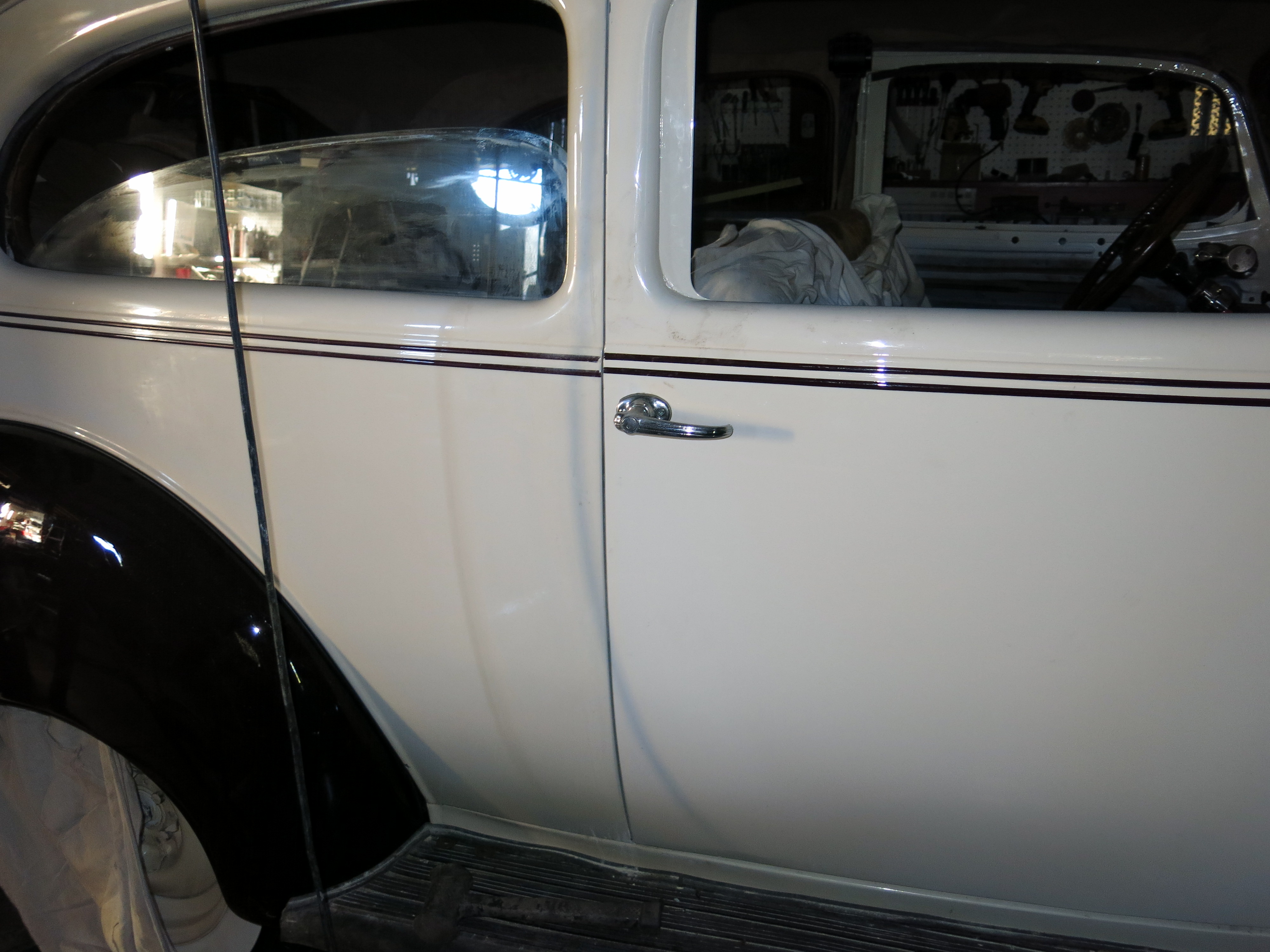

I am having problems aligning my doors on my 37 Terraplane. The top rear space is way too narrow the two lines down the side don’t line up the forward gab seems a bit wide. Looking at the Hudson manual only show adjustments with suicide doors. How do you make adjustments to line things up. And using what tools?

Here are some pictures to show what I was talking about as suggested
Hmmm! The rest of the gaps look pretty good so you cant just drop the door down. You might need to settle for taking the advice of KustomKreeps but be prepared to file that top gap so it fits without rubbing and of course, the door will need a paint touch up I'm afraid.0
The workshop manual shows how to do this adjustment, using hand and knee!0
Maybe the door frame is warped causing the skin to be out of true? If you cannot move the door I'd increase the width of the two lines and hide the fault from your eyes cheers Ken0
