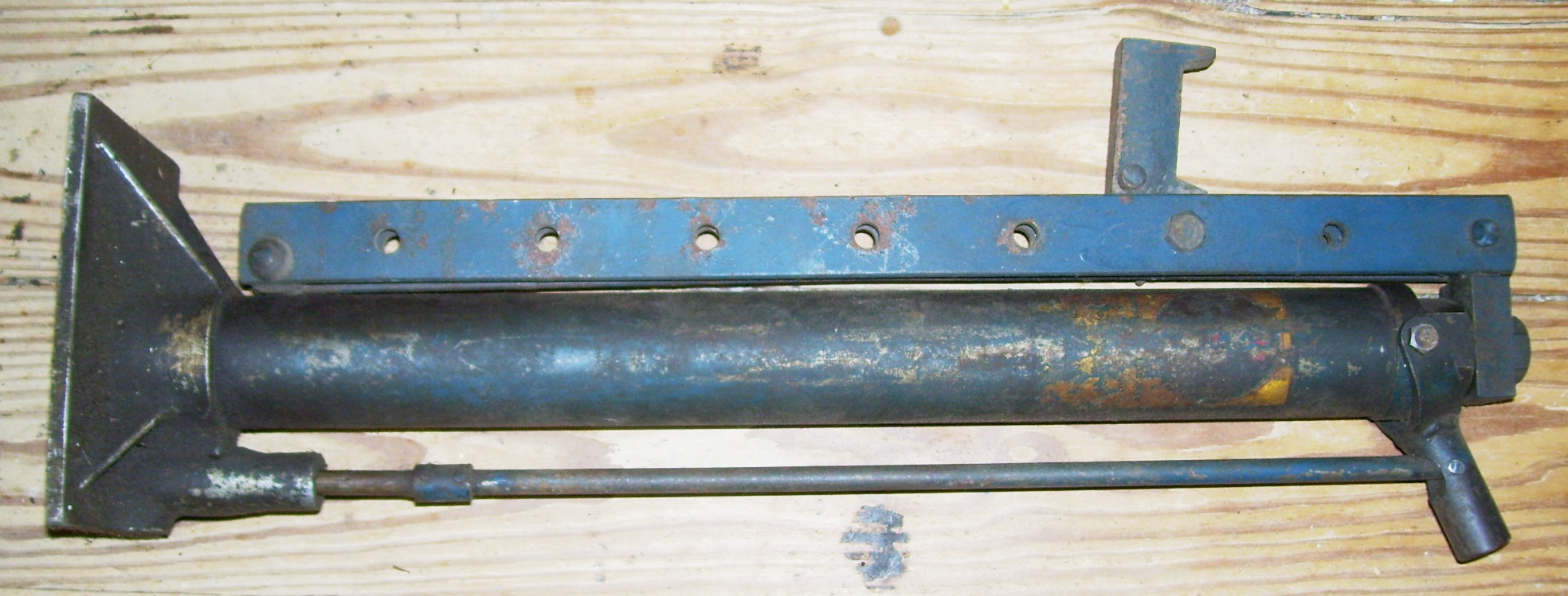

Ray, I Have the stand"U" shaped Hudson lug wrench if that works for you.0
Thanks Lance I have a spinner lug wrench but I need the diamentions to make a handle one end is machined down to fit inside the jack handle that pumps the jack and other end that has a slot to work the valve I need the length. Ray
I have a jack, I'll try to get a pic and dimensions tomorrow0

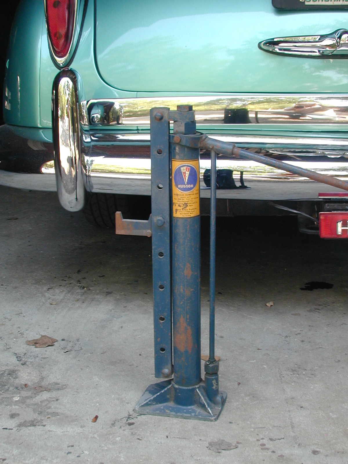

Uncle Josh could you also post a picture of the hydraulic jack to show me if I have the proper hook to put under bumpers. Thanks oldfarmer for your info. Hudsonly Ray

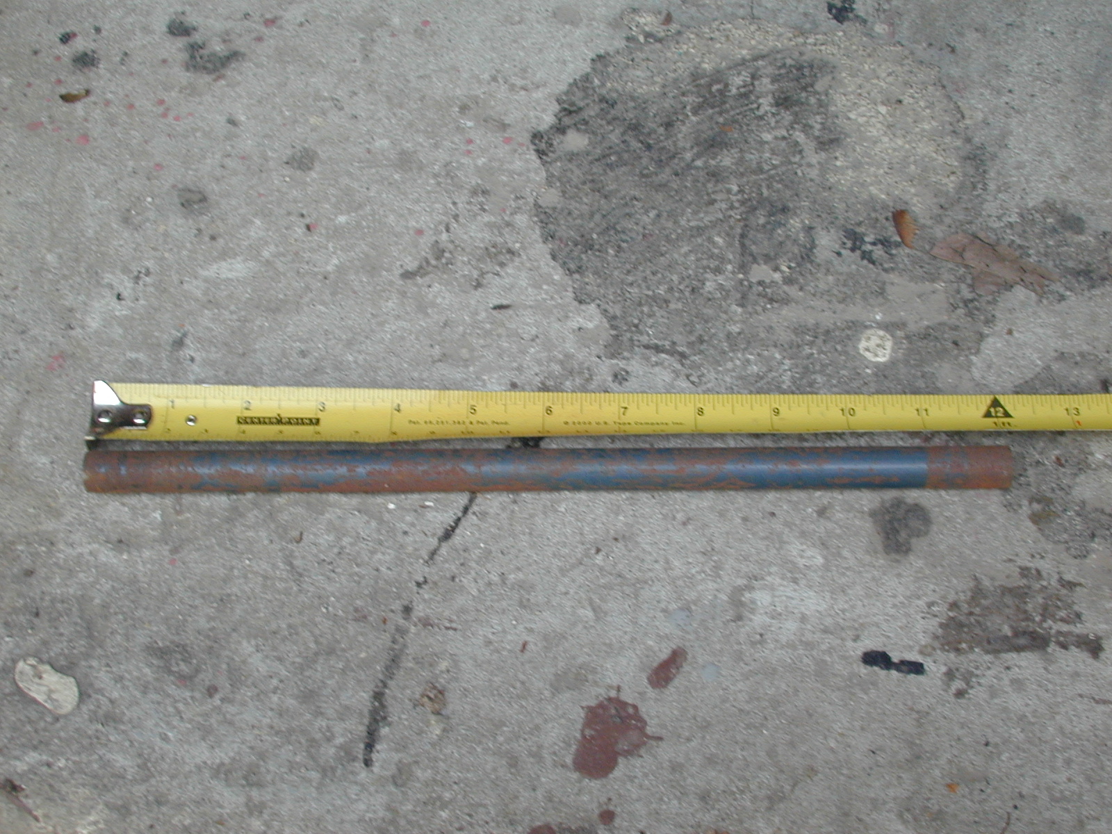

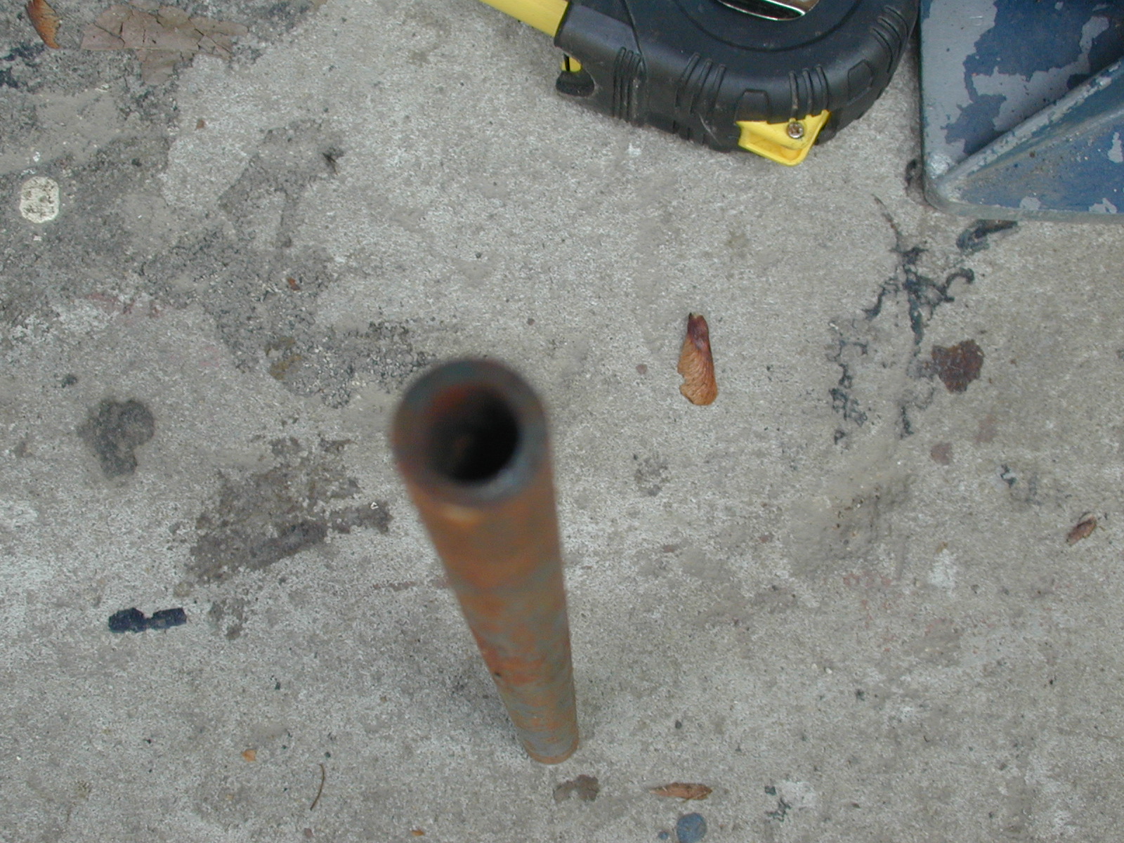

Well, my handle was not with it and it's too cold to look for it. The hole for the handle is 9/16 diameter (actual .570) by 1 1/4 deep. The pins on the valve are 5/32 dia and go thru a 9/32 rod. So a 3/16 slot with a 5/16 hole for the shaft would work good. If your handle were a foot long, it would work fine. The label, Paul Schuster aka Paul LARGETYPE email xxxHUDSON1957@AOL.COM (drop the xxx) is 2 x 3,1/2 inches and is positioned 1, 1/2 inches below the handle. You can just see my old one.
Thanks Uncle Josh The picture is exactly what I need and has the same hook as mine. We are having cold weather to 1 30celcius with a wind chill of - 40 celcius same as ferenheit
what size thickness is the handle before any machining. Thanks

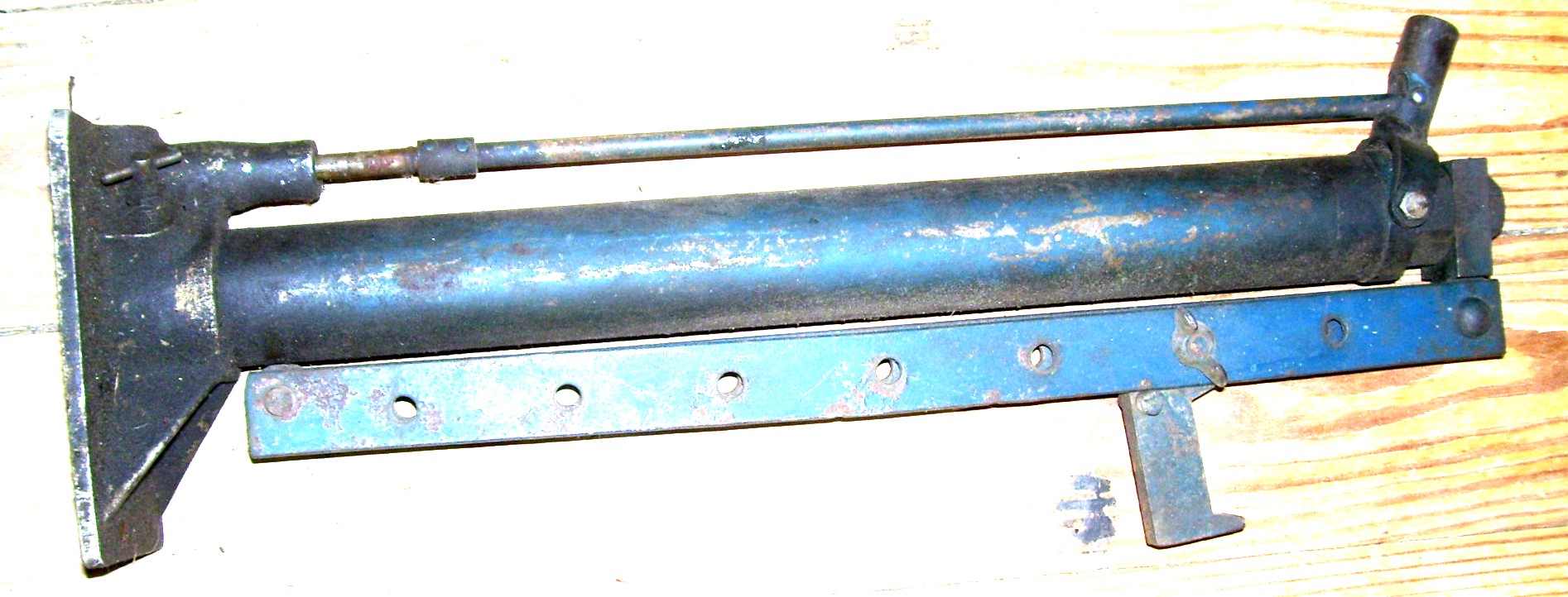

here is my old one
Thanks Dave!0
