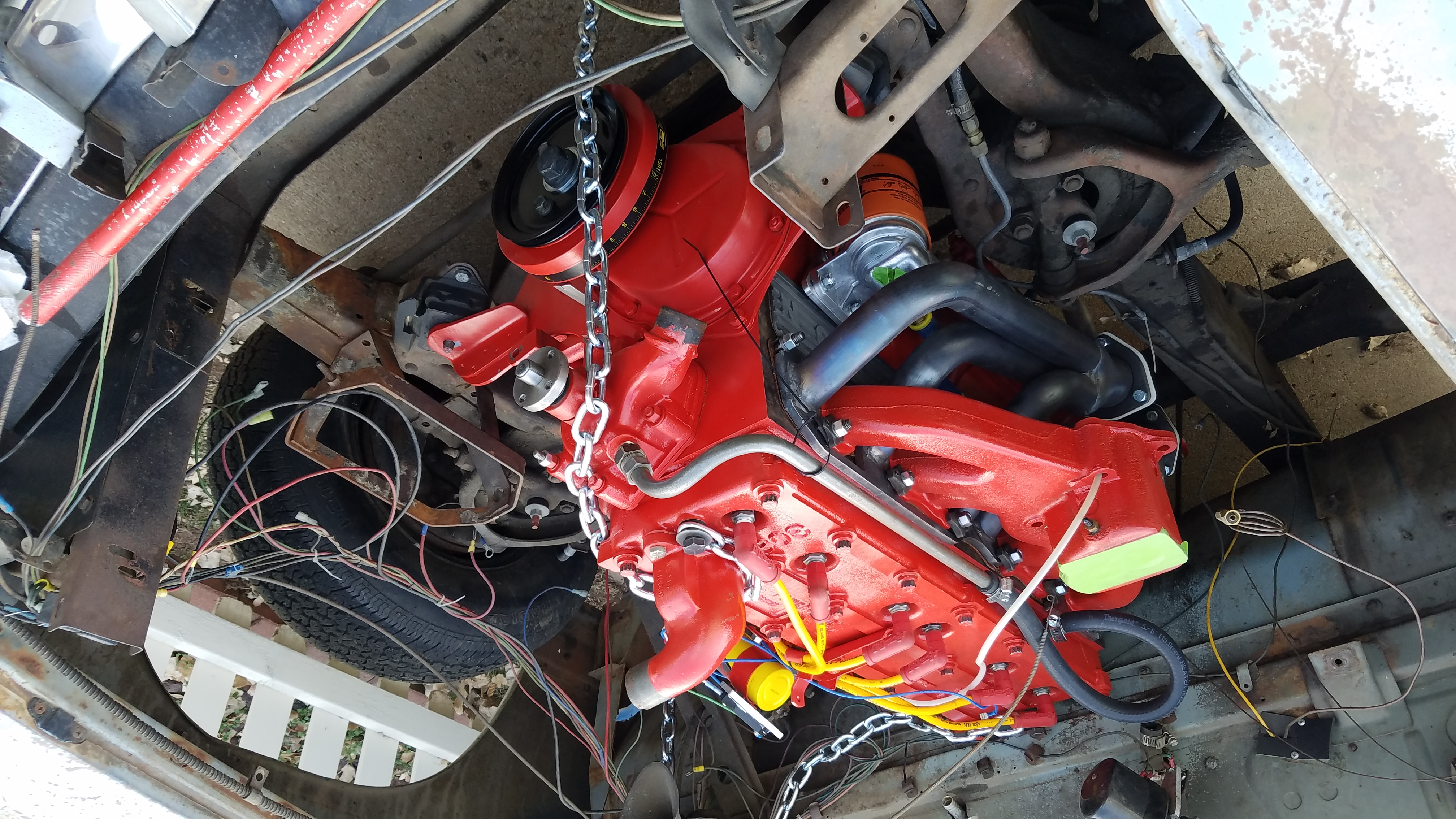

Blizzard warning... (engines in!)

Running a Hydramatic. I designed my lifter covers in cad and had my friend cut them out on our companies CNC several years ago. I hit them with the sandblaster to make look cast then snuck them in with a run of hard annodizing we had done.

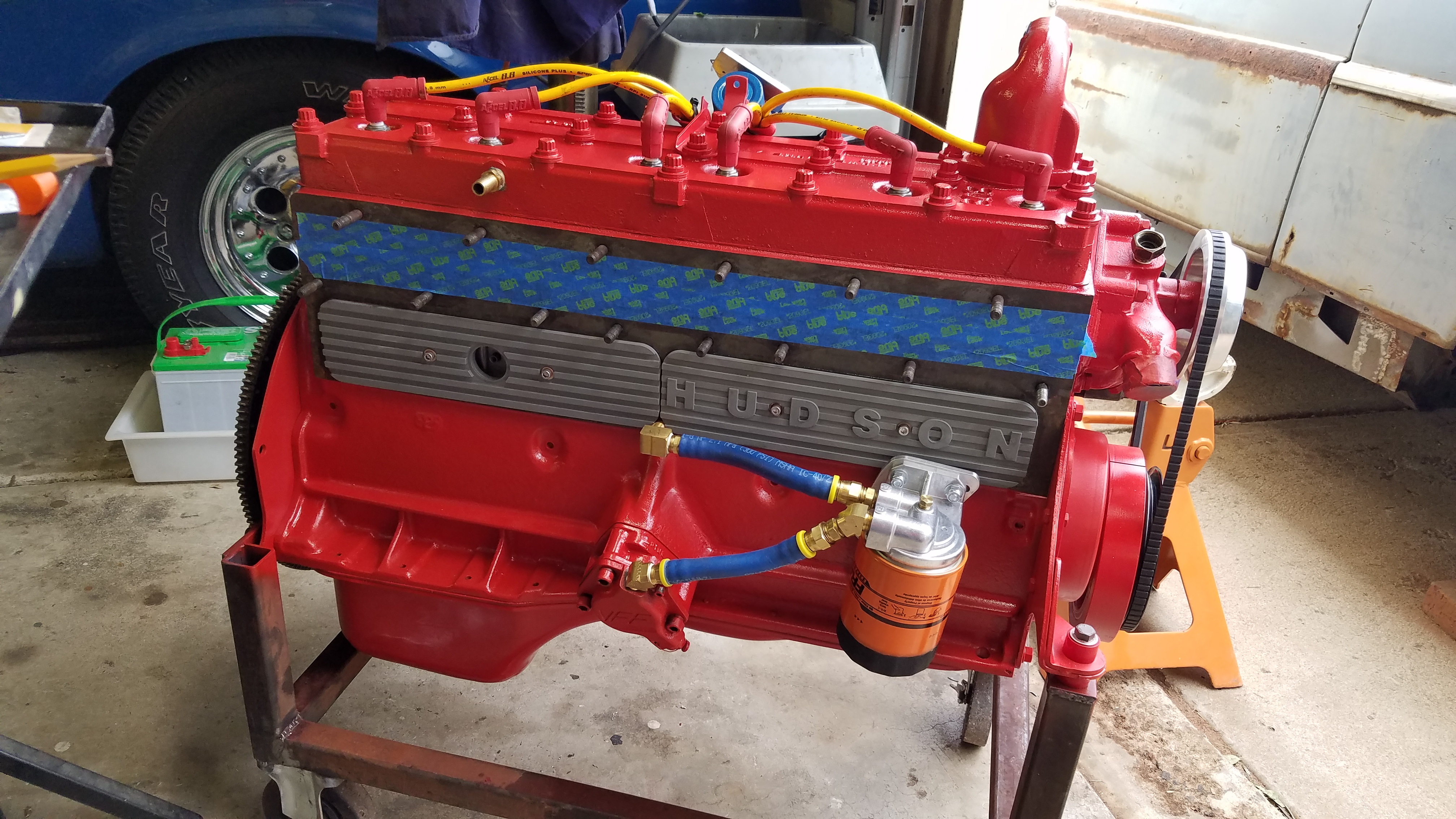

Makes me want to get back on my new 308 build!
All the parts are setting here done, just waiting for assembly.
What did you end up doing for the rod bolts?
I bought the 351C set and then my machine shop guy said it wasn't really worth it. Said the stock bolts were fine.
So he didn't do them.
I also got a 8" SBC dampner and just had the ID opened up to fit the Hudson crank.
A wanted pulley options and maybe a crank trigger for DIS later.

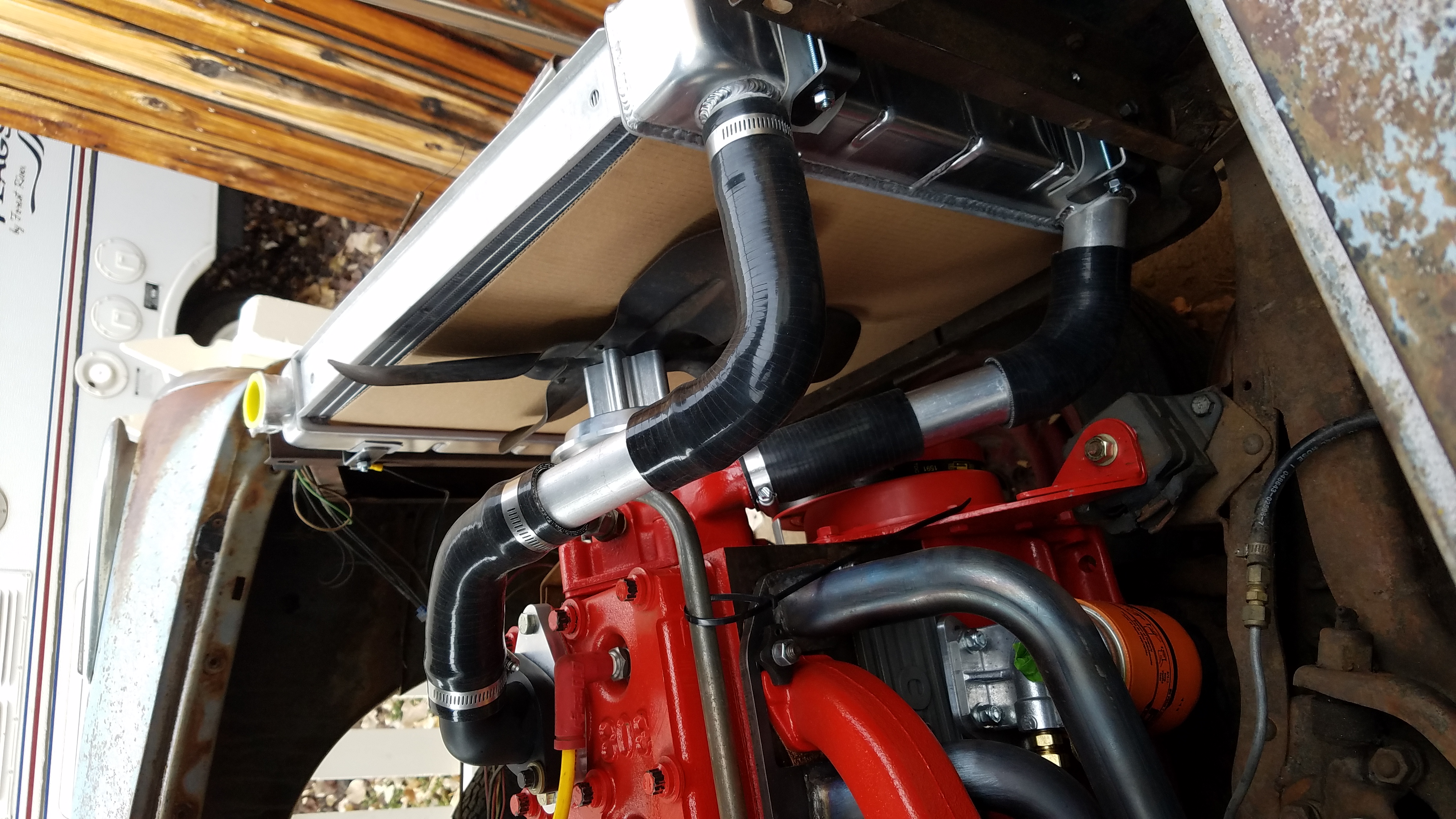

Haven't got to the radiator yet.0 -
Had Randy at 21st Century do the rods, original rod bolts. But did find new sheetmetal lock nuts from Aircraft Spruce.
Yup, 8" SBC dampener. That stupid water pump pulley cost a lot though... Actually for a Ford Performance 351W "short" water pump they don't support anymore. And I had to change the pump hub.0 -
