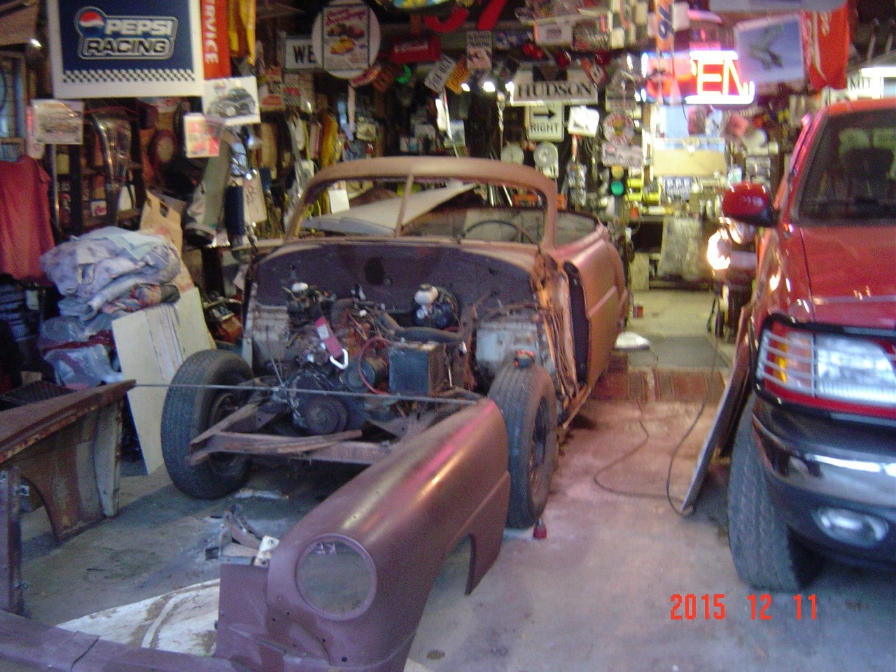

I picked up where I left off with a disc brake conversion kit, replace all the lines and now I'm trying to figure out what type of master cylinder to use and where to mount it. The kit says not to try to use the stock MC. Since it is very much a part of the original brake pedal, what did you folks who made the conversion do for the MC. Mounting it on the firewall has worked for others, I know, what kind of conversion to the pedal did you fellows make? Any suggestions or part #s?
The conversion kit looks very good and I want to finish it off with a quality MC setup...keith
