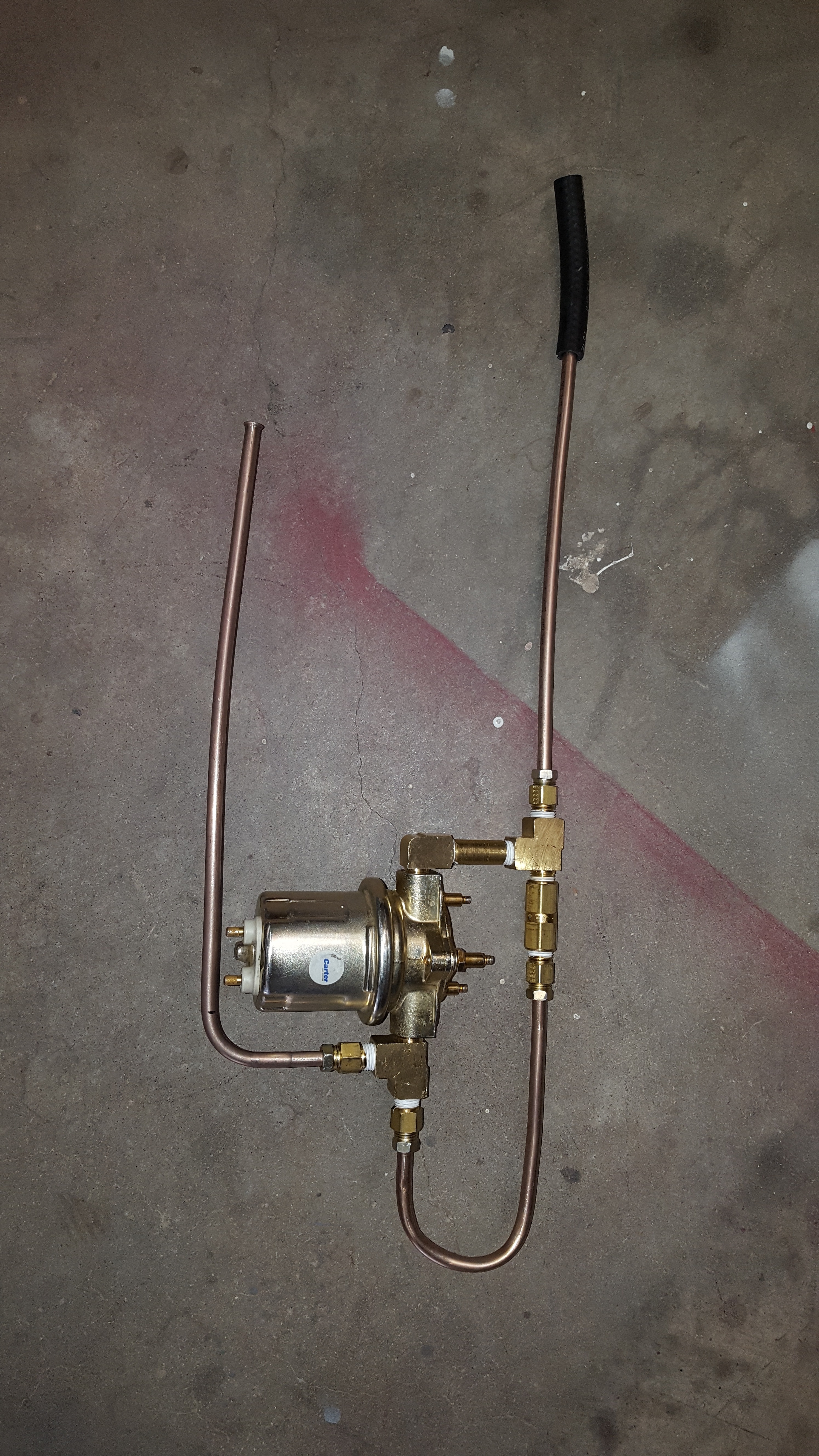

The Carter needs a bypass. Yes, it does flow through at low demand, but I used to starve my engine out on hard pulls. I ended up installing a bypass with a check valve to make it work the way it should (see image). Many places carry the Carter: Amazon, Summit Racing, Jegs, etc.The Packard Club had a thorough discussion on this topic and led me to the check valve I needed:https://www.packardclub.org/forum/viewtopic.php?f=8&t=4511&start=100
