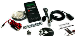

- i have an innovate LM-1 O2 sensor (discontinued, photo attached) which i use on all of my collector cars to check the mixture at idle and under load (up hill long stretches) - this data is invaluable to making sure the engine is not running lean

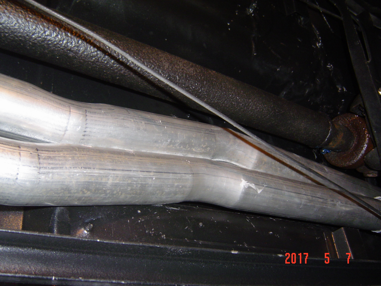

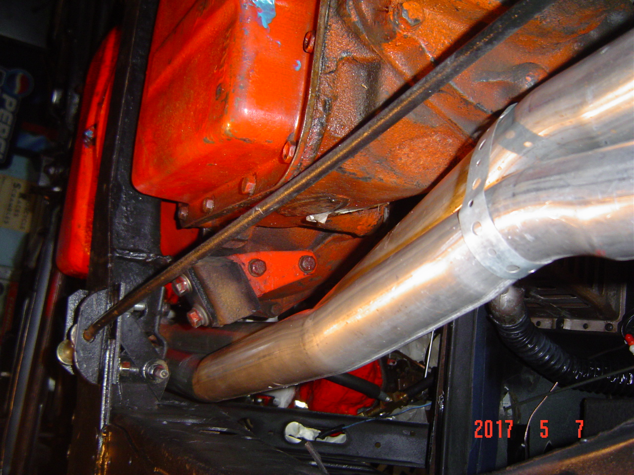

How else would you do it?? Here is my header/dual setup>>
https://goo.gl/photos/S9PG2unDdRhuKpPd80 -
Don't know if this will work: link to an earlier post I put up with pictures of my setup, since then I have modified the two side pipes to a single 2.5 out the rear.
https://openforum.hetclub.org/discussion/comment/206385#Comment_2063850 -
