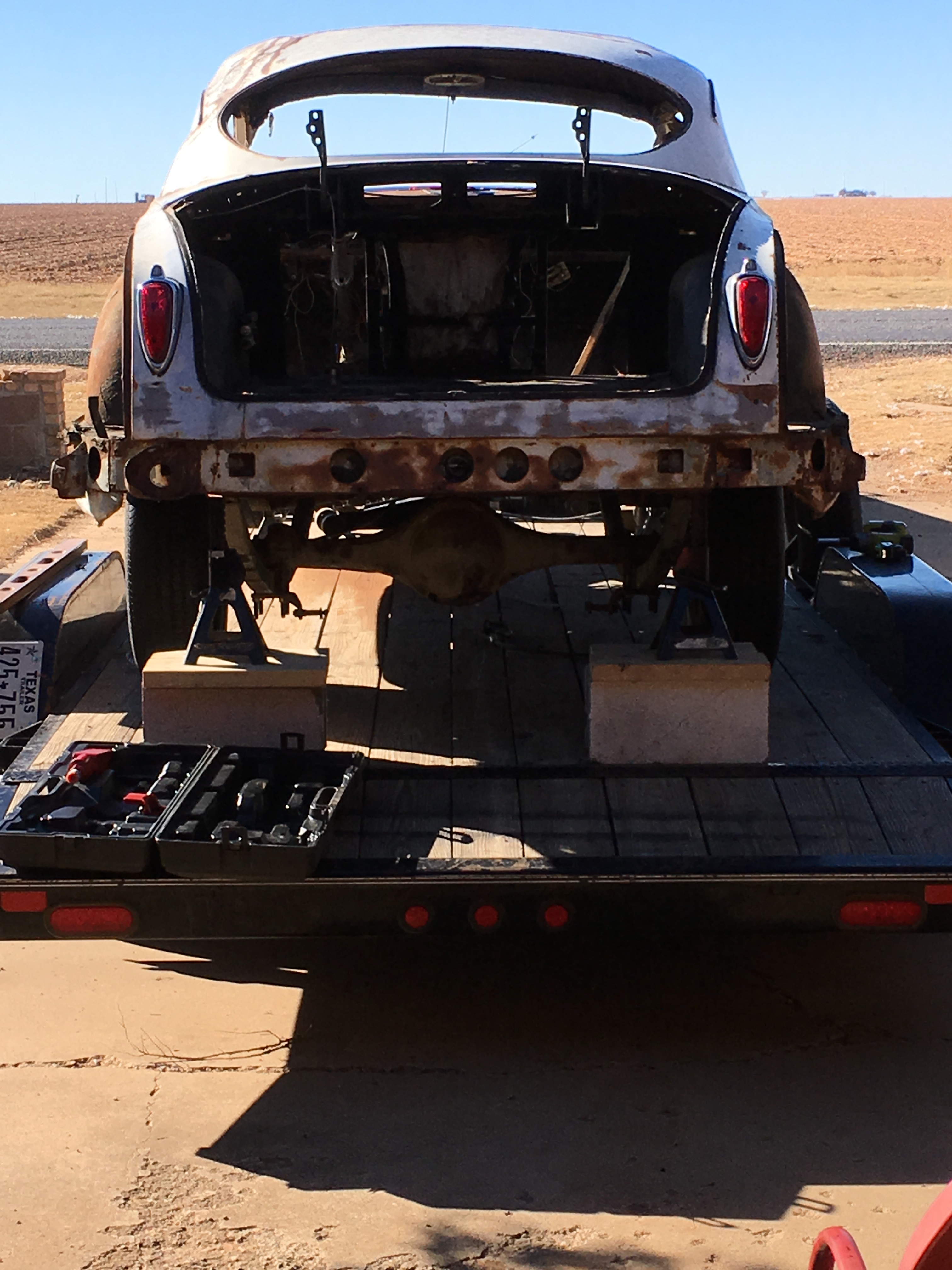

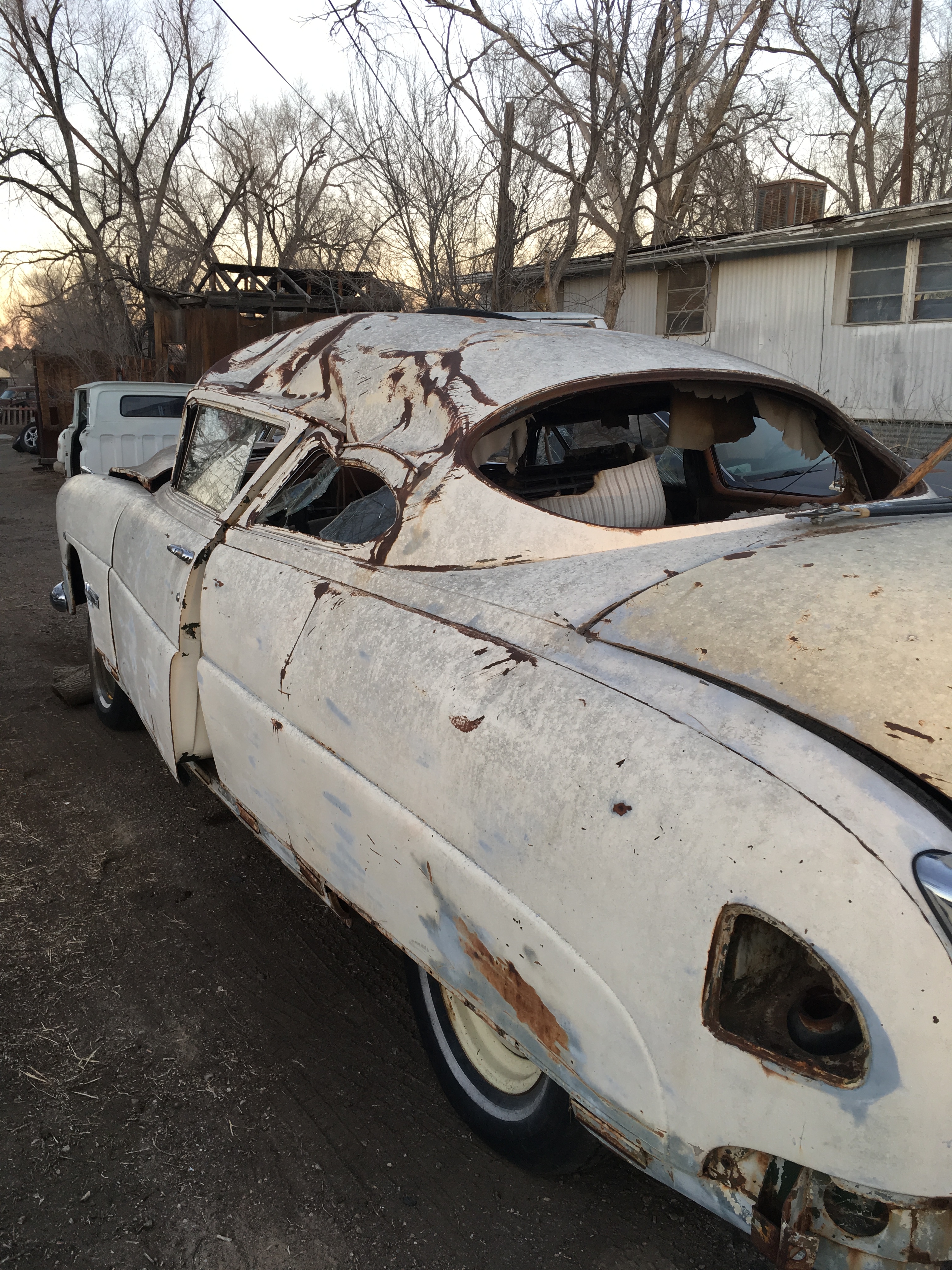

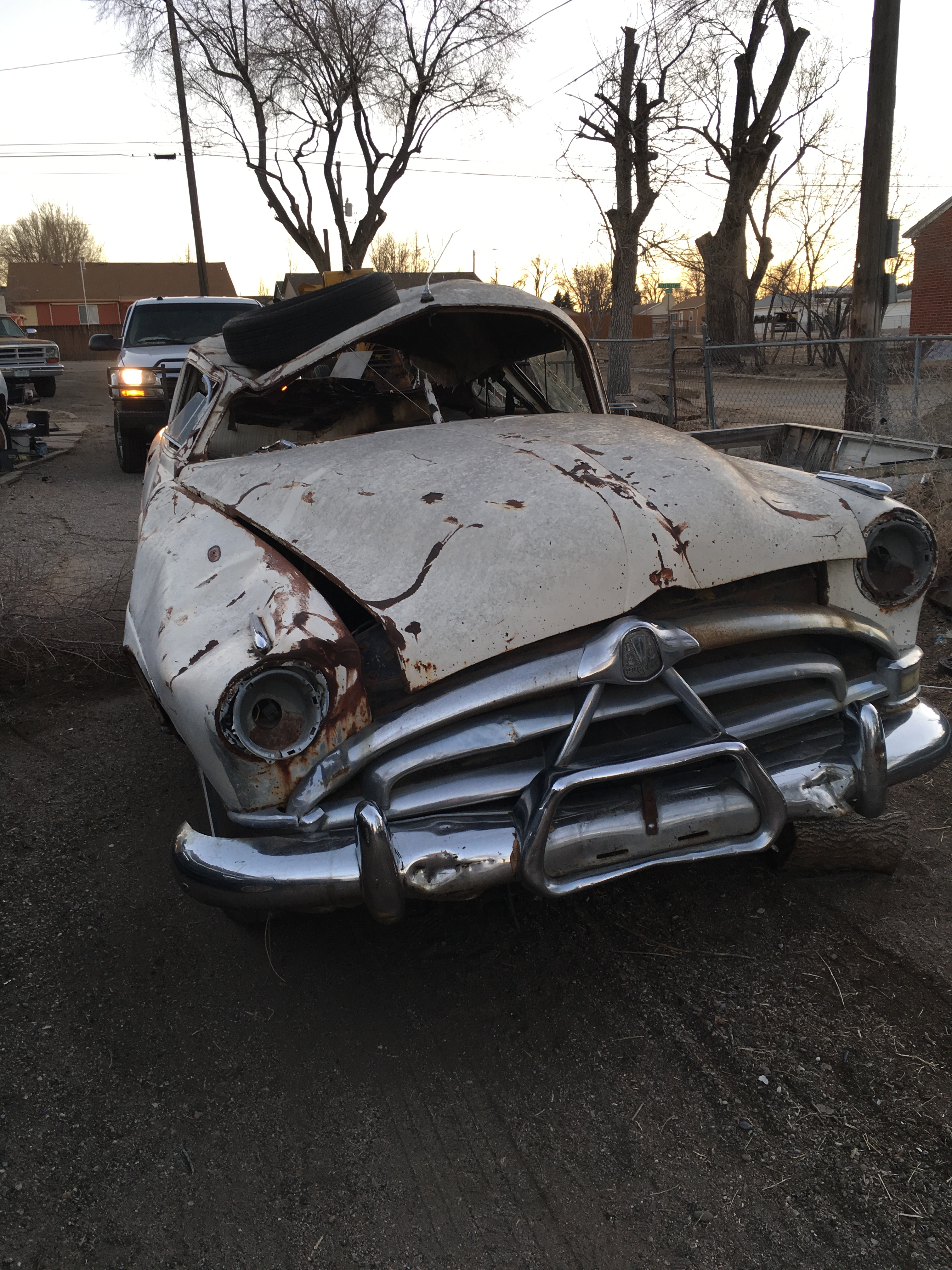

A lot of good comments guys thank you, I am committed to not letting this car die, I have all the time in the world and can’t let this car go by the wayside, money won’t be an issue as I will be doing 90% of this myself. I do understand about forgetting this one and moving on, but I am way to attached to cars so onward I will go. As you can see no rear damage and no twist anymore to the body after I used a Porta Power, just the roof sagging. I wanted it as straight as possible before separating and for sure will have everything braced

Cheyenne7172, Thanks for the kind words, your car looks a lot better already with the roof pushed up a little. 49 Super Six looks like a worthwhile project as well. Post up some pics of the coupe parts car if if you get a chance, we can't get enough of the old Hudson projects around here.0
