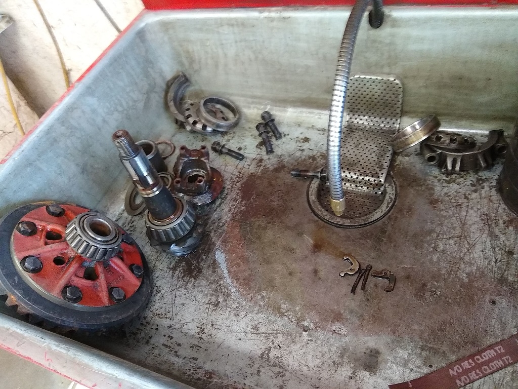

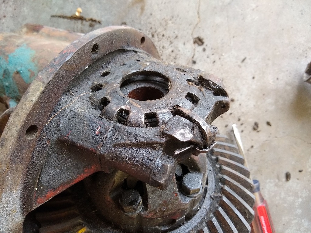

While I was on my adventure of the past couple weeks, I stopped at that place in Campbell CA and bought a 4.1 ratio rear third member. It had been sitting in a machine shop for decades, although it appears it was removed at a junkyard (torched off U joint U bolts). I marked the caps and adjusters, and took it apart, and cleaned things up. I removed the pinion seal and ordered a new one, as well as ordering a gasket. I'll wait for parts before I put it back together. The ring gear was stamped with the ratio and date, 4 1/10 and 10 50. It's replacing the 4.56 that's in my 51 Hornet now.

This was an old machine shop, it was mostly cleaned out...but still a lot of "stuff" left, including esoteric stuff like a piston grinder, etc. There were not a lot of Hudson parts, but he still had a straight 8 engine, and a few transmissions. I think he had them priced a bit too high.A few more pics, I put it back together. I got a pinion seal 450087 from rockauto, it seems to fit just fine.
