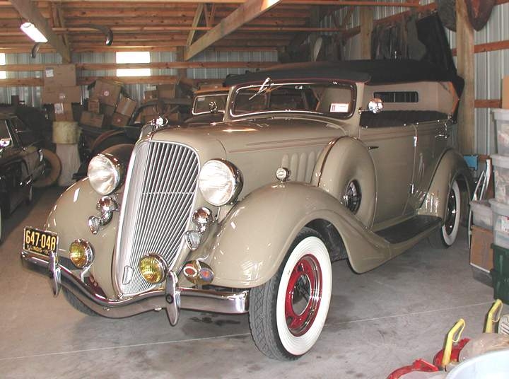

Anytime I have made inquiries about 34 T bumper parts I get little or no responses. Nobody knows anything about the Terraplane bumper guards with the hexagons? Nobody has any or knows where to get any?
I know they exist - couple pictures attached.

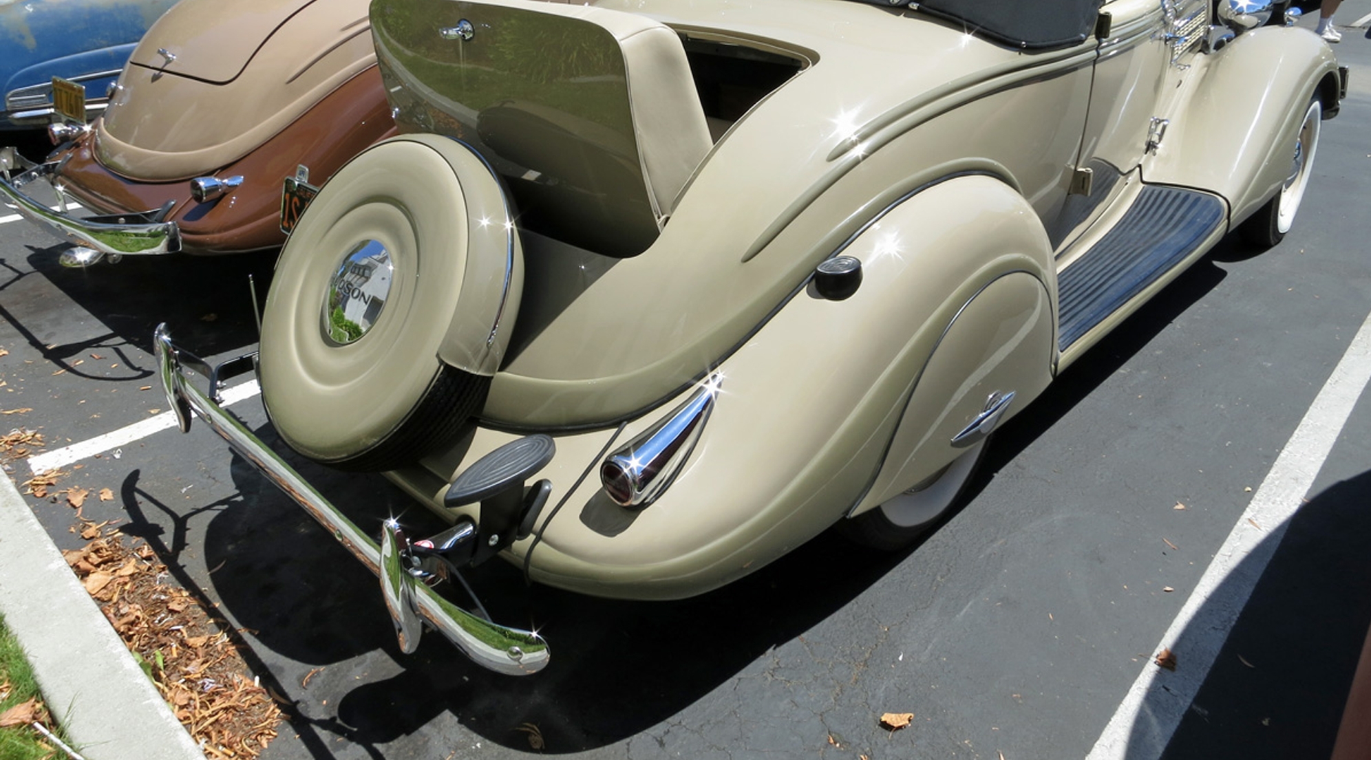

I need to look at the 3 bumper guards I have to see if there is a difference in the shape. That is, how did the top-to-bottom shape/profile of 34T bumper and 34H bumper compare to each other, and to 35T and 35H? If the bumper shapes are all the same, then it may be relatively easy to get the shape cast in either plain, triangle, or hexagon.
I know there was some difference in the overall shape - at least of the bumper ends. ...as can be seen on photo of my 34T parked next to a 35H. Curved ends on the 35H bumper. Maybe those plain 35H guards won't even fit on a 34T bumper?0 -
Sorry, I can't give you that detail.
Geoff; I think we can say that the top-to-bottom profiles of 1934 and 1935 bumpers are different. My brother and I were looking closely at the 34T bumper to see where the plain bumper guards (1935) would fit - they did not seem to fit well anywhere, front or back. I noted also that "35 Hudson" is written on the bracket in felt pen. Especially troublesome were the attachment brackets that go around the back of the bumper - even if you find a spot where the profile in the bumper guard is close, the brackets were not correctly angled to hold the guard to the bumper. You could probably get close by doing some bending on the brackets, but I'd say they do not fit on a 34T. The one thing I stupidly did not do was take the 34 Hudson guard with me to see if that profile and bracket was right on the 34T.
So, sometimes your EBay finds are duds. I have 3 brackets for Hudsons and none for Terraplane.0 -

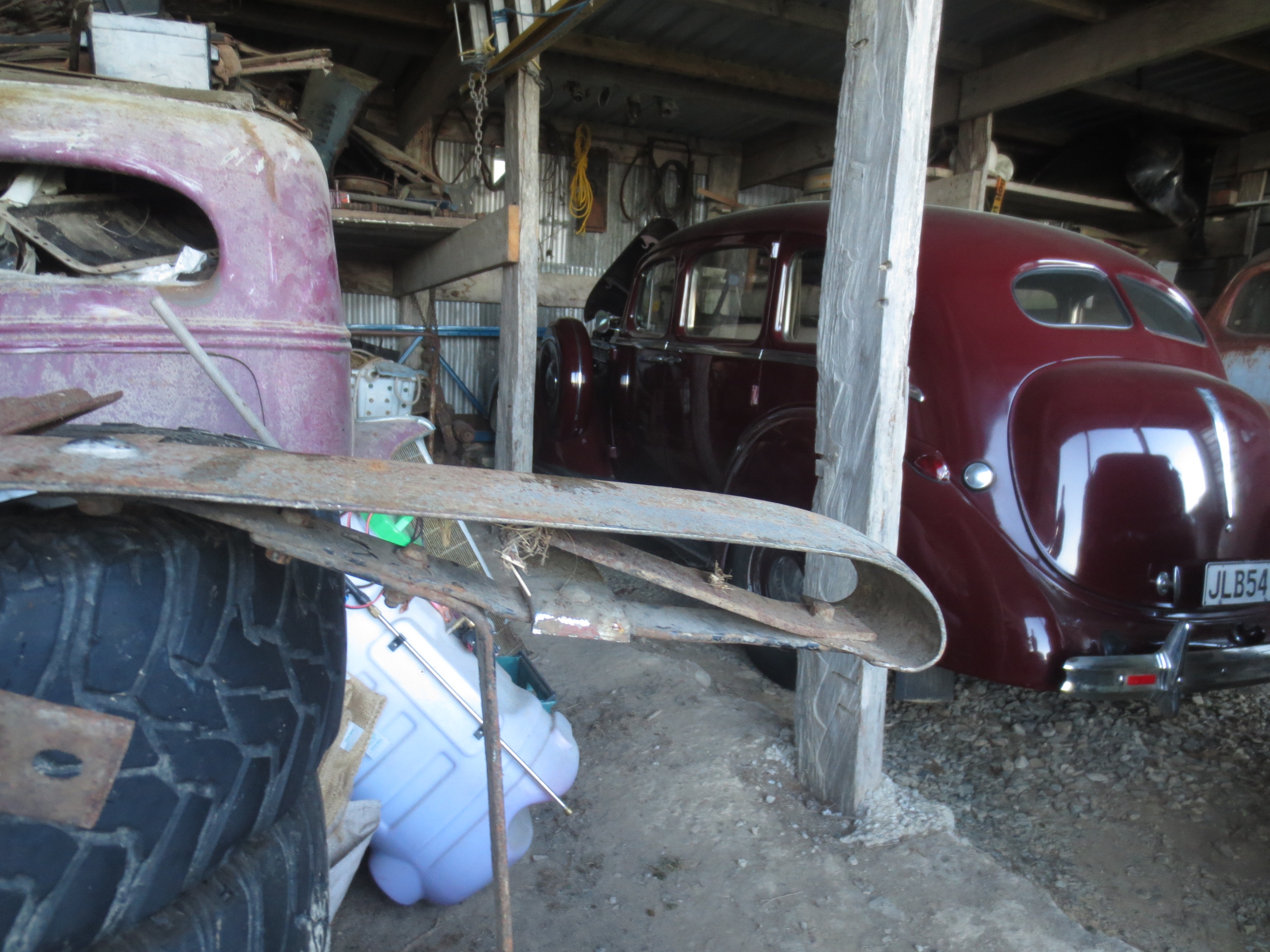

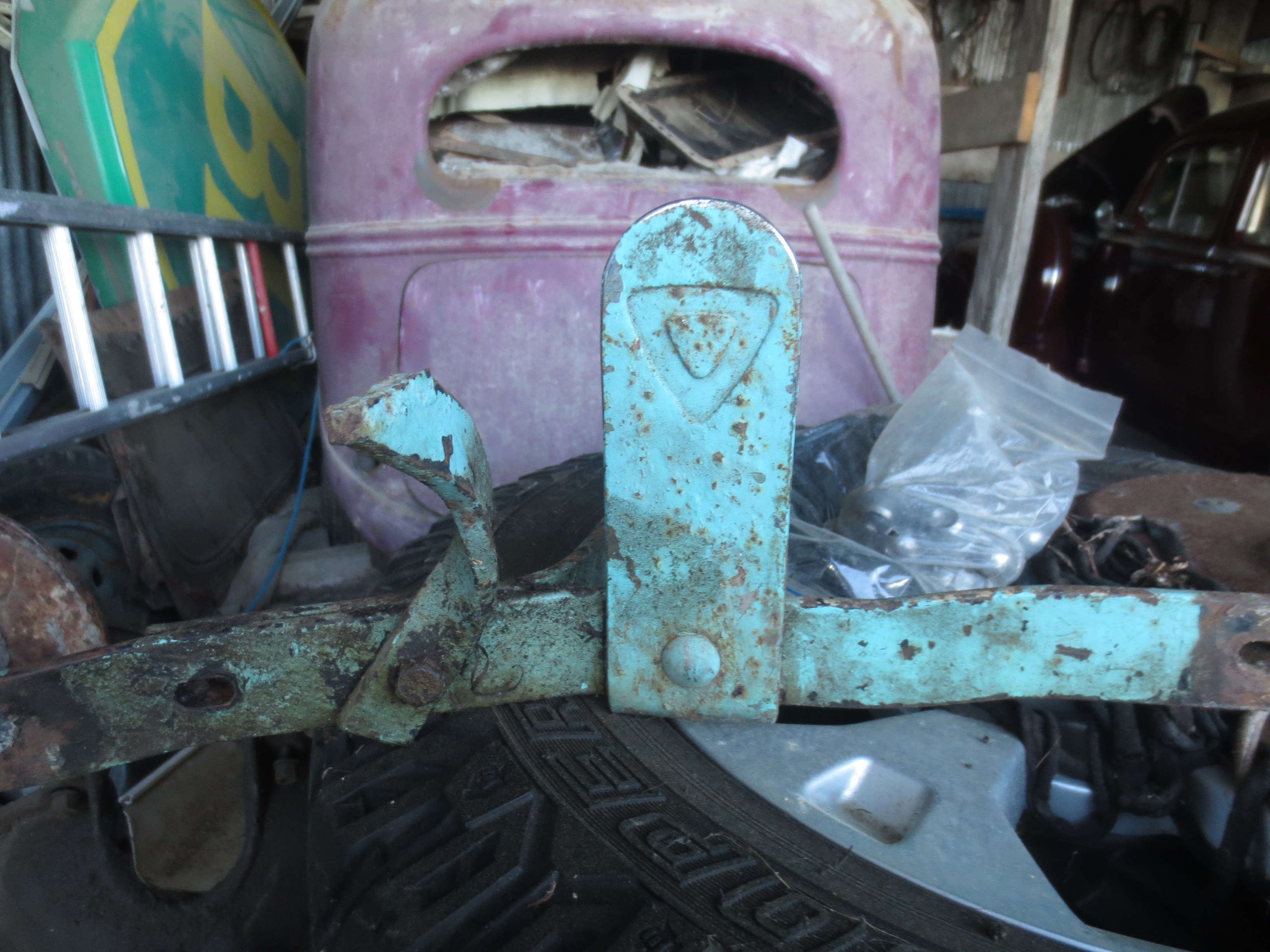

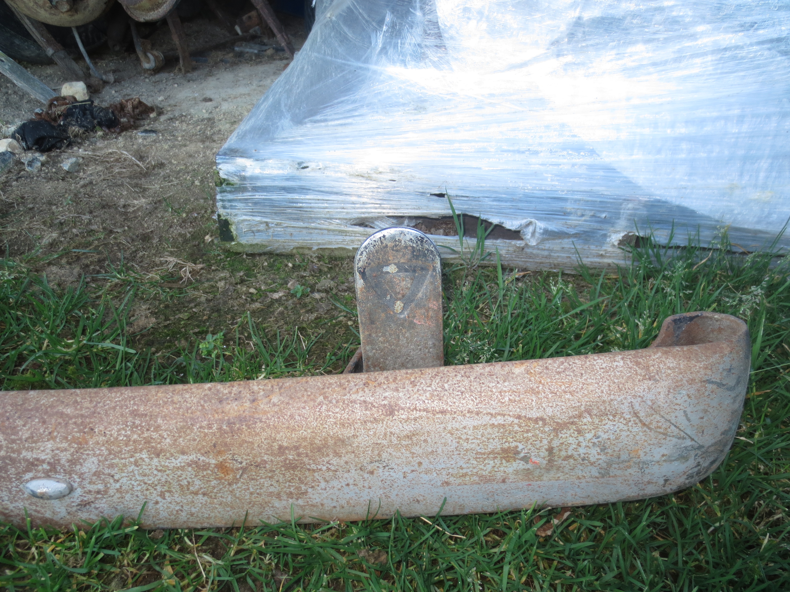

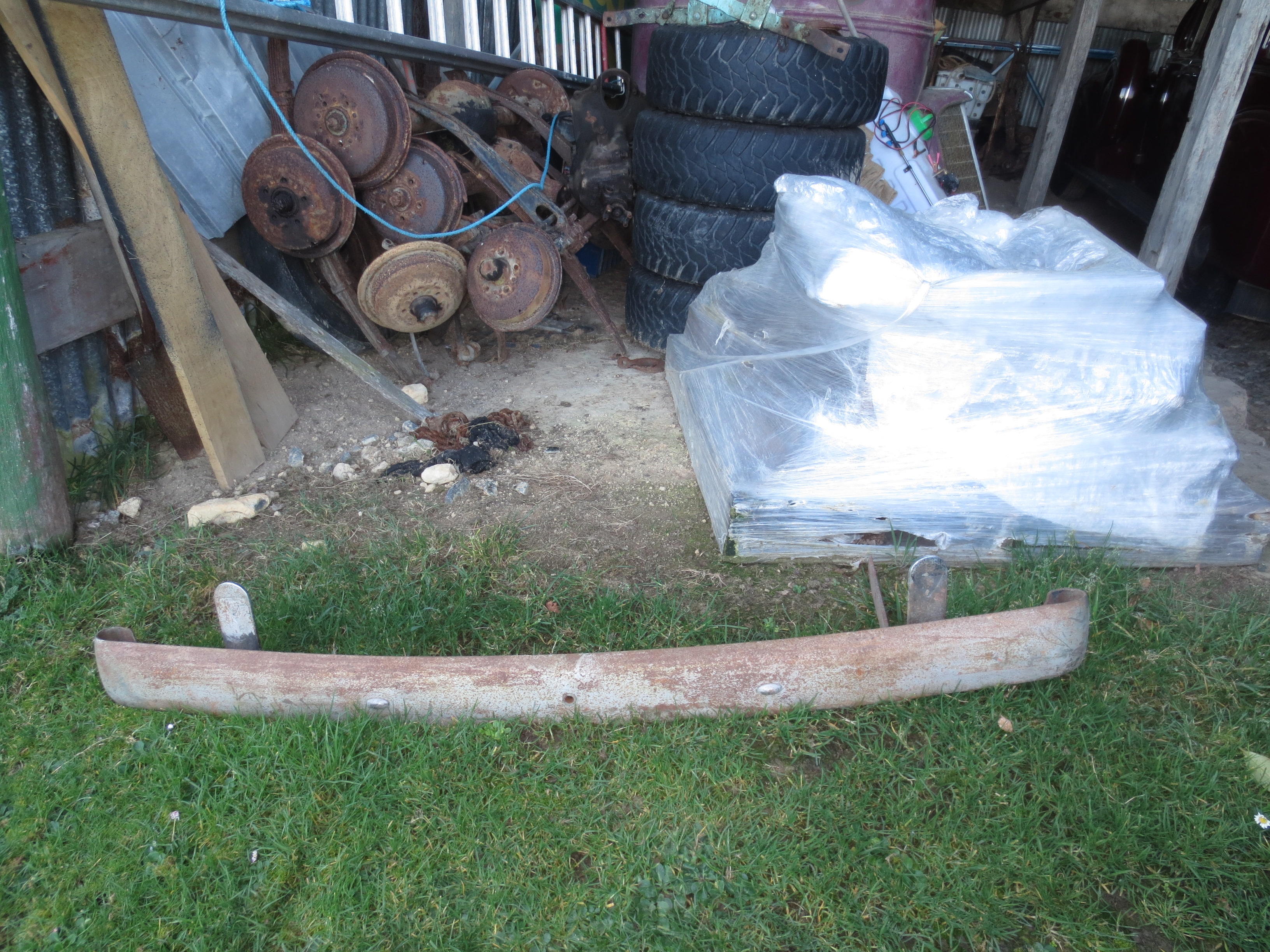

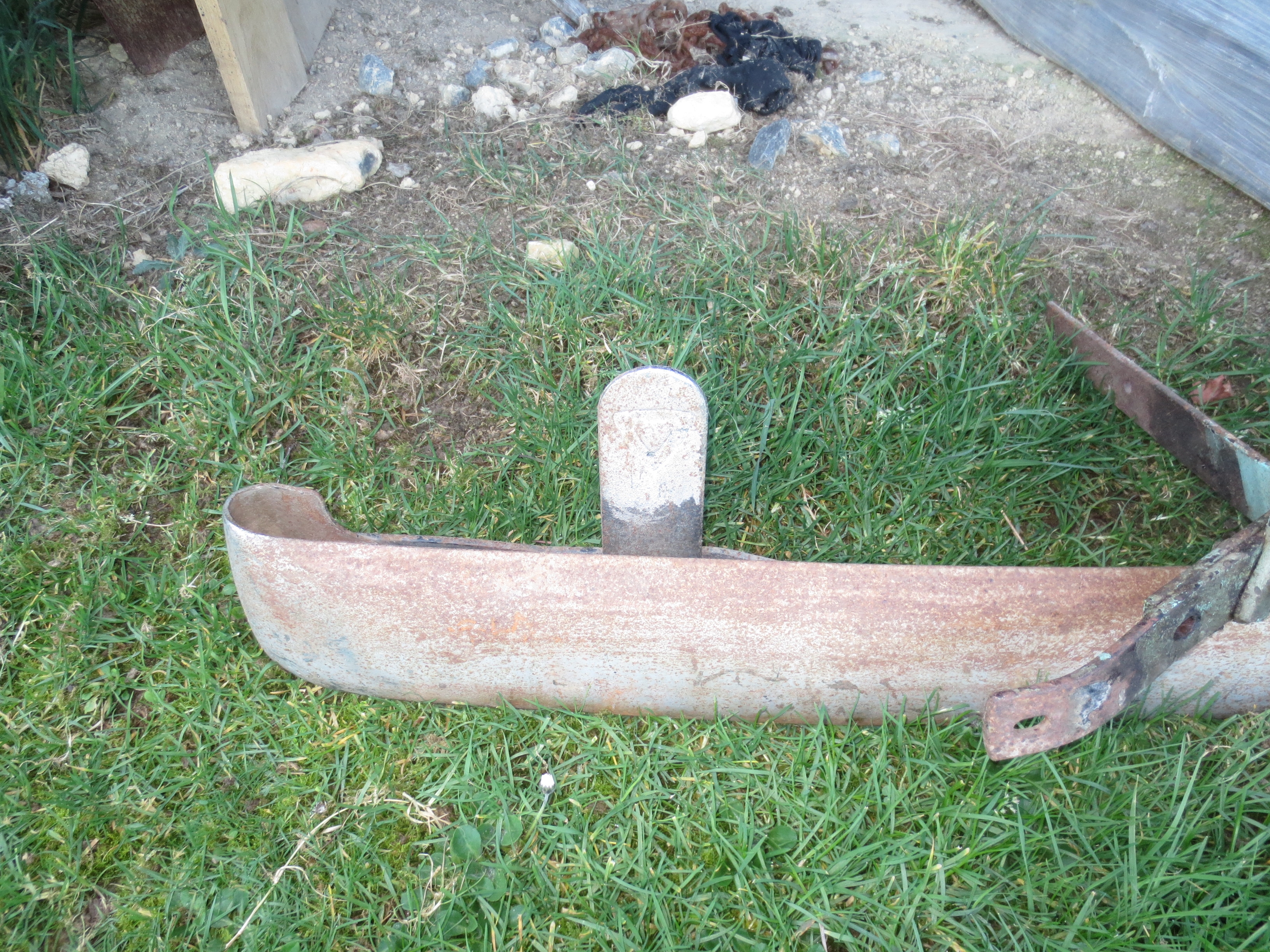

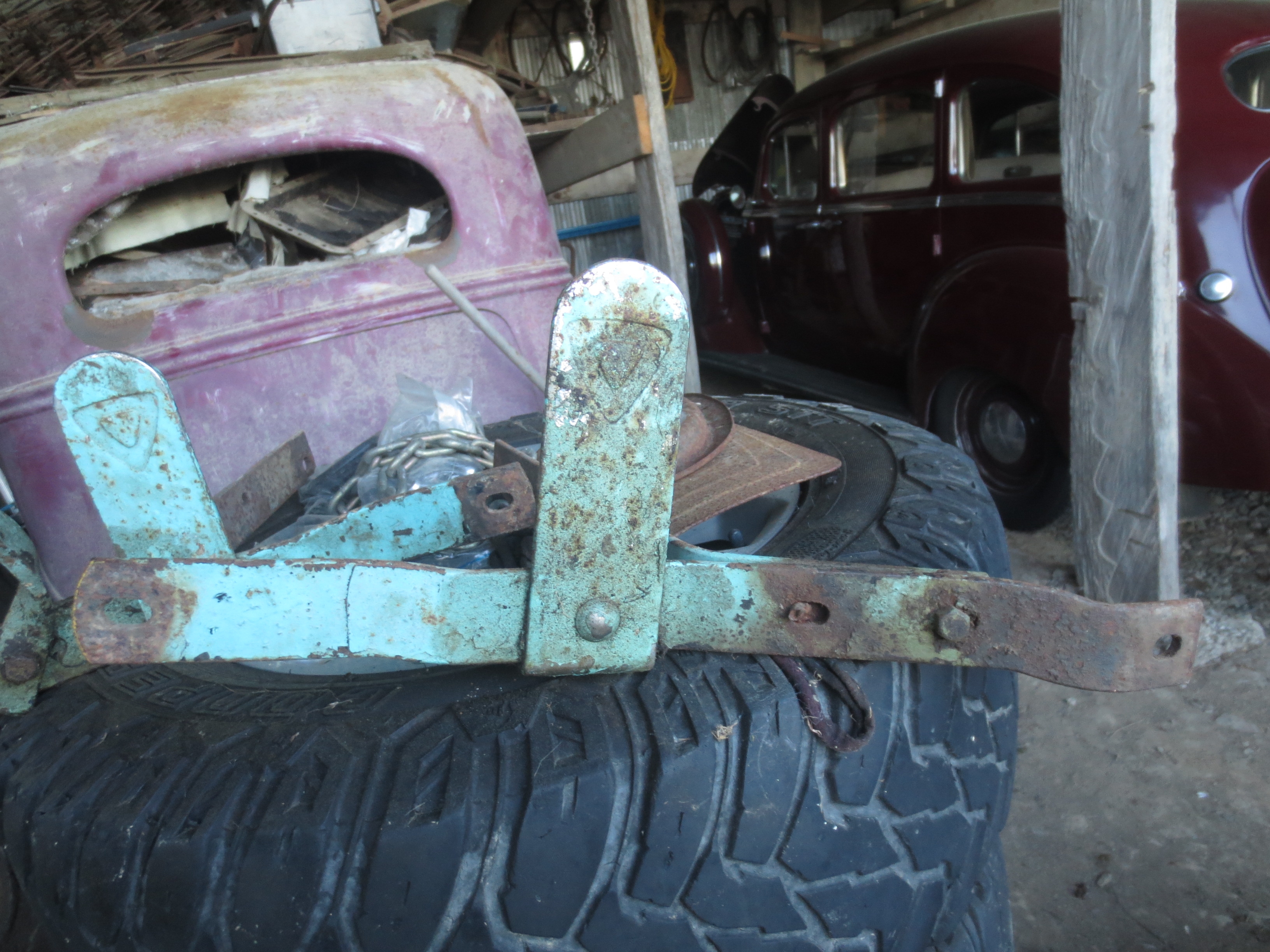

I have just had a eureka moment. You are quite right the profiles are completely different. I thought I had a good find some years ago and brought a very good condition 34 front bumper thinking it would fit the 35 but alas it did not. Any how I digress A number of years ago I brought a 1934 Hudson 8 Sedan as a parts car. I still have that car and the inside is full of all sorts of goodies. After reading the last post it got me thinking so I went and pulled the rear bumper out of the car.From what I can now see it would appear that the bumpers that have the bumper guards attached are only on the front and the rear has a flat plate attached to the irons which have the triangle insert. I will send a picture as soon as my camera charges. I would say I am correct. I have one complete rear bumper and another set of rear Irons. Both have the flat plates attached and you will be able to see how they attach. These certainly look factoryTrevor0
Maybe unique to the 34s

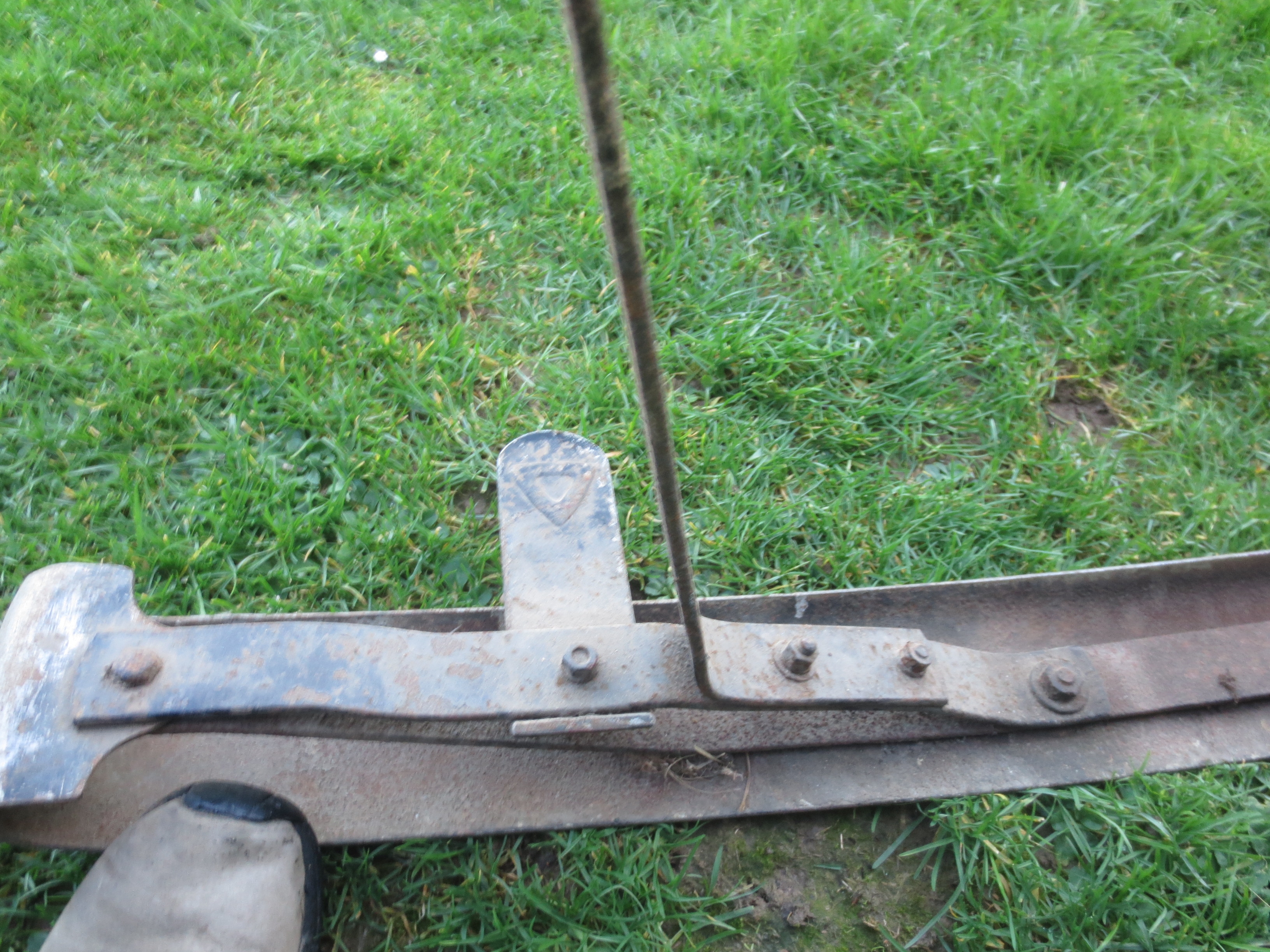

I have attached photos of the rear bumper for a 34 Hudson 8 sedan with the triangle plates attached to the bumper Irons also a set of spare Irons that I have showing how they are attached. Possibly the 35 Terraplane had the Hexagon stamped in them. The triangle seems to be a stamping as opposed to an engraving. Whats everyone thoughts

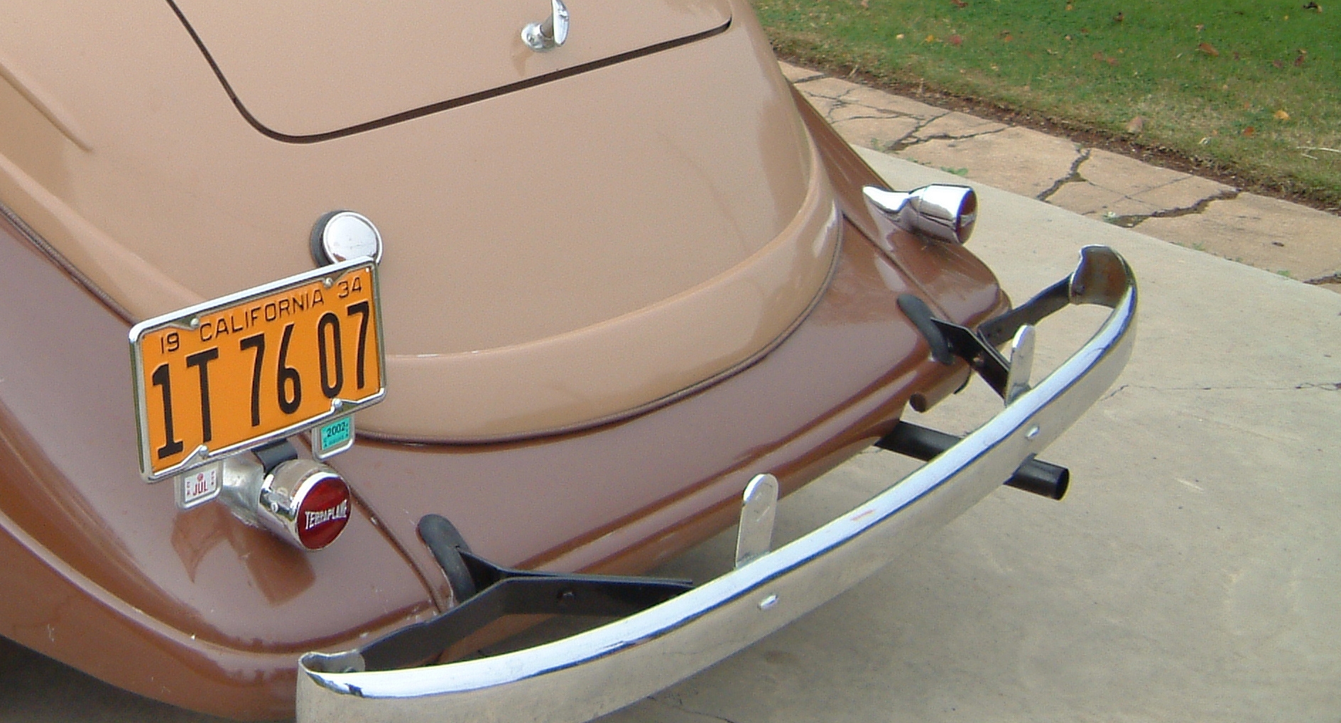

Trevor; you can see on the photo of 35 Hudson I posted that my 34 Terraplane next to it has the flat plate "guards" above the bumper with hexagons [I'll attach another view]. Yes the guards look to be factory and the hexagon is stamped in, cast in, or whatever. I see numerous other pictures on the internet of 34T with those "guards" in the rear.
So, what I was looking for are those front bumper guards with the hexagon, which were apparently unique to 34T. I also posted pictures of cars with those - and those would be the Terraplane version of the one 34 Hudson front bumper guard that I have pictured above. Trevor - sent you a PM.0 -

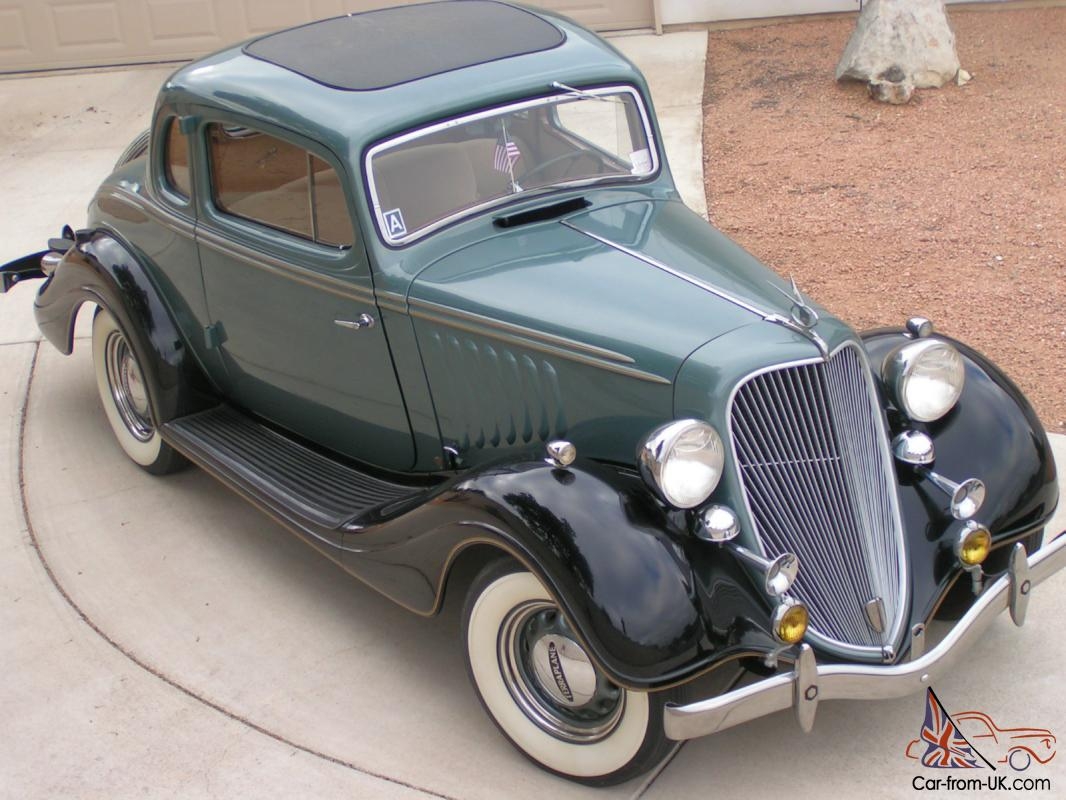

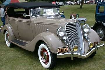

Are you talking about pictures of the front bumper guards like this? I was more looking for somebody who has some to sell. That is; the accessory bumper-attached guards with the hexagons, not the uprights attached behind the rear bumper.
dholck - I know nothing about bumper guards, but sure would love a set of those skirts. Are yours stock? Do you know of any for sale or know of a source? They sure look great on your coupe.
"Bent metal" from this page has made the correct factory style '34-'35 fender skirts. I'm sure he still has the patterns to make more.Essex33 said:dholck - I know nothing about bumper guards, but sure would love a set of those skirts. Are yours stock? Do you know of any for sale or know of a source? They sure look great on your coupe.0 -
