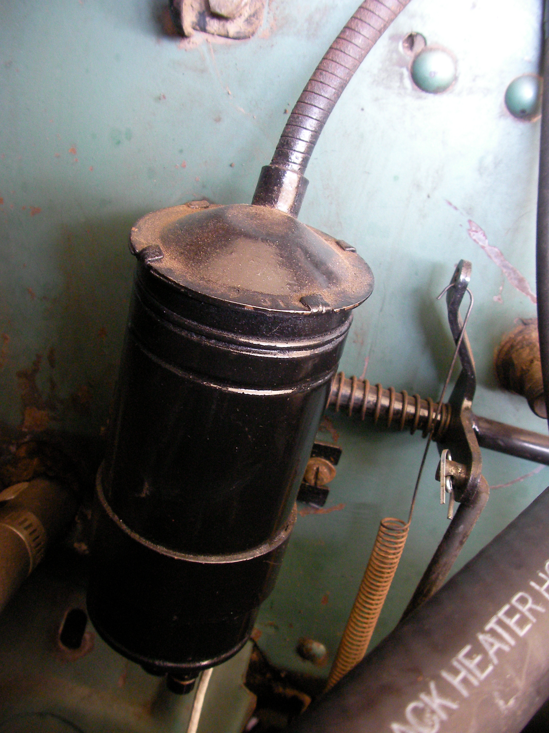

Ignition coil needed
Ebay is a good place to look. Some of the Hudson coils fit other, more popular makes (like Chrysler Corp.) so they are not so hard to come by. Exactly which year and model Hudson are you looking for? Someone may be able to offer an alternate part number (or even an interchange from a different coil manufacturer.0
1939 model 920
Try looking for the IG-3224JS. I think that the 4656 may include the coil and its bracket (which you presumably already have, attached to your firewall). If you look on Ebay you will find several IG-3224JS's for sale. They also fit Chrysler and Plymouth from the 1930's so are not terribly hard to find. I think the current crop for sale on Ebay are a bit expensive (some, well over $200 starting price), so unless you're out of time you might want to sniff around for a better price.
For example, here's a recently completed Ebay auction with one of these coils. https://www.ebay.com/itm/1935-1937-1939-1946-dodge-desoto-chrysler-nos-autolite-ignition-coil-IG-3224JS-/323883000578 Nowhere near $200!0 -
Thank you Jon B I will look for that as well0
Val, In the past I’ve bought a regular 6volt coil at NAPA for around $20. It can be hooked up by taking the top (with cable) off the original one if you need to hook up a new one to test run the vehicle & diagnosis if it is the coil having issues. Hope it help!0
BigSky, Thanks for the info, I'm aware of that as I have done that before. My original coil is good but the tabs on the side that hold the cap, 3 of 4 are broken off. And I would like to stay with the original type if possible0
