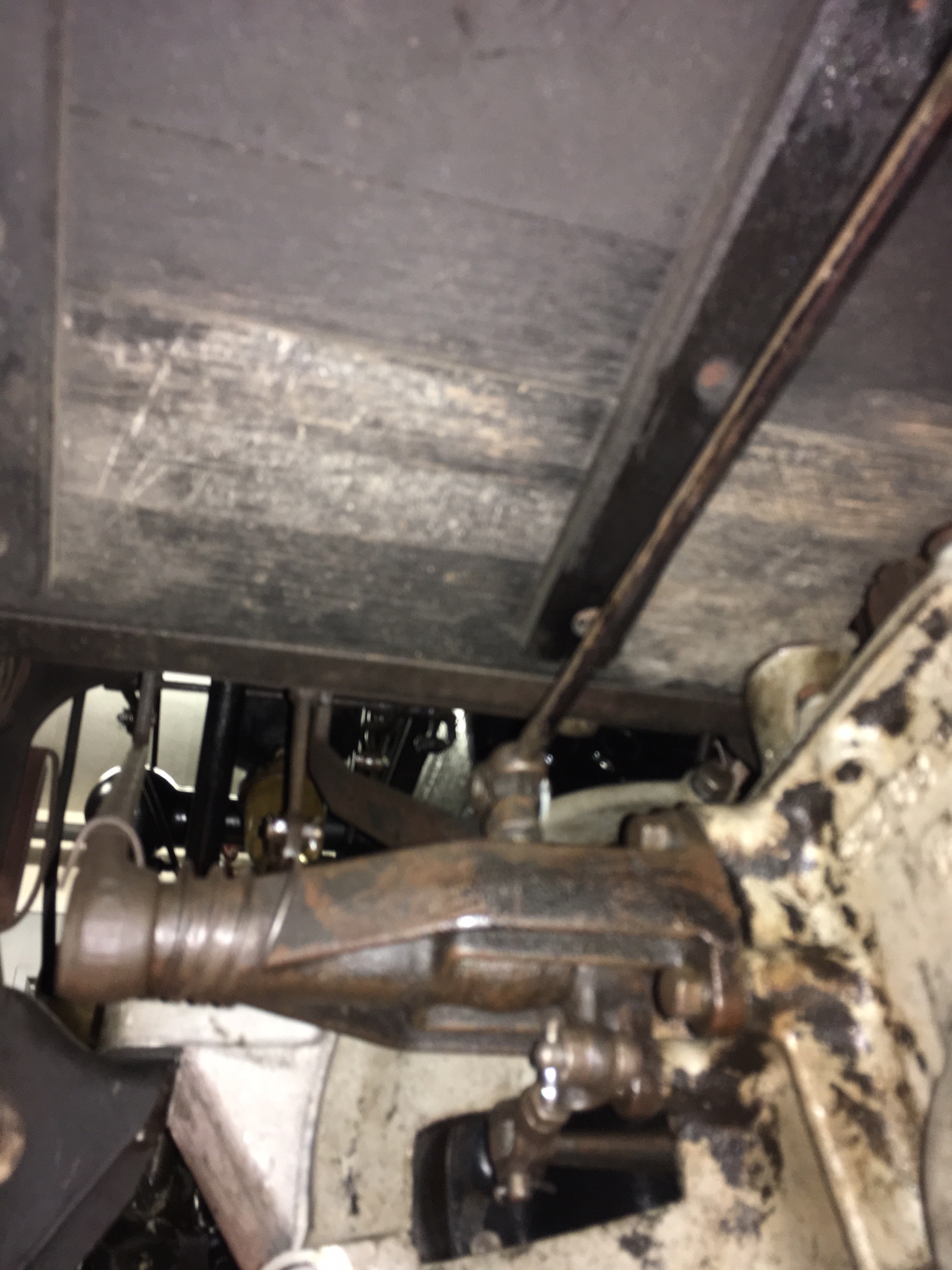

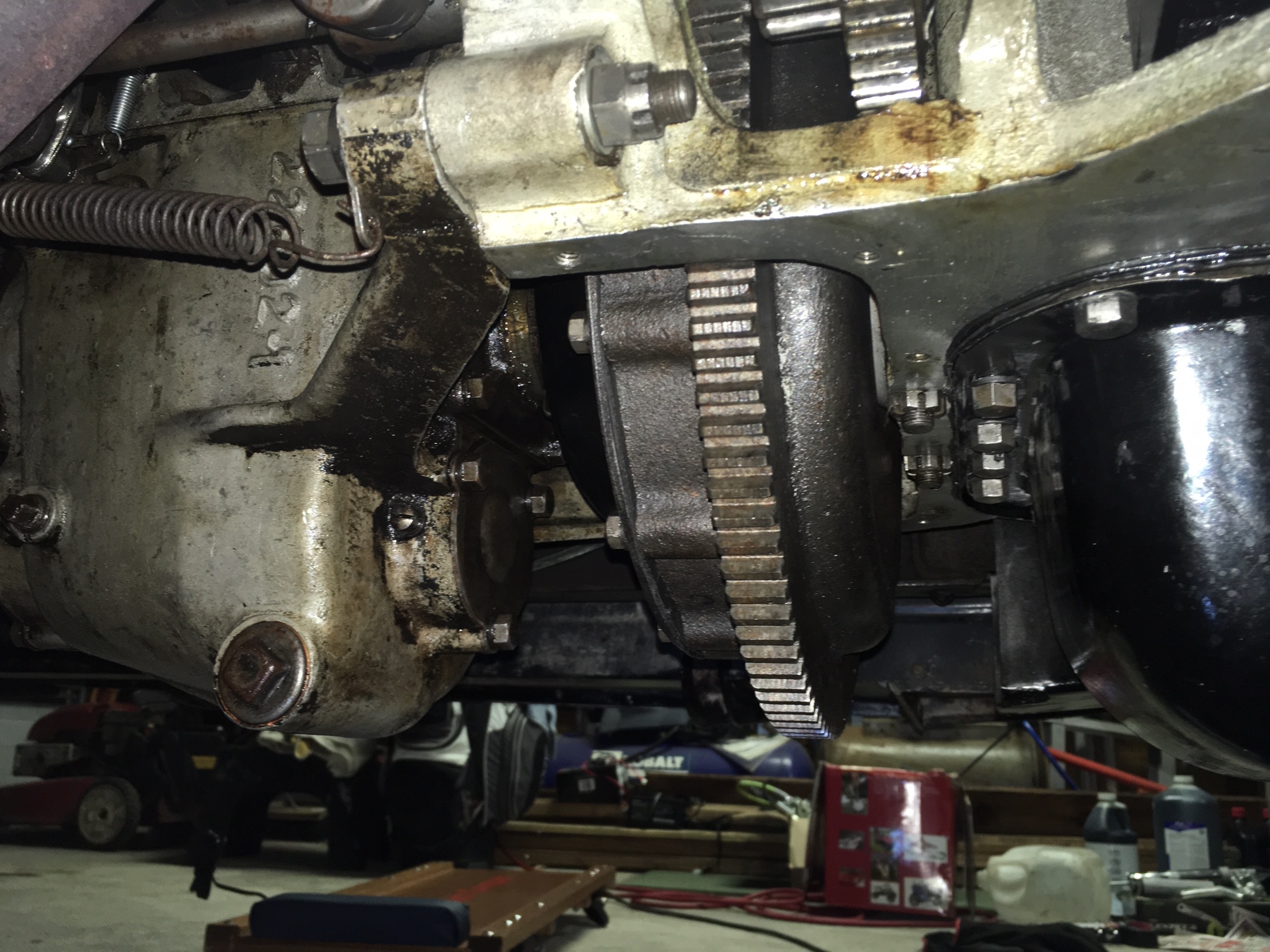

Is this where I add fluid for the clutch. This is a 1923 Hudson Super 6
All the books I have show it under the hood by the steering Column but mine
doesn't have anything there. This view is under the car on the right side.
That is the transmission, not the clutch.0

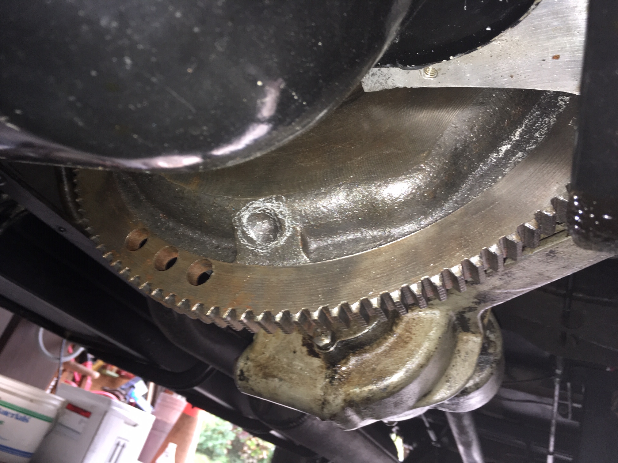

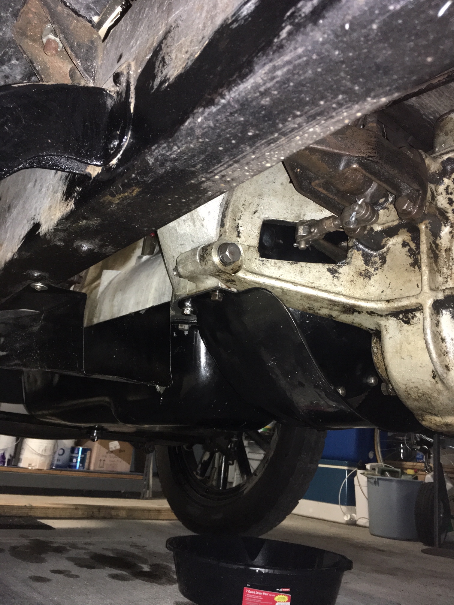

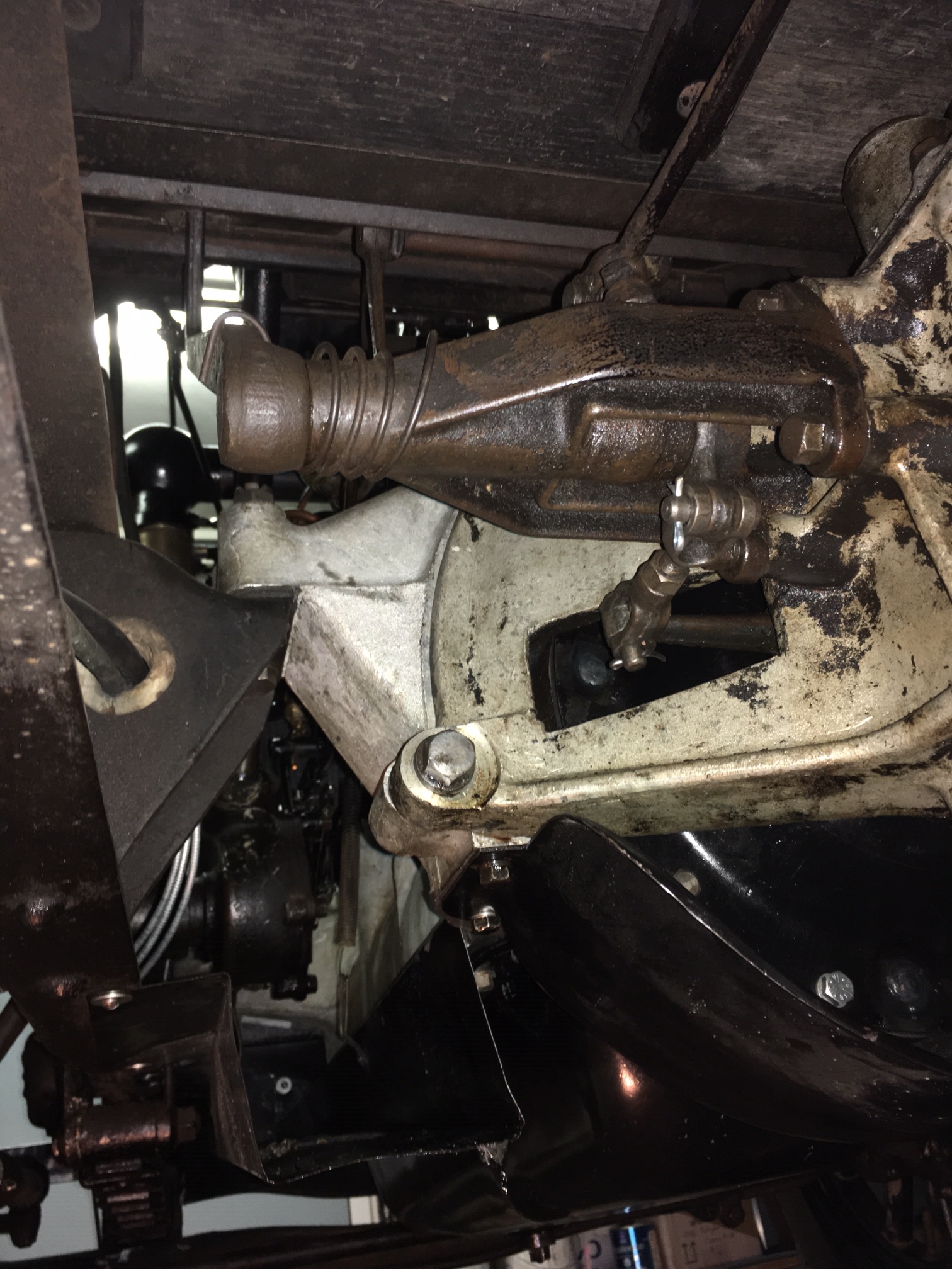

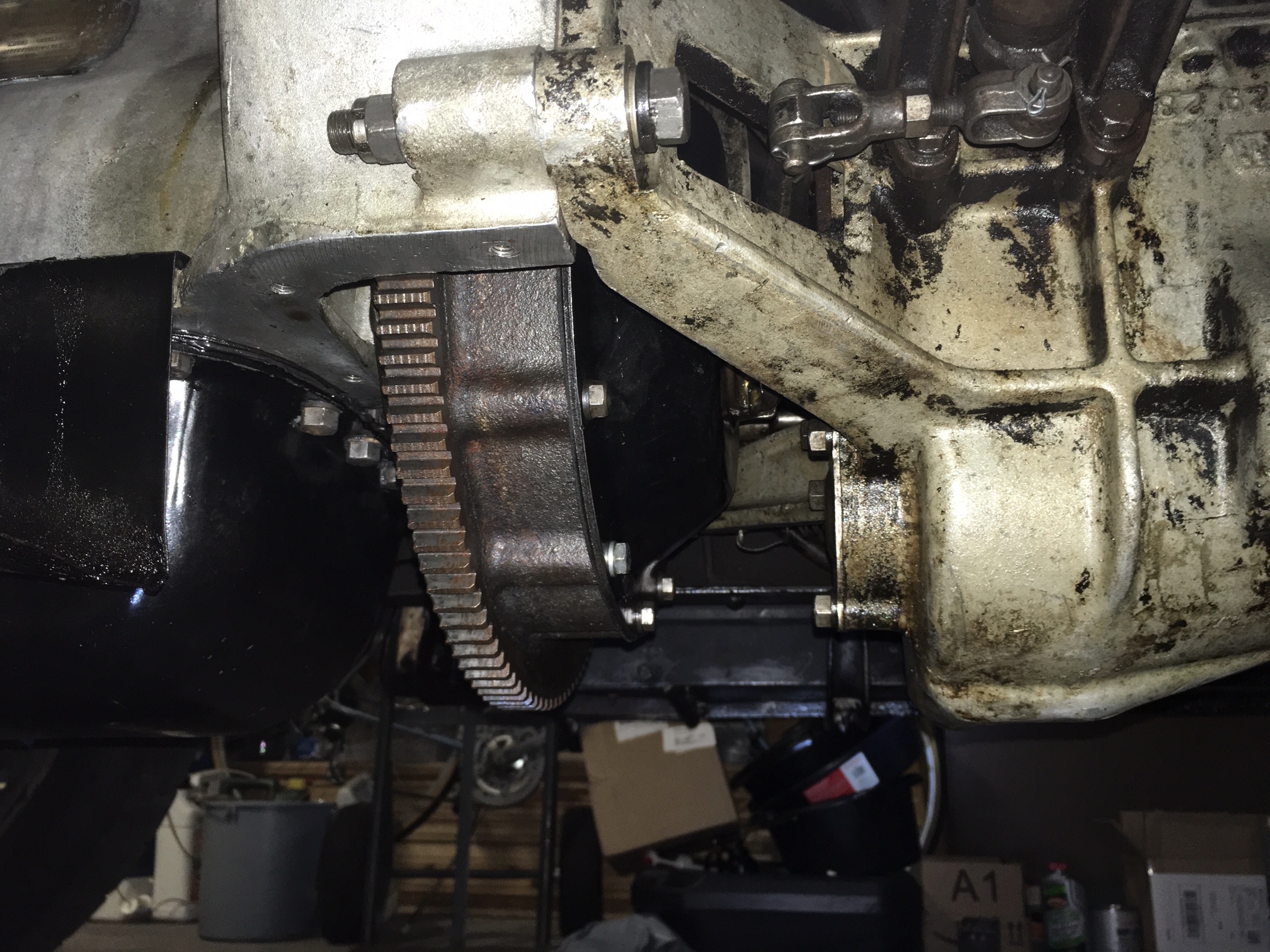

I took a few more photos see if any of them show the locationRobert0
you are looking at it from the back of the flywheel, you need to look at the front of the flywheel.0
Get under the car and remove the half round cover on the bottom of the flywheel. You will find the plugs for draining and filling.0
I was thinking the same thing. Just found the inspection hole in the engine compartment where I can see the flywheel. Wonder why they made it so difficult to service this part of the machine?Robert0

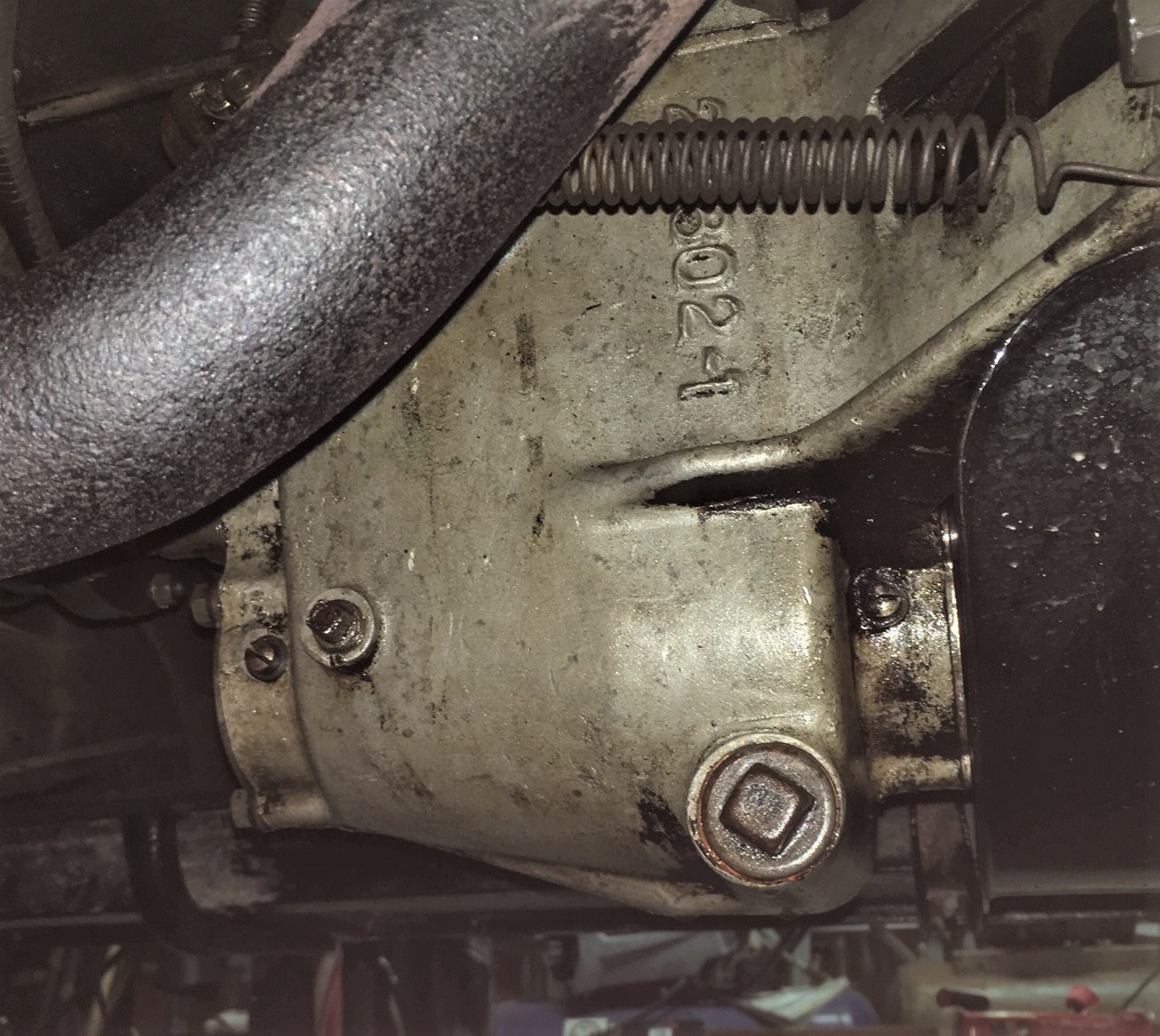

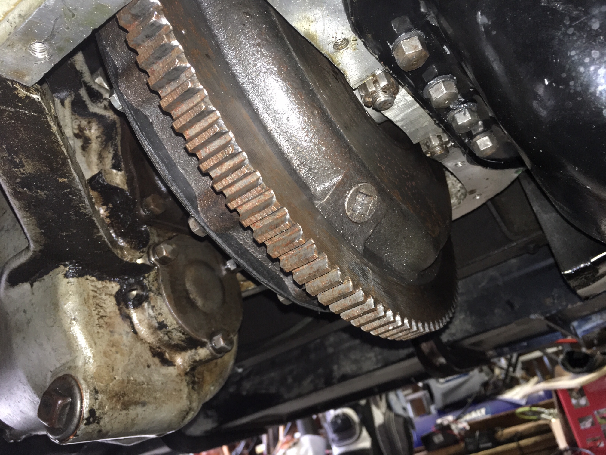

I have two shop manuals and a book for the 1921 Hudson. None of them show the fill and drain plugs. I just took off the flywheel cover and took photos from both sides. I do see a small screw at the front of the transmission but doubt that is the correct spot. I am an H-E-T member. Going to the meet in Hershey in a few weeks and hope to meet members that can help me.Robert0
Turn the flywheel round, you will see a plug on the front periphery. Has an internal square centre.0

So it's the 3 (6) holes along the edge of the fly wheel? I guess it does not make any difference between fill and drain just the orientation of the wheel?
Very helpful. This is what I found. Only 1 plug and 1 series of 3 holes. Looks like there was going to be another plug but only an indentation. So the one plug works as the fill and the drain? You must be able to see it in the inspection hole by the steering column in order to fill it. Do I have this right?Robert0
Now you got it,( just like Geoff said.) I always used a oil squirt can filled with the proper amount of clutch oil to squirt oil in housing, cuts down on the mess.
The undrilled boss could have well have been cast into the flywheel to balance the drilled boss.0
Can anyone tell me how I can manually rotate the flywheel so I can get the plug to show in the inspection hole? I have been hitting the starter to spin the wheel. Can't move it by hand even though I am in neutral.Robert0
Take the spark plugs out. Lever the flywheel around or turn it by hand.0
Thank you guys for all your help. I'm new at this having just purchased my 1923 Hudson. I did figure a way to move the plug in the flywheel to the observation hole for filling. Just put the crank in the motor and turned it until the plug came up. A very easy solution for anyone who has a crank for their engine.Robert0
