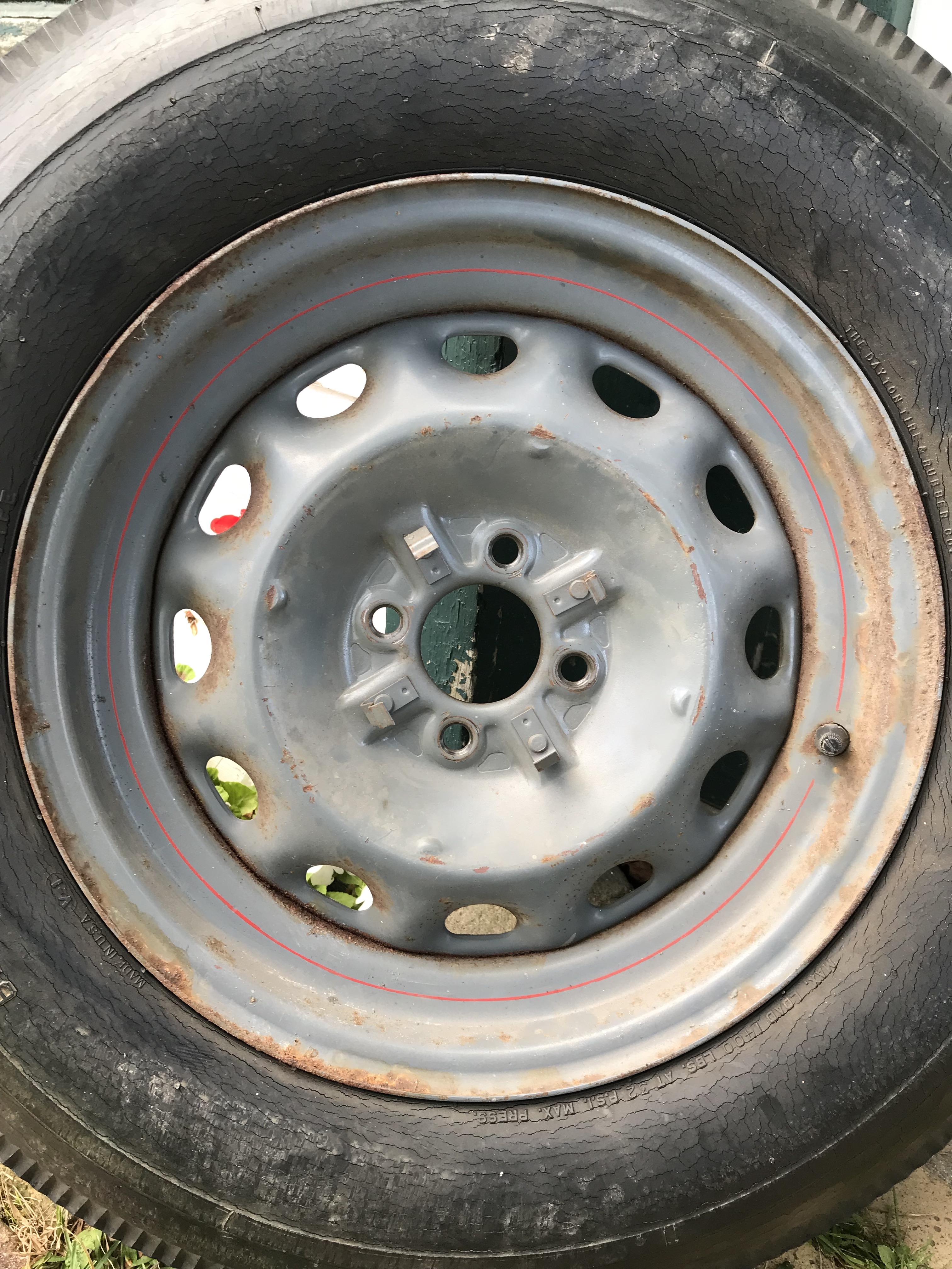

Thanks Big Sky. The tire installer I've know for years, he has his own small shop. I'll past this data along to him. He directed me to a body shop that does restoration work. I visited it last Thursday morning. The body shop told me to have the tires removed. They'll soda blast the rims inside and out and prime the entire rim. Then I'll have the tires mounted. Back to the body shop and they'll then mask the tires, do the top coat, add the pin strip and add the clear. He said he's done it this way may times and guarantees his work. He showed me multiple pictures of his work. From cars, to motorcycles to snowmobiles. Attached is a pic of the worst rim.0
