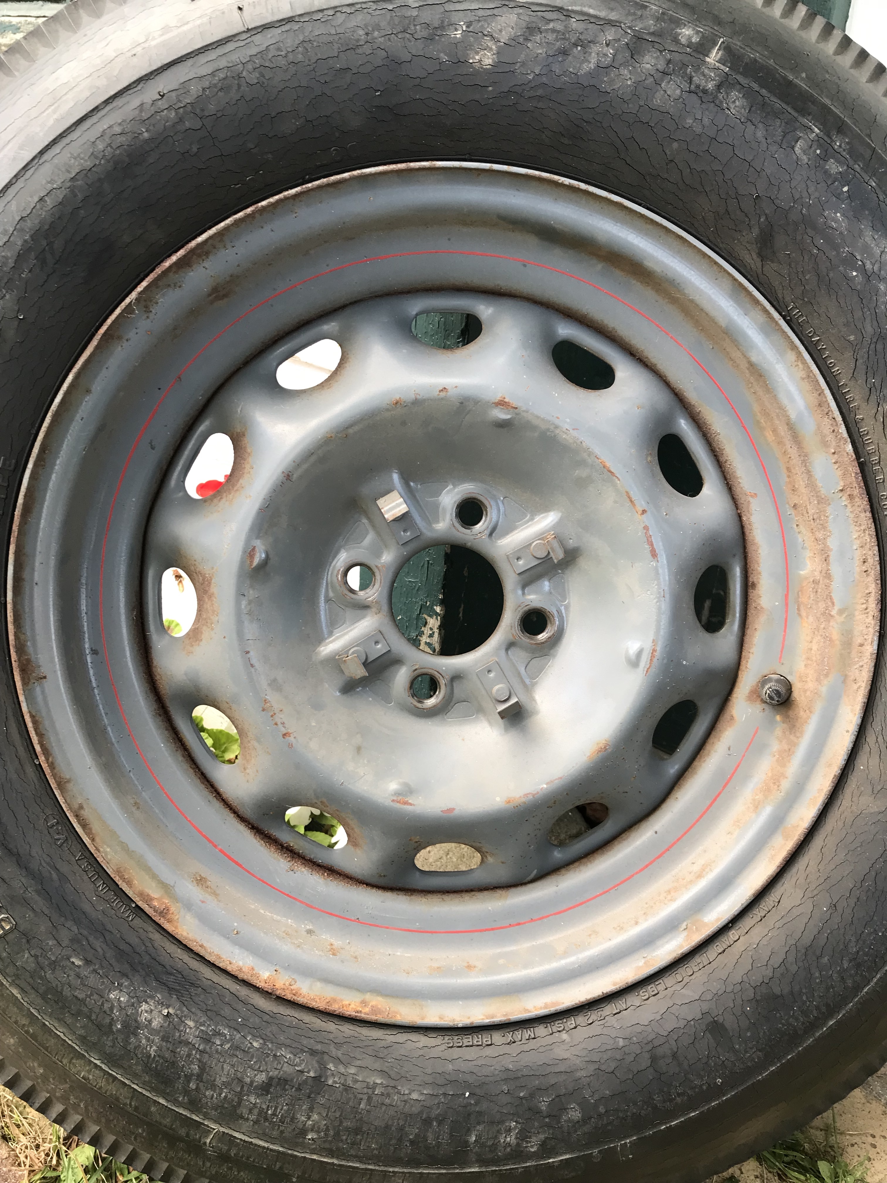

Does anyone have a source for the spring clips and rivets that hold the hub cap on the rim?

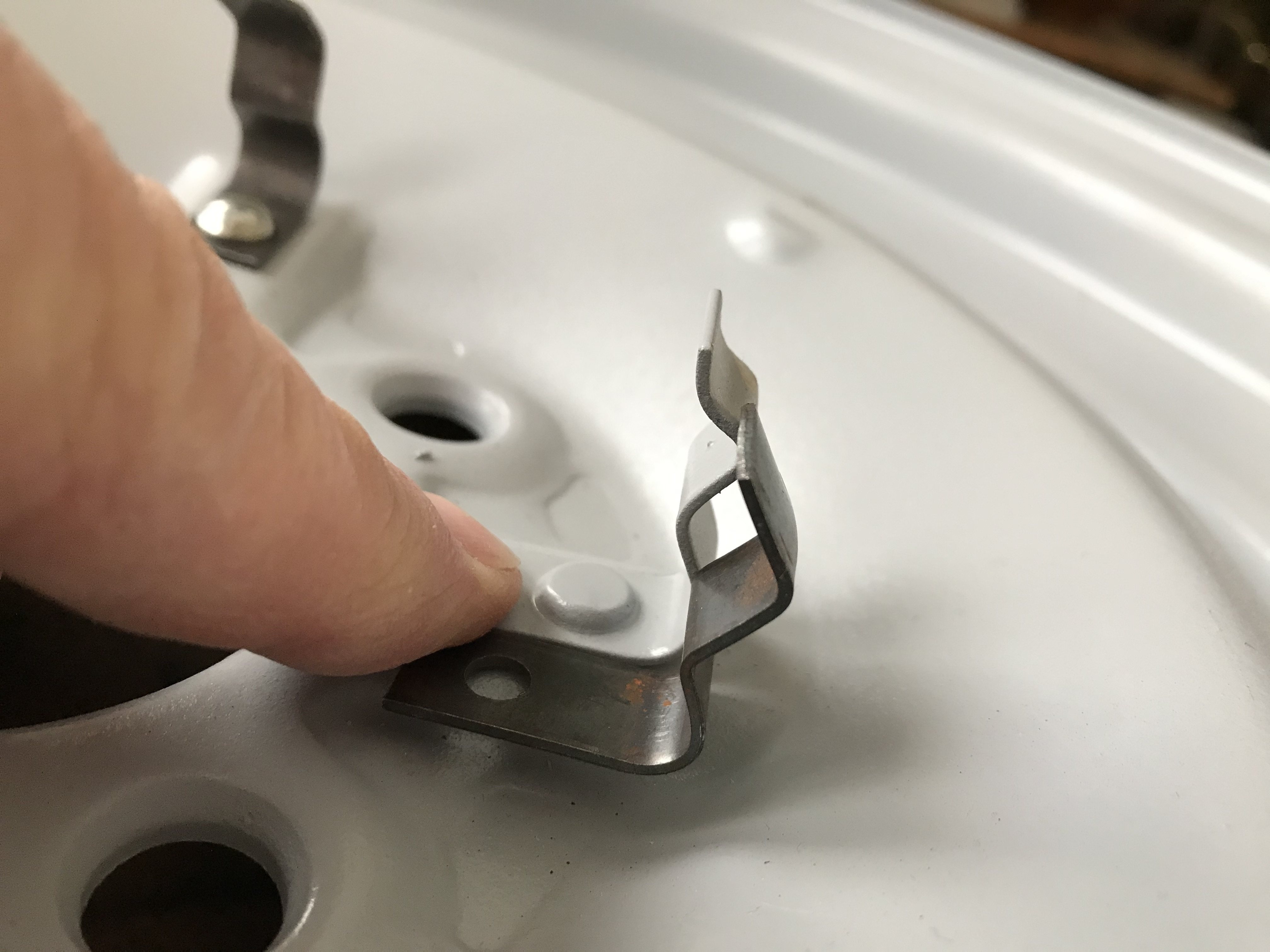

I think a good wheel repair shop should be able to help you. I have one of those 4-lug artillery wheels (for the spare) to pick up from powder coating right now! I talked with a wheel shop and was almost in a position to tell you something definitive, but ...one clip was missing from my wheel, and I had another wheel that had only one good clip, so I transplanted that one instead. We just attached it with a regular pop rivet tool and then used a punch to make a divot in the clip for the other hole. I also thought about how I could attach it with a little bolt; the back side of the wheel you don't see, and the front side is hidden by the hubcap.

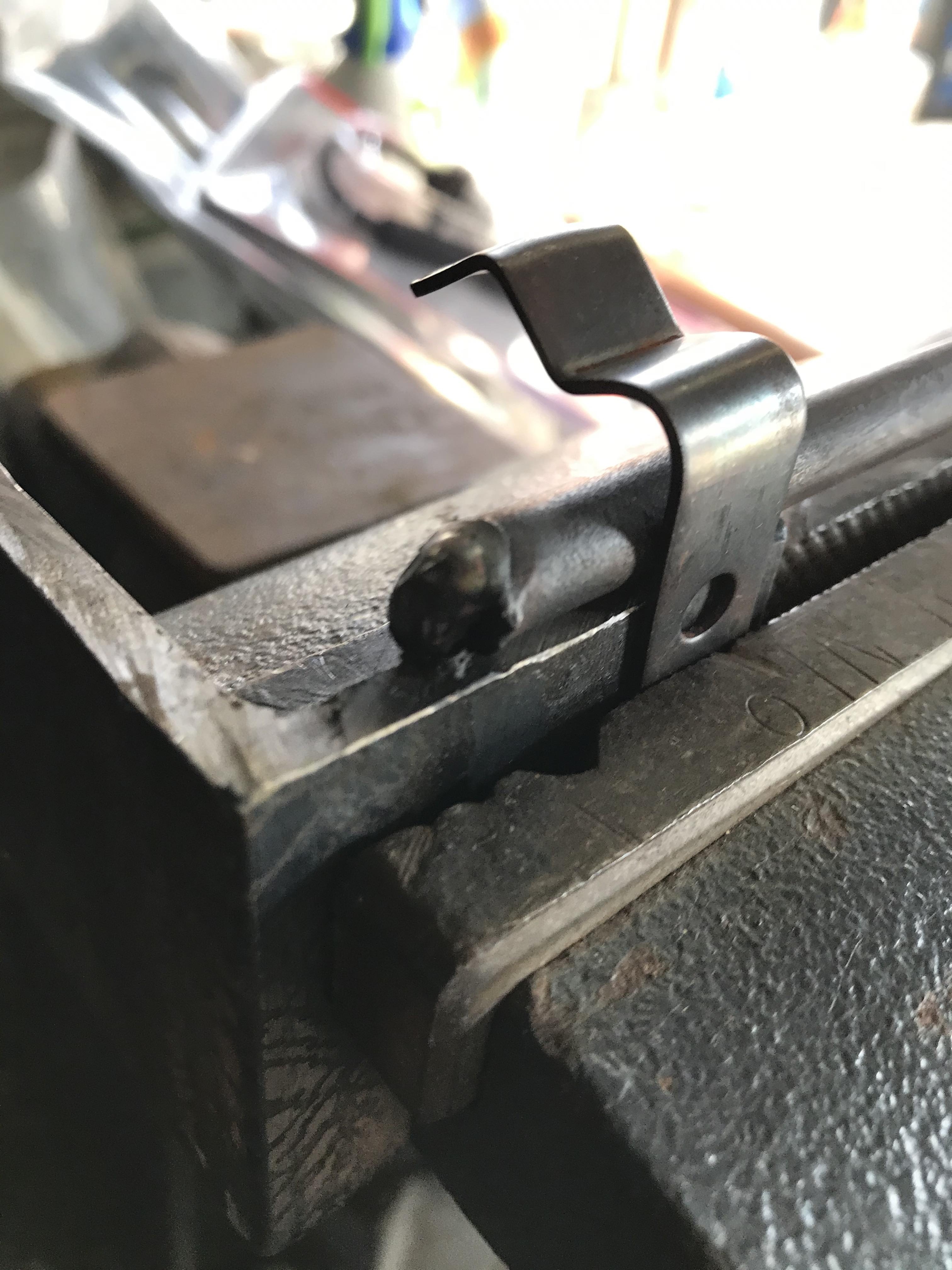

I ordered the Chevy clips. Had to give it some love to make it workable.

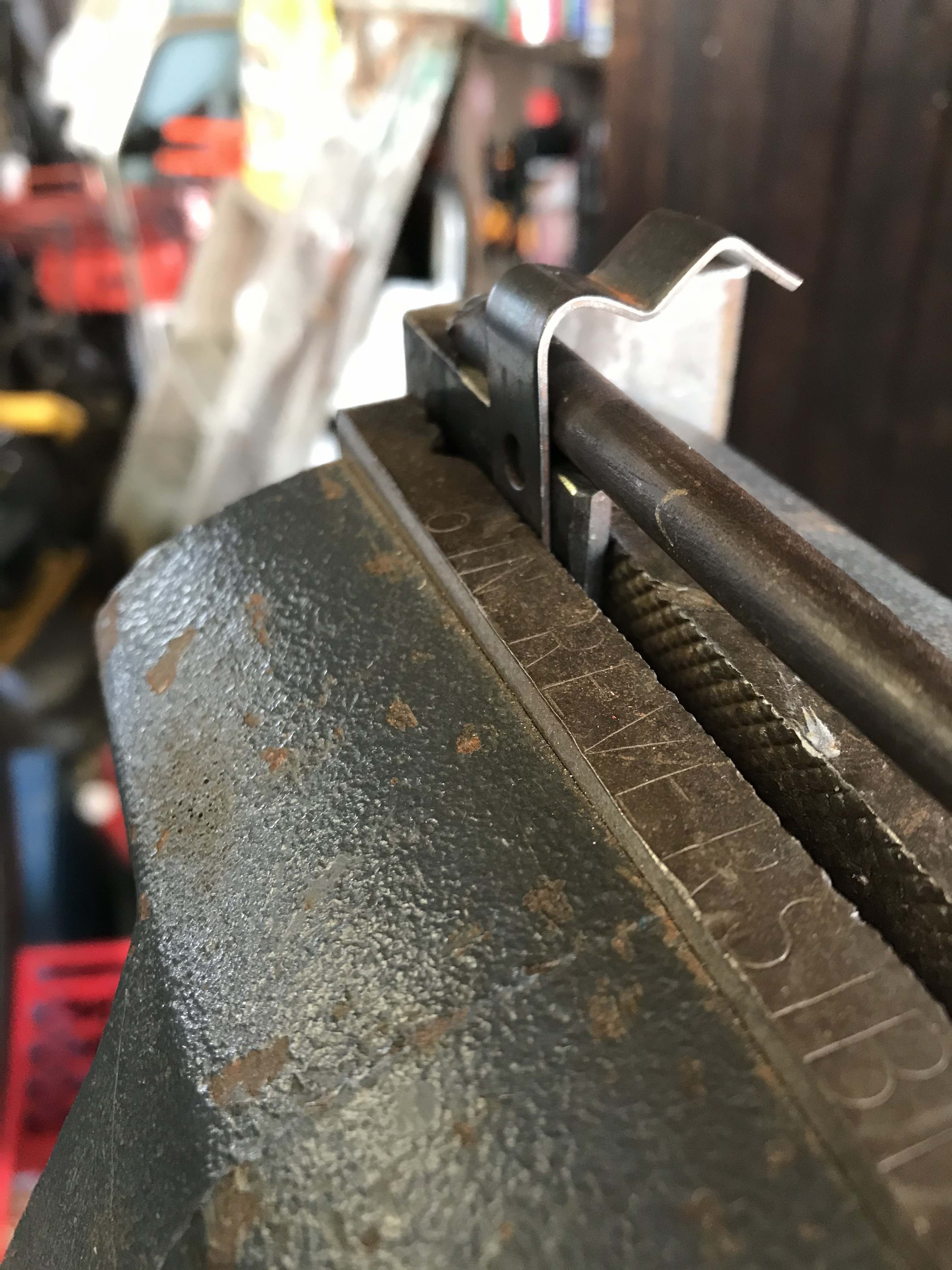

Tacked an old punch from the bin to a piece of angle to make a bending tool.

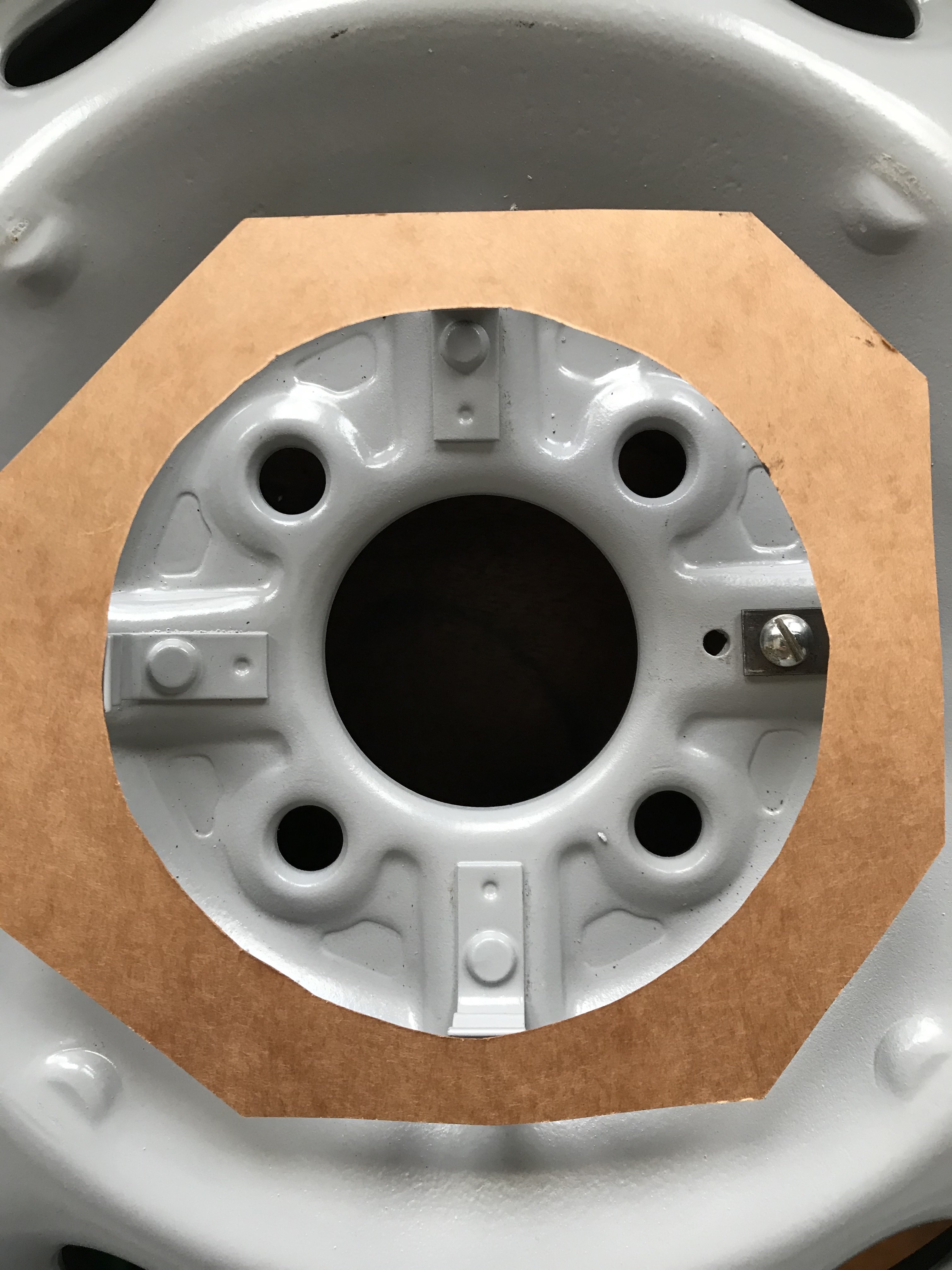

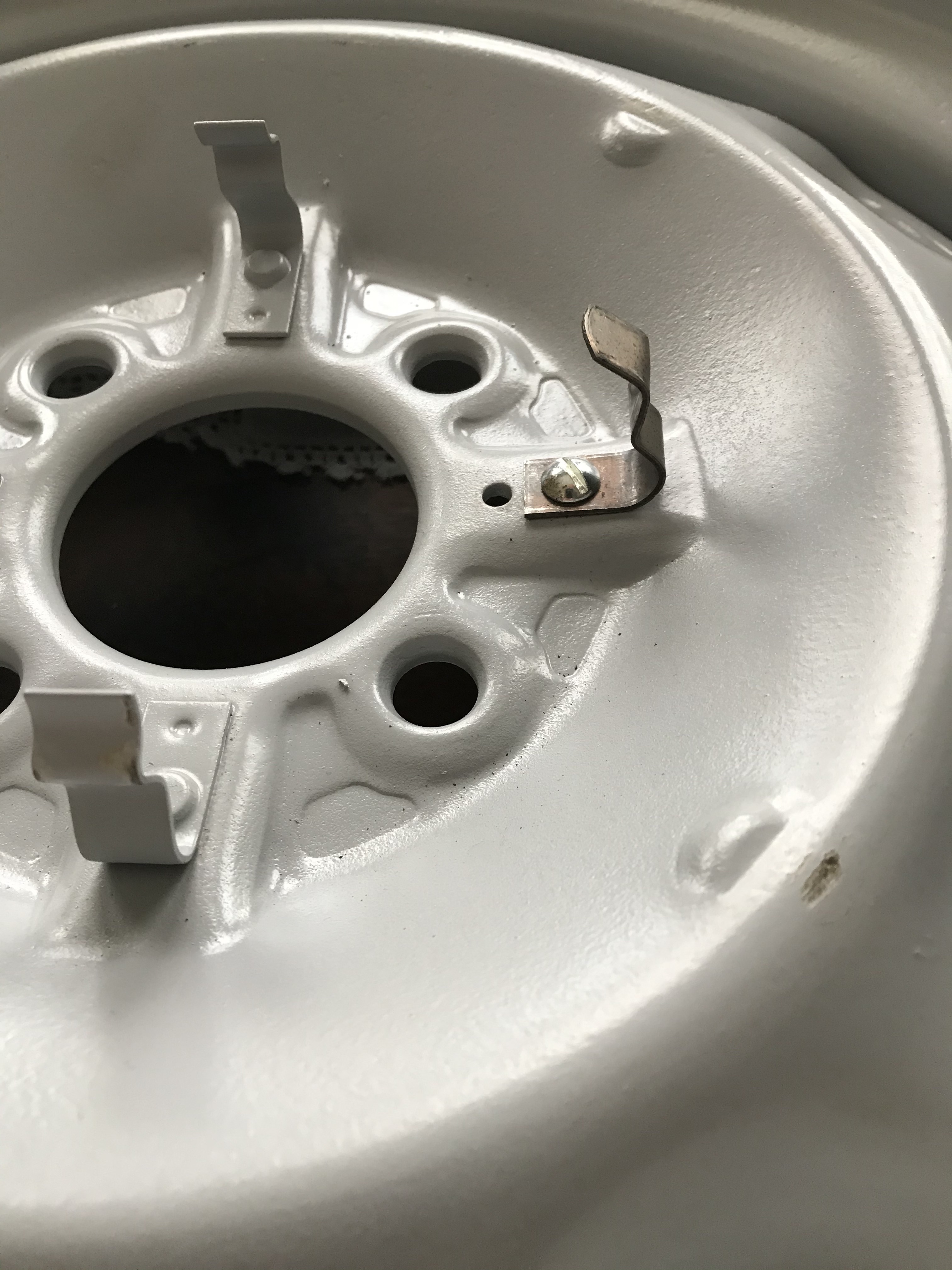

Bent / hammered the clip over the punch to change to position of the hole then bent the wavy part back by squeezing it in the vise. Took a few try's back and forth. Made a cardboard gauge of sorts to check the position of the new clip relative to diameter and height. I've decide to attach it with a screw, L'washer, nut & Loctite 271 for now. I'm nervous about it breaking after being bent around. If it holds up for a few years I may rivet it on. The hub cap snapped on nicely. You'll note I already took a chip out of my new primer getting the cap off. Was in a hurry and didn't slip a piece of plastic under the pry bar.0 -
