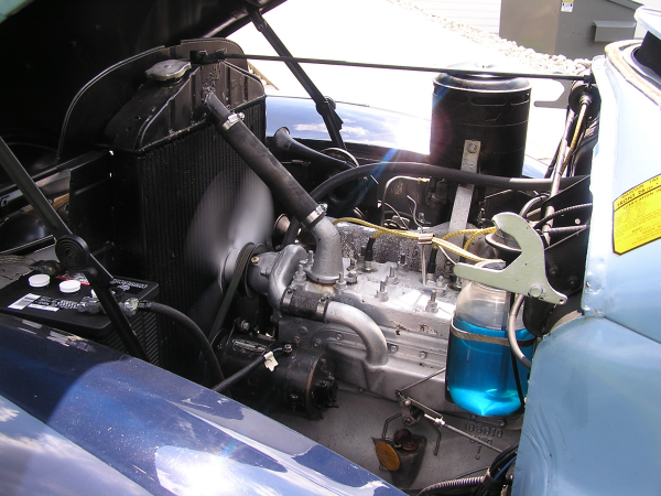

Here is a picture of the air cleaner, with the bracket attached to the head - best I can do, at the moment. You should be able to enlarge enough, to see how it attaches, and to which head bolt it goes onto.0
Makes perfect sense. Thanks for the photos 46HudsonPU!0
