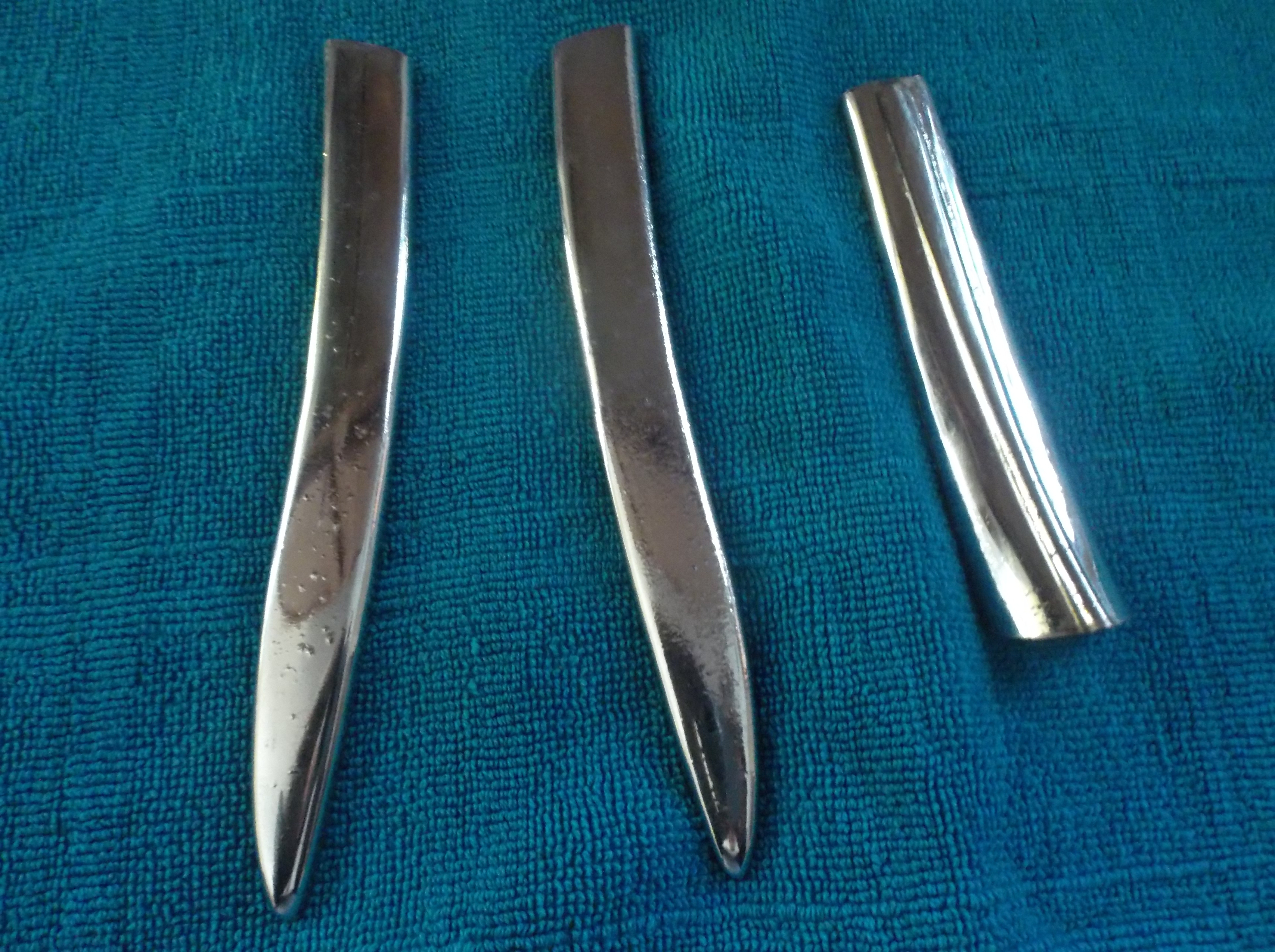

I am in search of the curve shaped hood pieces that extend from the grille moulding and the one that goes on the top of the cowl vent. Also I need two chrome or stainless head light rings. I will try to post a picture. I will have the front and rear bumpers and guards for sale or trade soon. All of this is 1937 Hudson Terraplane
I have found the curve shaped hood pieces.0

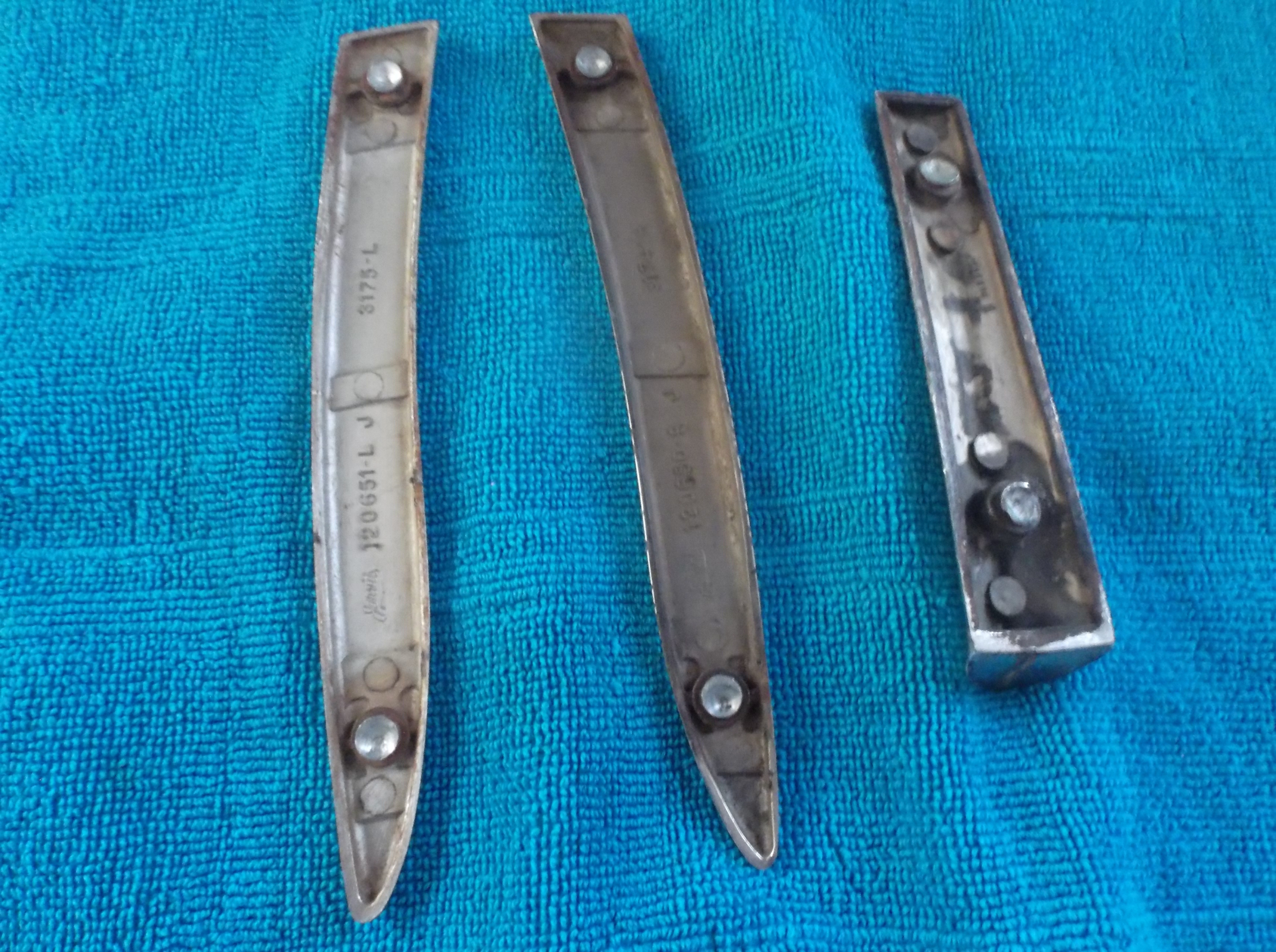

Incidentally, when I re-mounted all three of these items on my hood / cowl vent, I drilled and tapped very small holes in the location where the original studs were peened over. Then I secured the items from below. I think I used a #4 or #6 screw. The attachment has held just fine for about 48 years!0
THANKS Jon B I had the hood pieces made from solid stainless and the cowl vent mounted with new studs drilled in to the piece0
