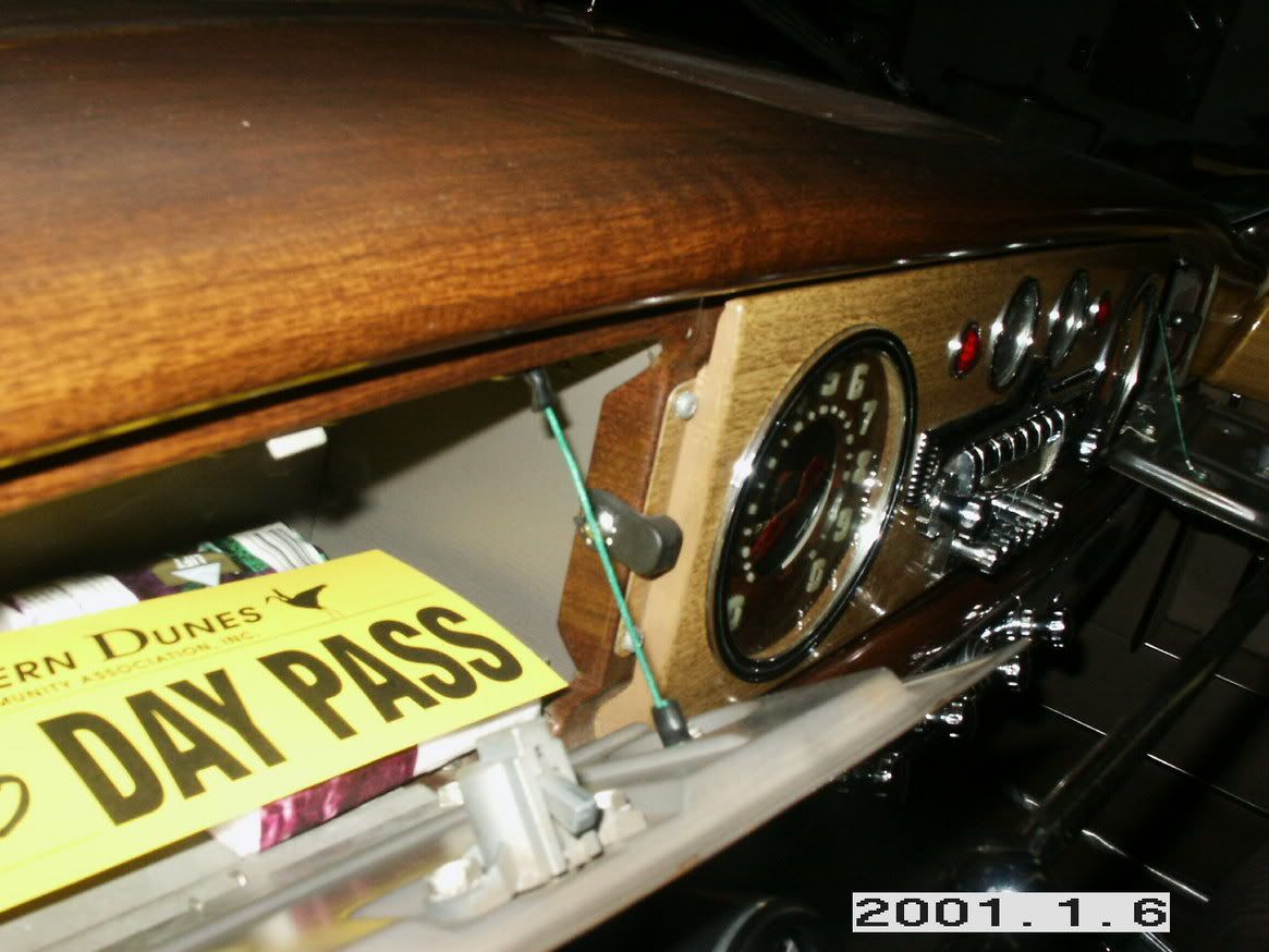

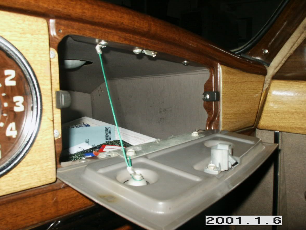

Can someone please tell me if the factory installed some type of wire or used some other means to prevent the glove box door from flopping down and smacking into the dash??? My car did not have them when I tore it down, but I seem to remember seeing a car that thad them. If so, does anyone have a photo????? The dash is going back together and I quickly realized that if I dont do something, my new woodgrain job is going to get trashed if I dont work something out.

Mine has wires,I'll try to get a pic tonight.0

drivers side is a little shorter to keep it off of the shifter and gauges that the previous owner installed.
Pass side sits level when lowered...
TwinH has got it about right. I have used the screw that holds the rubber stop to the dash and drilled a small hole in the glove box door in the raised inner lip for a cable. This solved the problem quite well and the cable didn't get in the way.0
