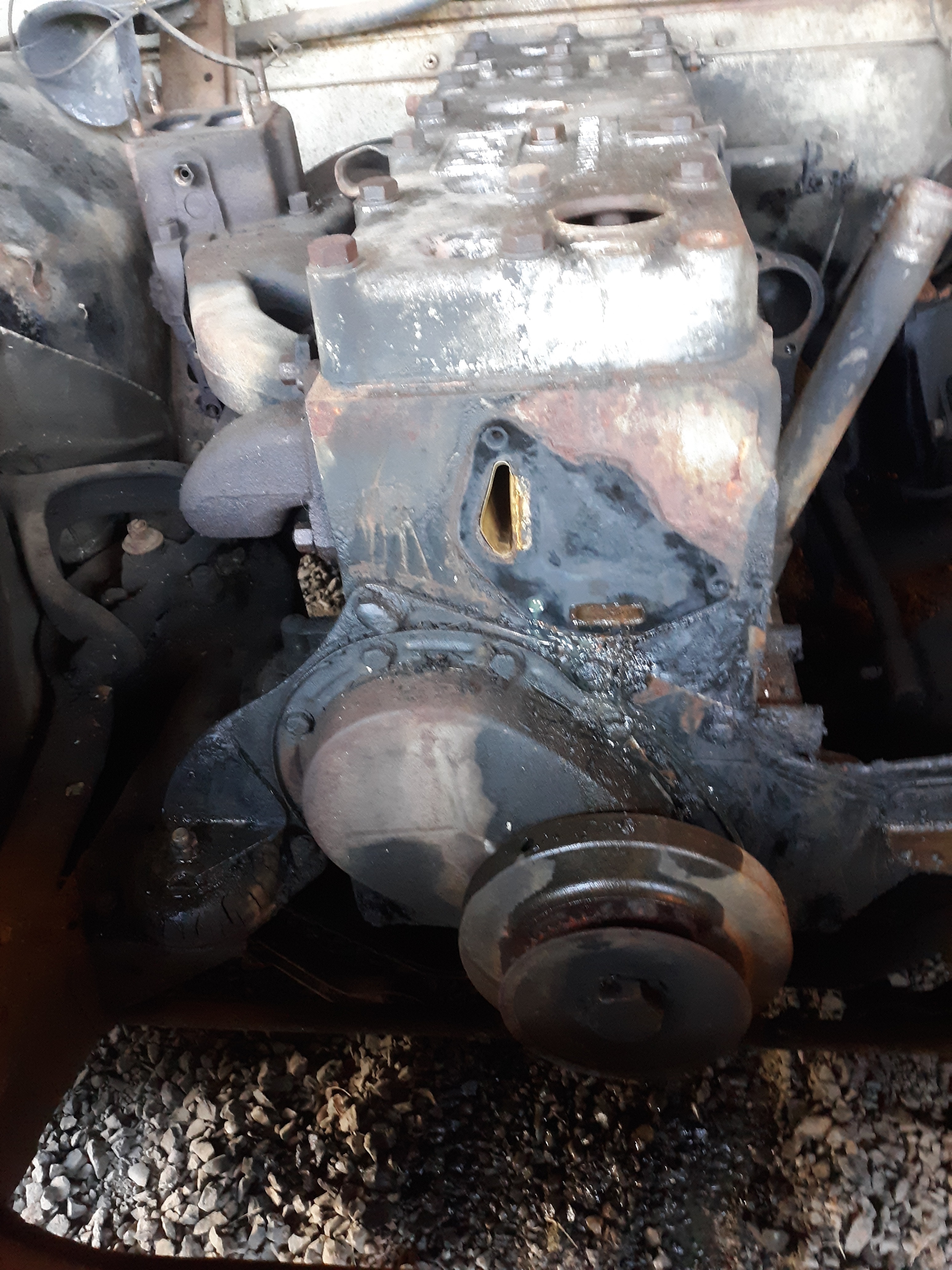

When I pulled the water pump, coolant came out of the bottom bolt hole. I think that's a good sign. But the water pump (like the crank pulley) was froze solid.

Pulled the head off to take a look at the pistons and the valves. 5 of the 6 cylinders left black, sooty deposits on the bottom of the head, with the exception of one. It's kinda speckled gray and white. Not sure what that means.
No. All 6 piston tops had carbon caked on them (pretty thick, 1/16 inch). As I loosened the head bolts, the head started to move around. It wasn't sealed very well. I've got at least one spark plug port that has the threads stripped out. I think switching to the iron head is a good idea, if I can find one! TY
