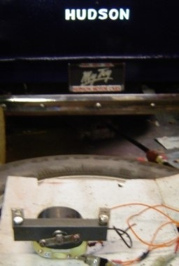

Ive done '37's and 47's. Just Goggle Universal Wiper Motors either 6 or 12V. Remove spring Clip & Arm from Vac Mtr, then put a short piece 1/8 angle, drill 3 holes then attach across the orig wiper mount holes. Need to cut & shorten the Electric Mtr then attach the Vacume Mtr Arm. They now have two Spd Mtrs and could wire to an Intermitten switch. One Unit I bent a tiny rod up to the Orig Switch. Its late, so find & post pic tomorrow.

Attached Universal Wiper Motor using your Hudson Link. About $50. if your handy takes a few hrs. I ran a rod from the wiper motor up to my '37 switch, on the other I installed a modern dash switch. The Newport is probably better since ready to install. I installed a CD/FM Radio that's small so unsure if stock radio clears.
