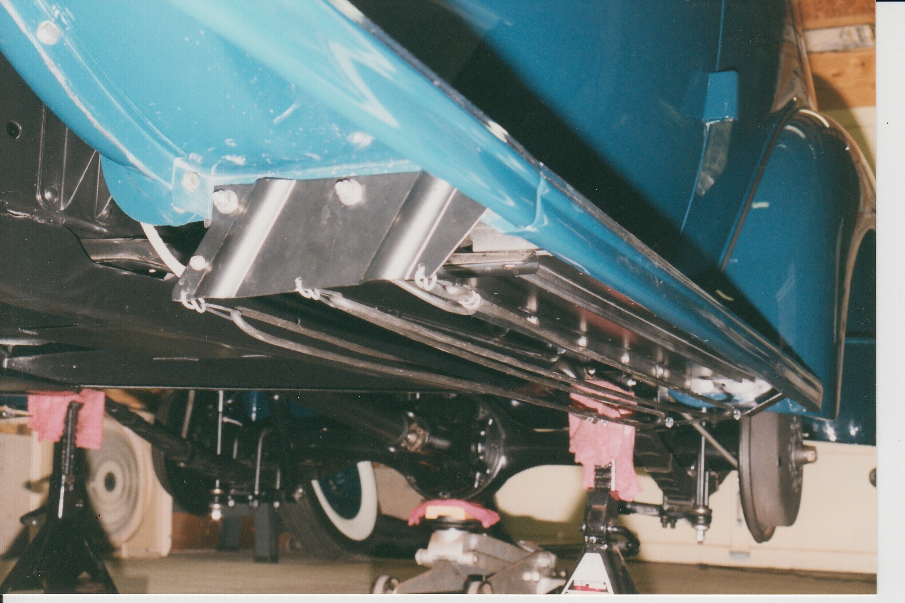

i have the original under running board radio antenna complete in amazing condition which side does it mount to ? guessing drivers side but not sure. thank you
Hi Paul it goes under the drivers side running board there should be some clips that hang down from the running board at each end that the antenna hooks on to I have seen cars with one under each running board for more range with the AM radio.0
I would expect a Country Club to have the radio with antenna under both running boards. I rebuilt one many years ago on a'36.

There was a fair bit of the original wire under the car, especially the crossover from left to right. (As I recall, there was a splice at the center underneath). The best match I found (and used) is thirties/forties black spark plug wire. It looked identical to the original. I think it's still available in bulk from a Ford restoration source.
