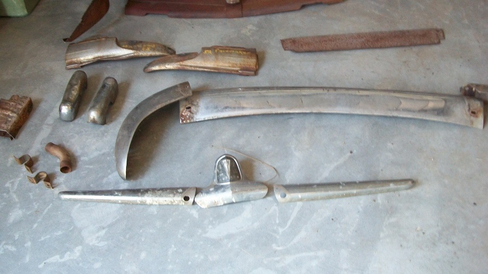

I got this in Nebraska. I think it's what you are looking for Bro. It is in front of the U-clamps that are for the front sway bar.
