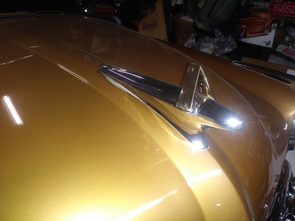

Its not Gold but looks like it...I dont recall how much it cost. I will Post the picture probably tomorrow...0
51 Hood Gold ornament but pictutre does not do justice. Difficult to get true color under lights...0
